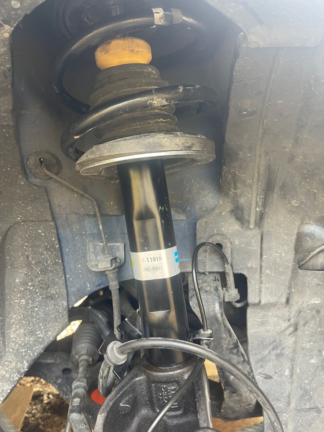

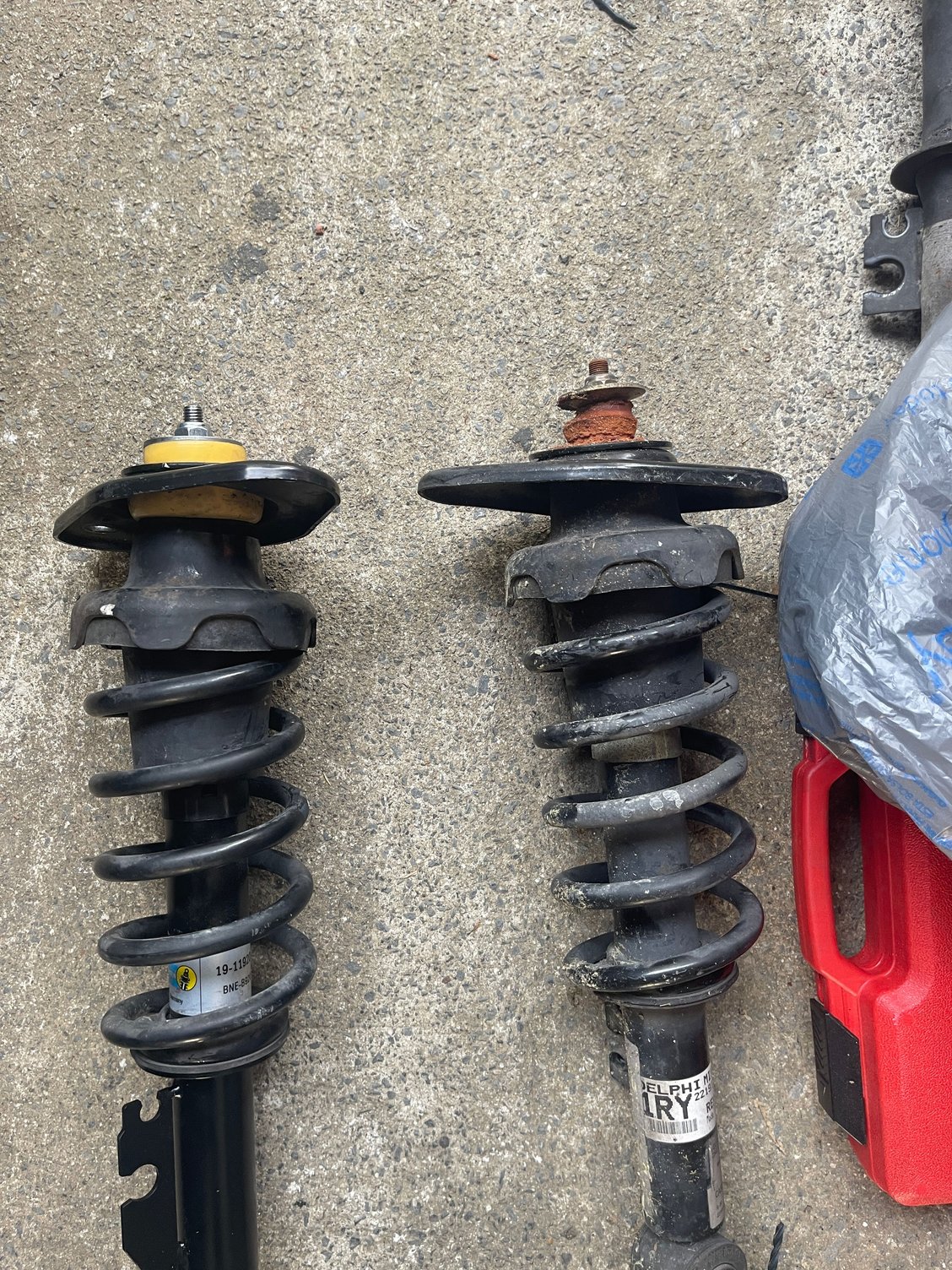

I should have the rest of the parts to do the front struts this afternoon, they say out for delivery. Looks like I won't get the bushings for the backs till tomorrow.

I installed my new front emblem while I waited for the mail lady. I have the front struts done and the bushings for the rear should be delivered today.

The new struts are installed all the way around on the Mini!
