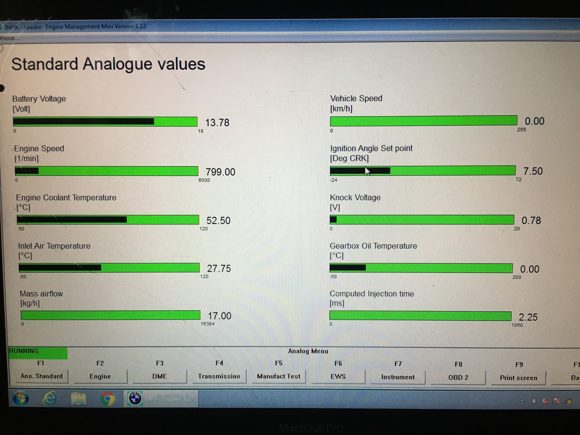

Hi all, have a 2005 r53, recently started to die when coming off throttle, like when stopping at a traffic light.
It happens mostly when the engine is cold and less (or not at all) after warm.
also, a bit further back, it has started to yo-yo slightly when steady on throttle (or when not going harder on throttle). Almost feels like hesitation but goes away with more throttle. Not sure that’s related.

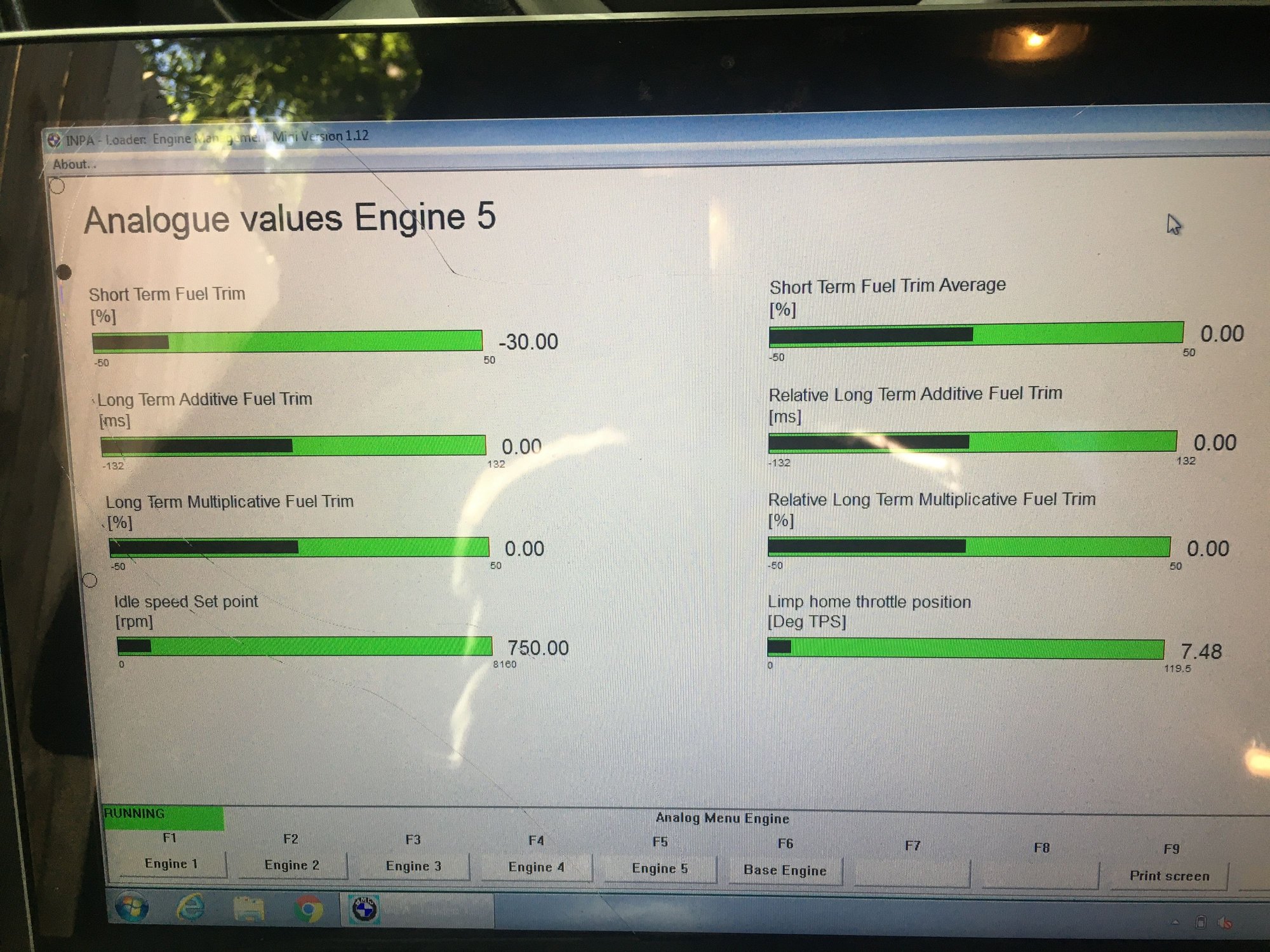

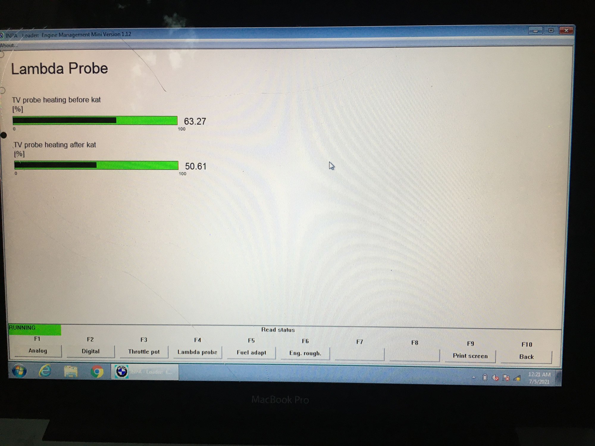

Got some screenshots from inpa (will post below)
Hoping someone has seen this before for a fix

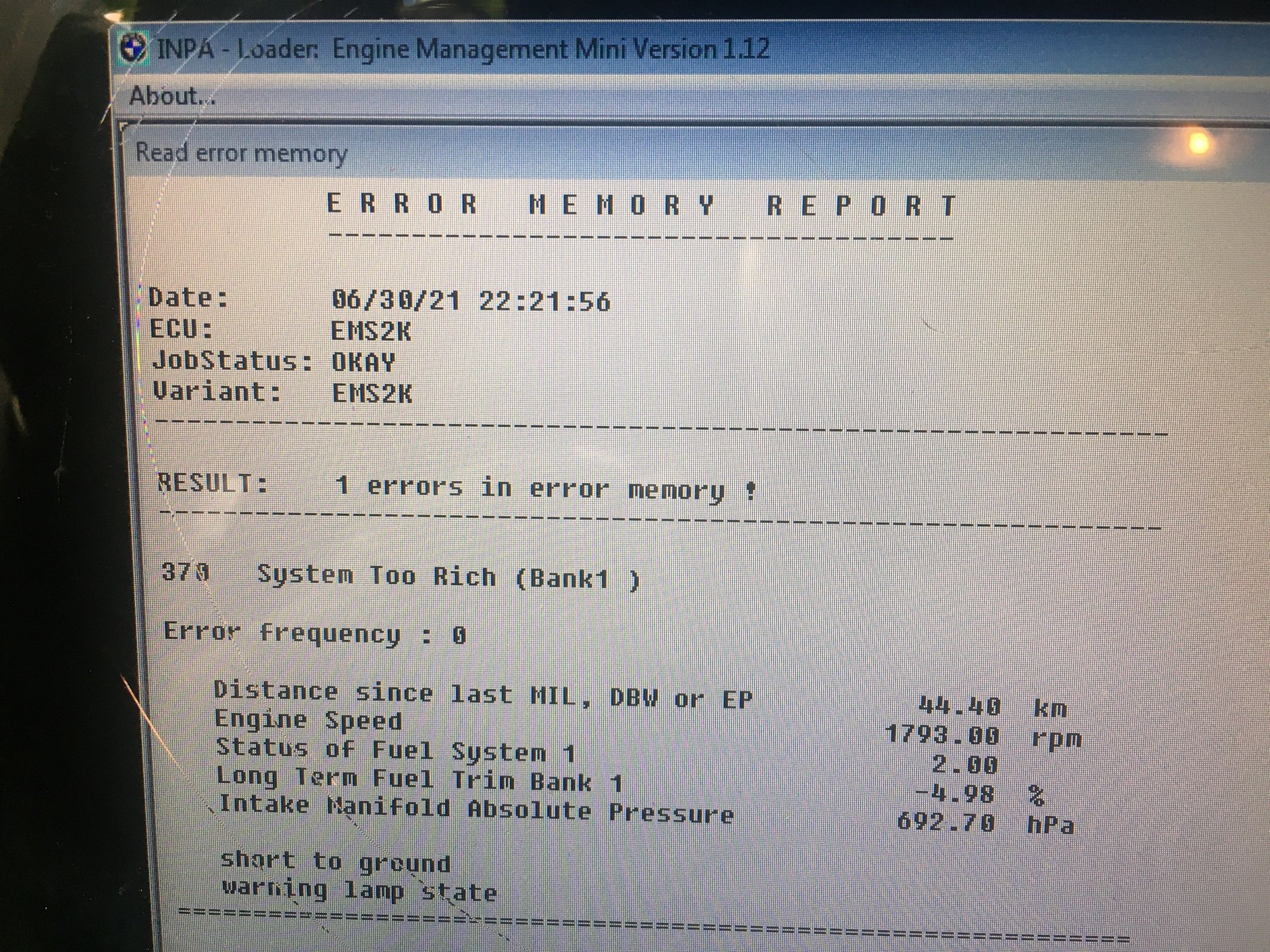

370 system too rich

Short term fuel trims -30?

Yeah, you're running rich.
Check your fuel pressure, a bad regulator can make it go too high and cause a rich condition

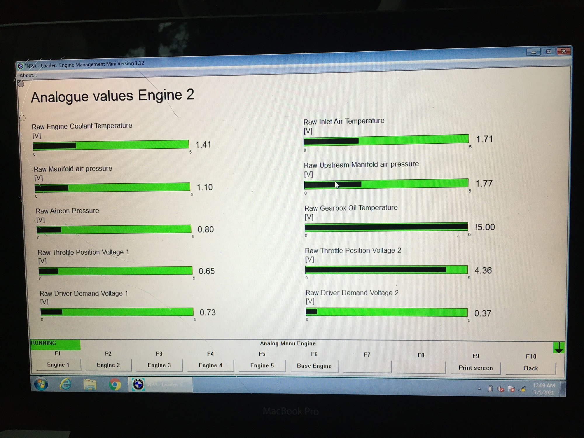

See if you can pull up the readings from both MAP sensors (yes,there's two!) in INPA with the engine idling; I'm curious to see.

thank you for the reply mrbean. I will look for map sensor readings in inpa and get a snap, post back here.

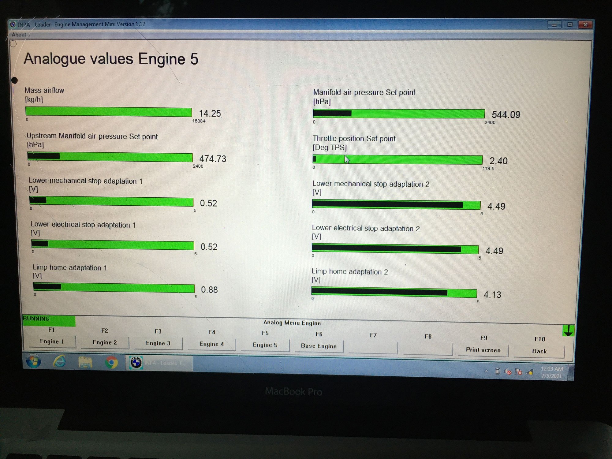

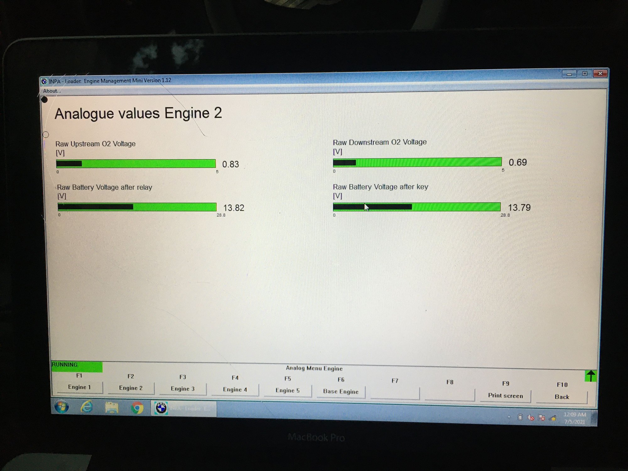

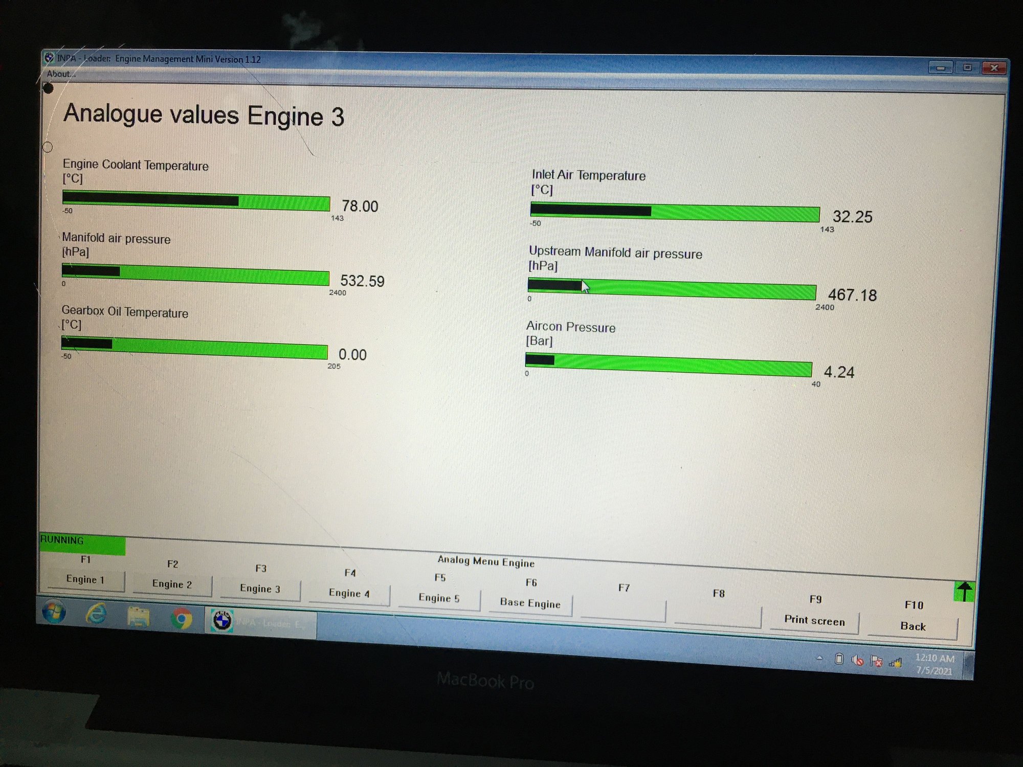

Old Jul 5, 2021 | 09:40 AM
ssoliman's Avatar
ssoliman
Joined: Feb 2018
Posts: 1,736
Likes: 329

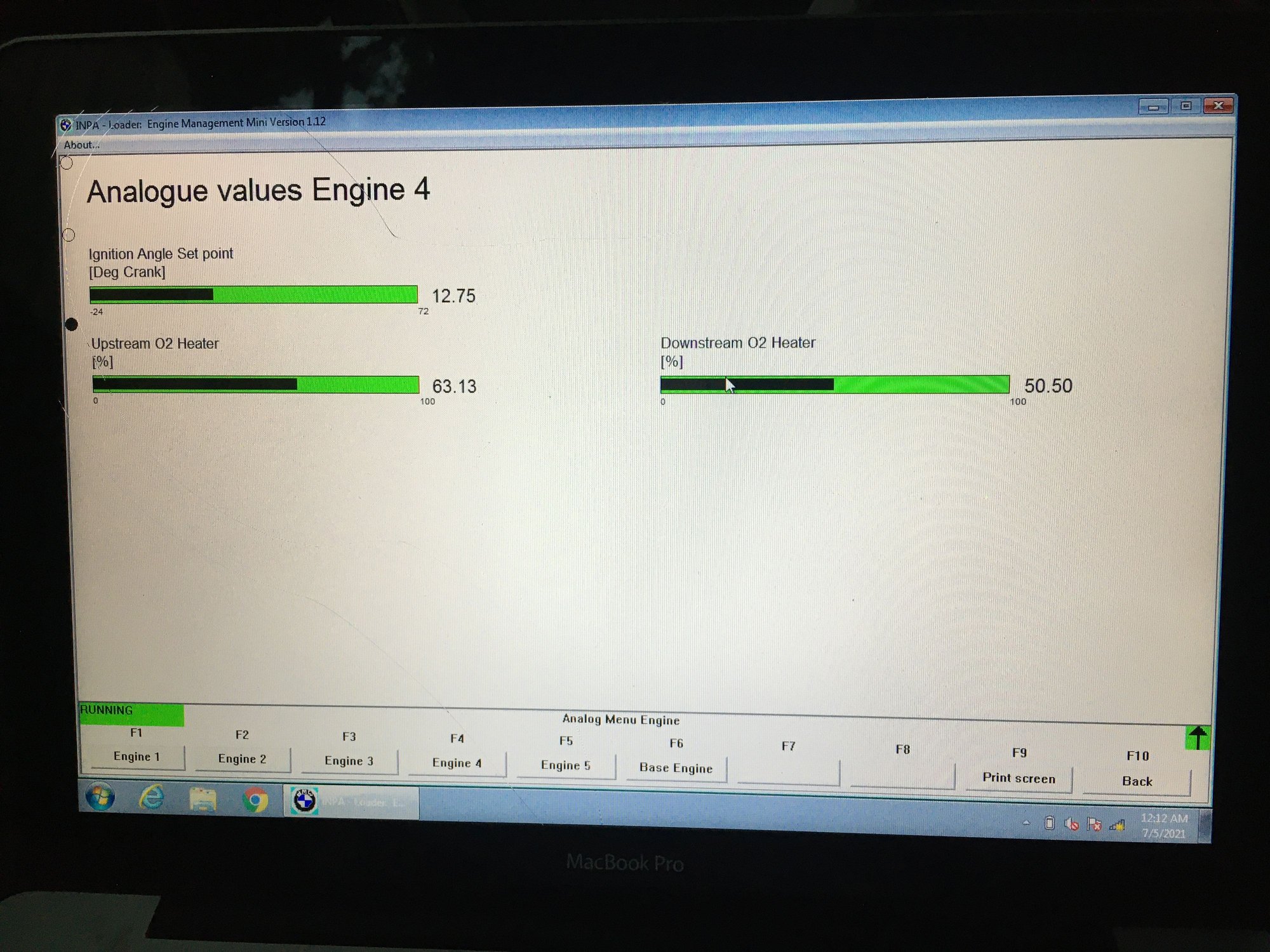

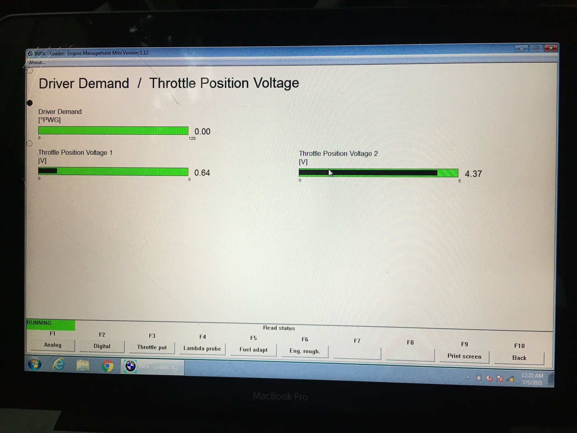

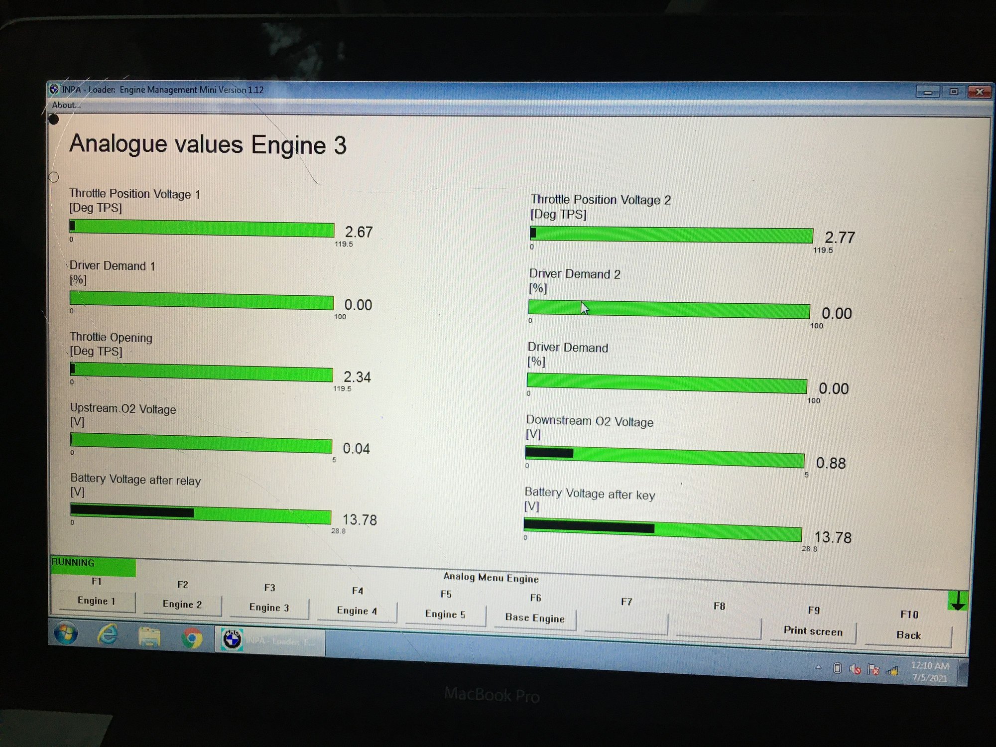

ok some additional data, all while at idle

I noticed that when coming off throttle the short term fuel trims go down to zero, but then right back up after reaching idle.
also from this sticky in the “stock problems/issues” section, seems this has been an issue that is fairly common. I went through the thread but did not see a resolution.
https://www.northamericanmotoring.co...-starting.html
Old Jul 5, 2021 | 11:38 AM
mrbean's Avatar
mrbean
Joined: Aug 2003
Posts: 839
Likes: 225
Those readings seem normal.
When you come off the throttle the DME cuts off the injectors which is why you see fuel trims go to zero.
I would check fuel pressure next.

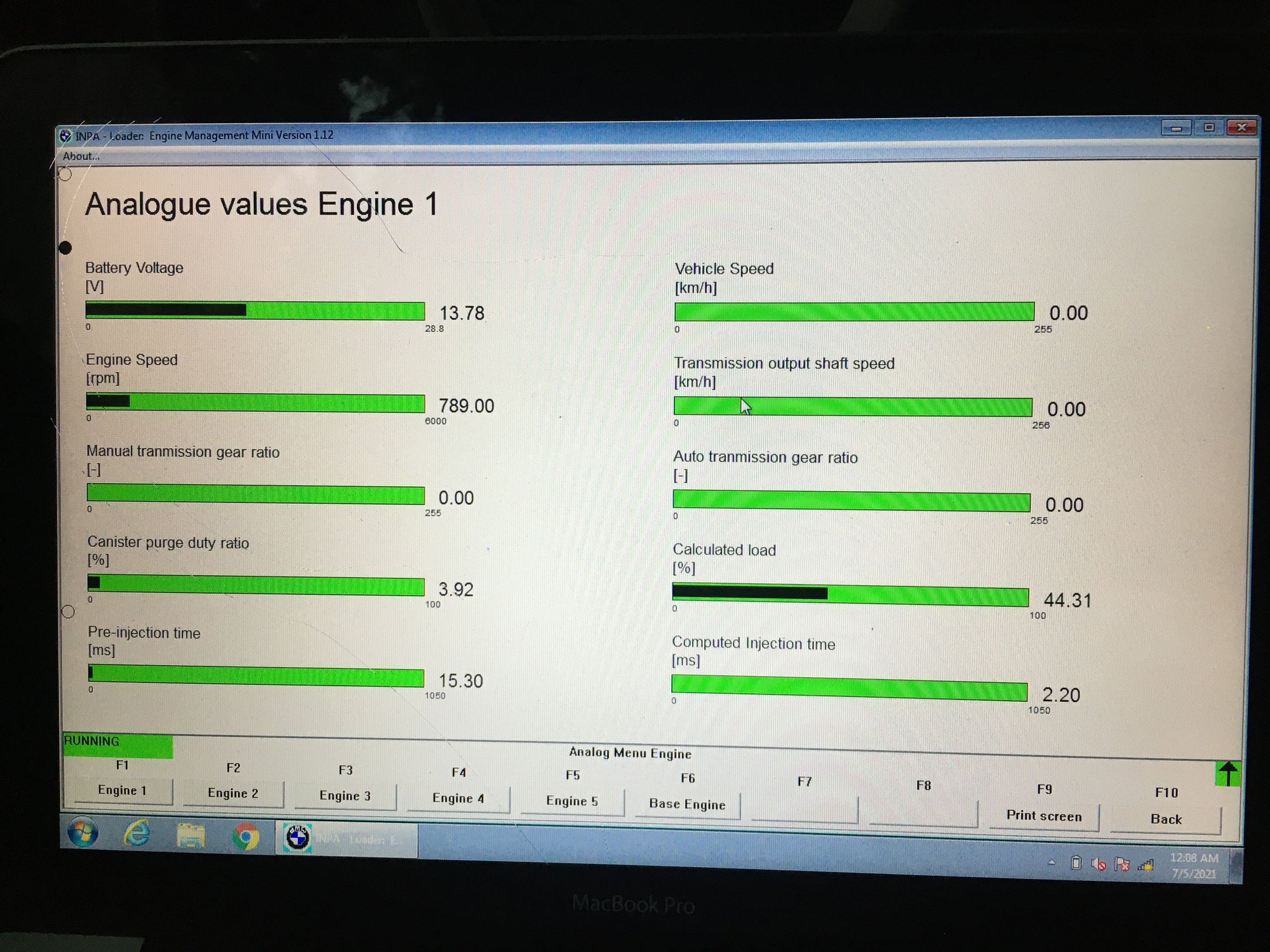

Old Jul 21, 2021 | 07:08 PM
ssoliman's Avatar
ssoliman
Joined: Feb 2018
Posts: 1,736
Likes: 329

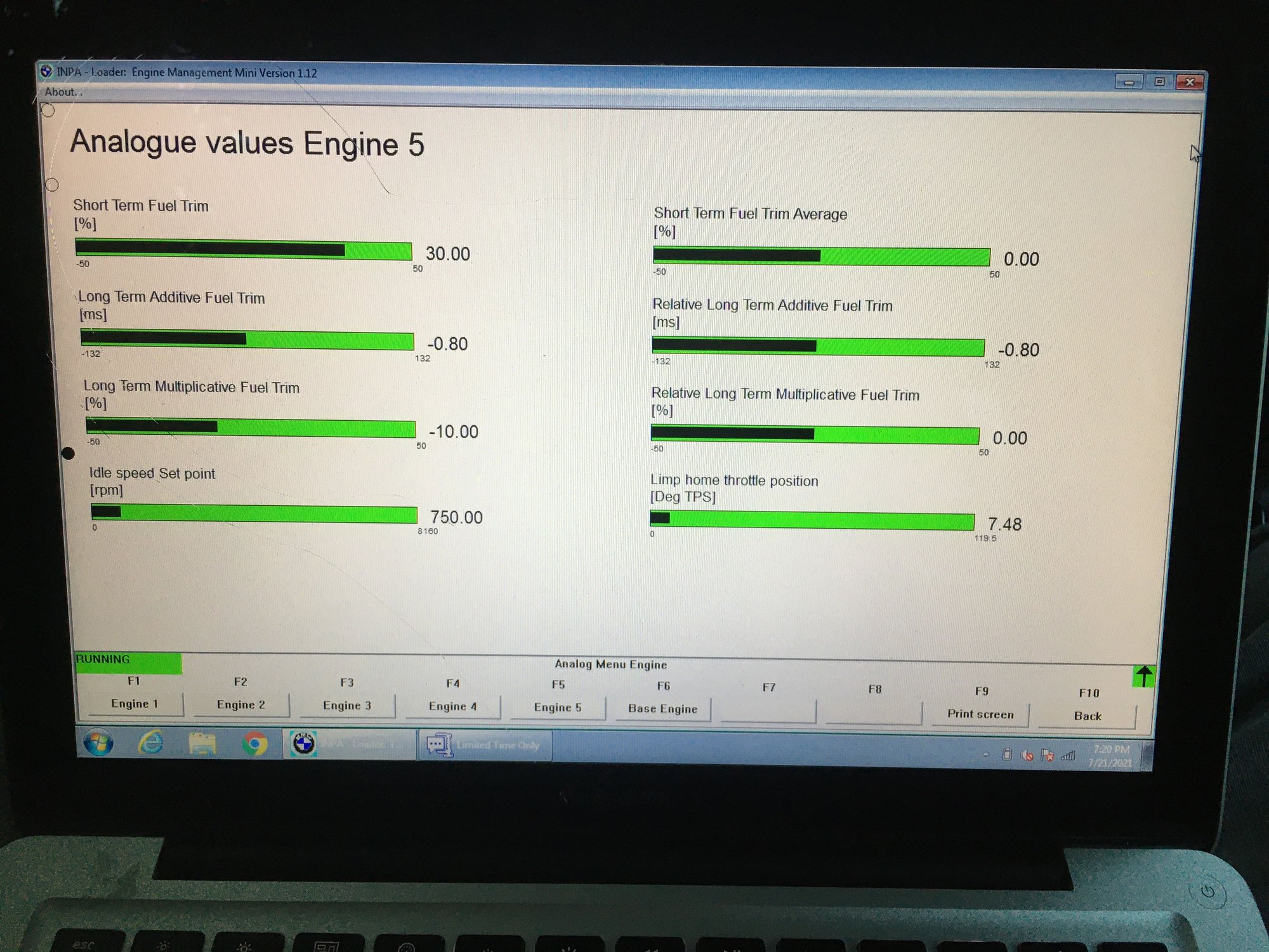

Hold the phone, on the way home today, my pops and bangs were back. And it held idle. No stalling.
I took a quick look at fuel trims. Short-term was +30 again. Long-term multiplicative was -10. Don't know what that means. Seems strange to me that they would be opposite like that (attached pic).
Last, im seeing a new error code.
1089 Evaporative Emission Control System Incorrect Purge Flow (attached pic)

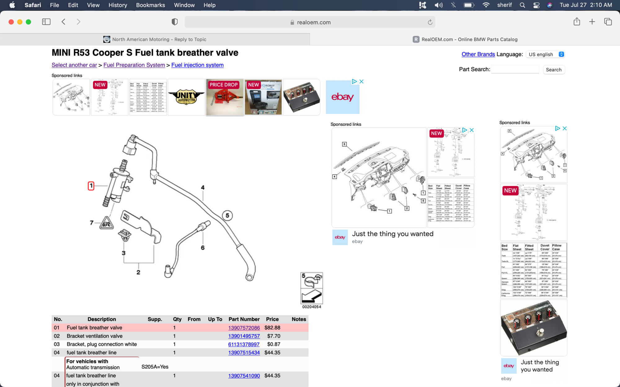

Apparently the code above is caused by a bad purge valve or "fuel tank breather value" as bmw calls it. #1 in the pic attached.
This part is $80 plus for OE. However its a common valve in may cars and I found a thread where it can be purchased for much cheaper...
This would be my second time replacing this valve tho. Maybe the OEM valve is not a good?
But the real question, could this purge value be causing my rich condition?

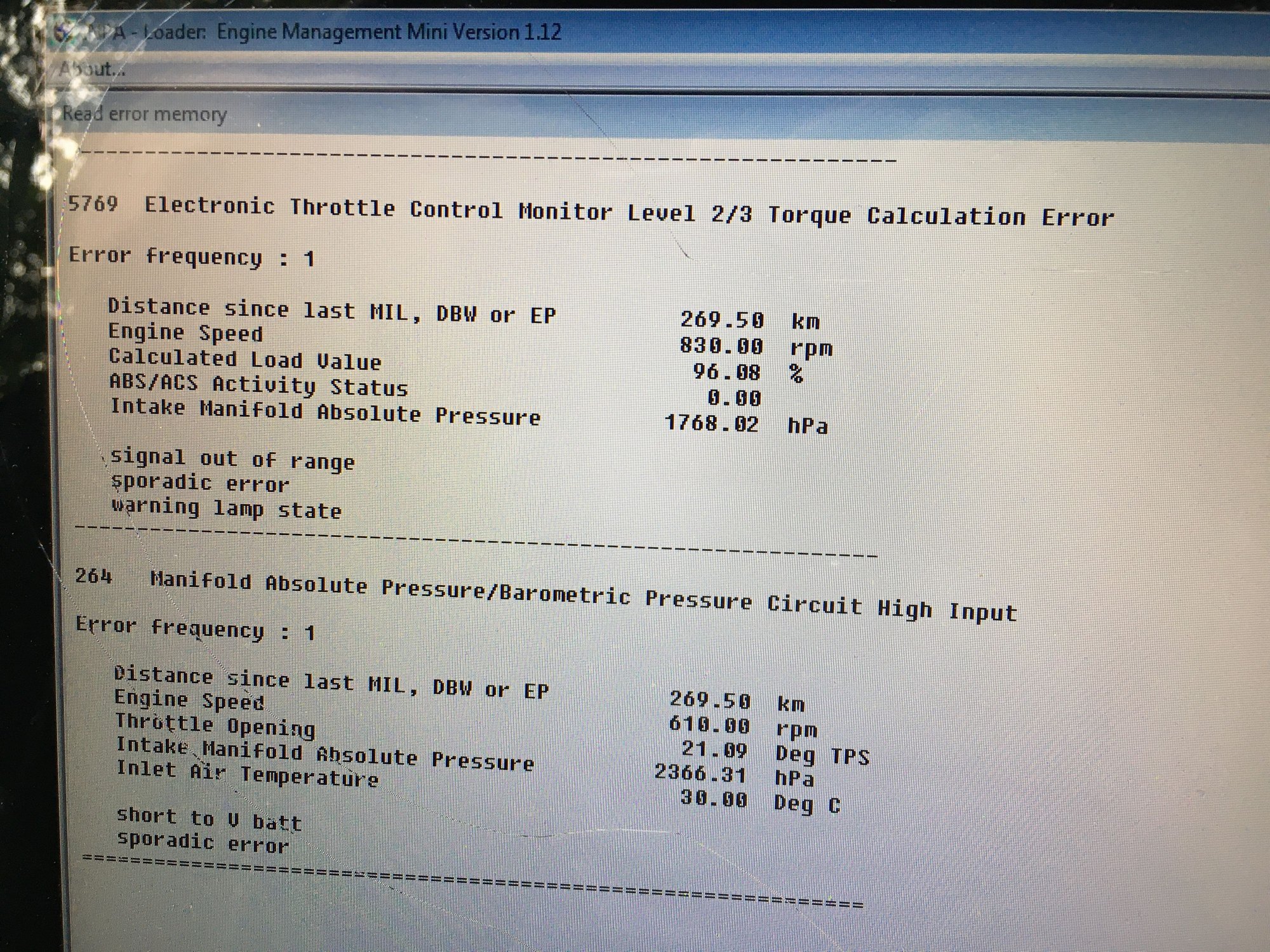

Still waiting on parts however the drama continues...
The other day I started it for work and it idled very rough then died. Tried again same thing. Tried again, and realized it was in limp mode. RPM would not go over 2k iirc.
So I took the kiddo's r50 to work. When I got home I pulled codes. I'll post them below. Cleared adaptations, and all returned to normal.
Old Aug 12, 2021 | 06:16 PM
ssoliman's Avatar
ssoliman
Joined: Feb 2018
Posts: 1,736
Likes: 329
5769 Electronic Throttle Control Monitor Level 2/3 Torque Calculation Error
264 Manifold Absolute Pressure / Barometric Pressure Circuit High Input
Old Aug 13, 2021 | 01:33 PM
BlwnAway's Avatar
BlwnAway
Joined: Nov 2004
Posts: 2,607
Likes: 316
From: Arnold, MO.
Originally Posted by ssoliman
I feel like this could be the t-map sensor also...now I'm just guessing
More often than not, this is the culprit.
They get fouled from heat and oil residue in the intake.
Sounds like yours is on its way out, just not quite there yet.
