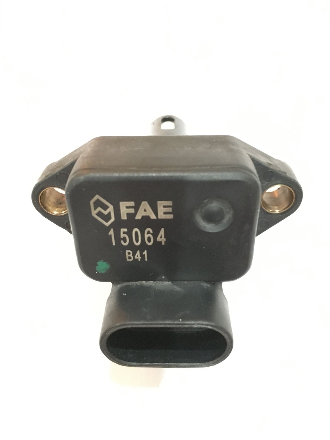

T-map sensor replaced, cleaned the plug with electrical cleaner. Purring like a cat. Fuel trims are dead on. Pops and bangs are back. No codes.
going to return the purge valve.

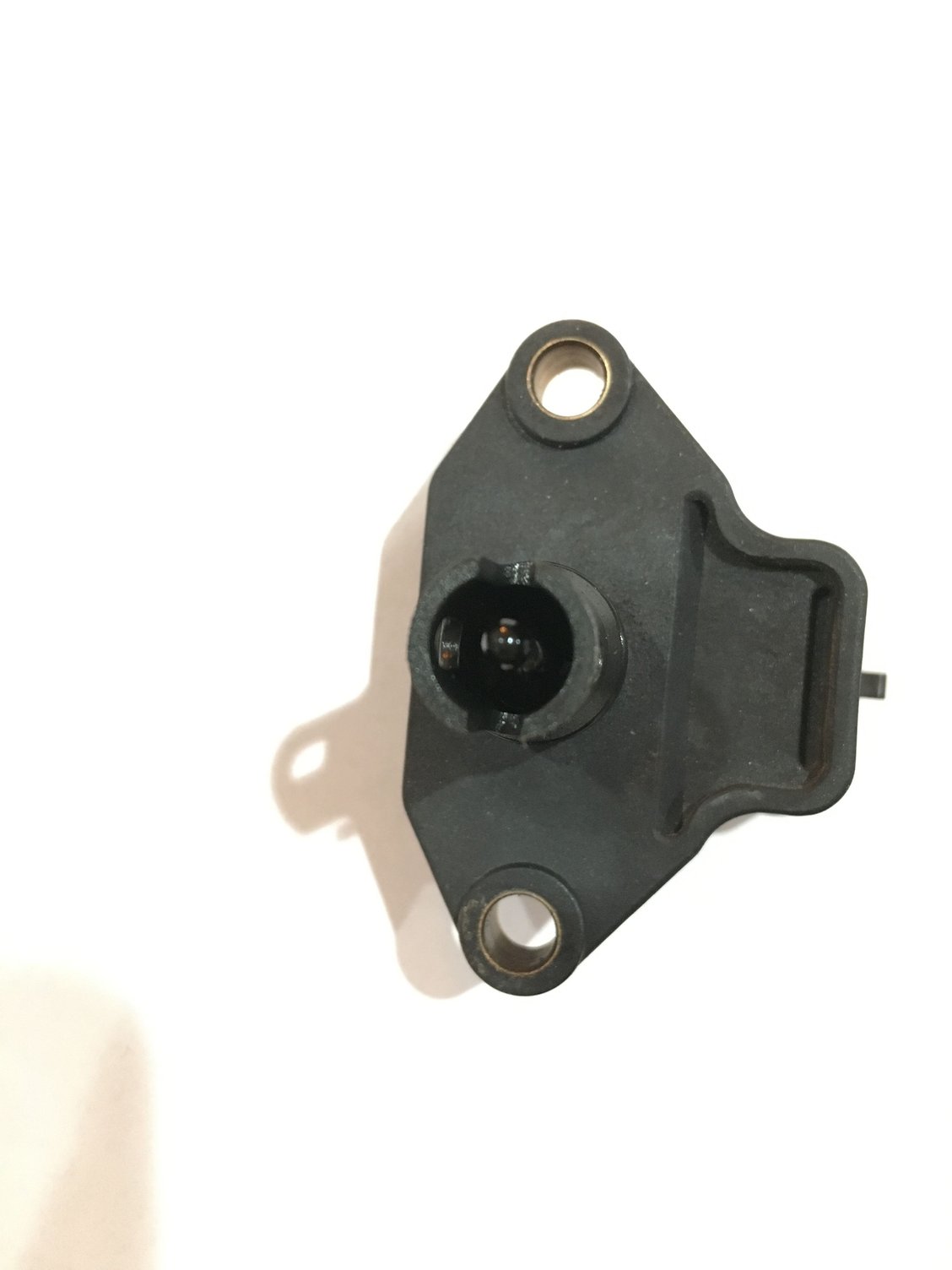

Here’s a pic of the old sensor. Look OE to y’all?

No, FAE is an aftermarket brand afaik. OE has different stamps on them. I can take pics if you really want to know
The new sensor should be OE. I’ll get a pic and lets see if it matches what you have.

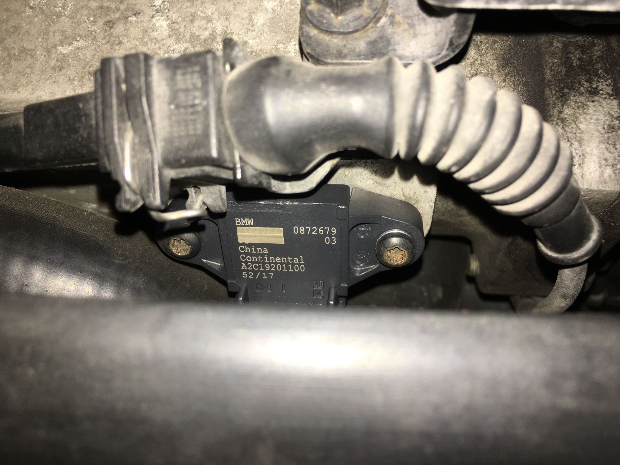

I had 2 of these on my 2006 R53
thank you, should be able to get a snap of mine later today

Kinda the same

Actually my old one looks more like the shape of yours

Could be differences in facelift/prefacelift and/or continent

Maybe. I’ve sent the question over to fcpeuro. I’ll get back with there reply.
I purchased genuine mini OE

Fcpeuro got back. They say “continental” is the new OE provider.
anyone buy genuine t-map sensor lately that can confirm?
