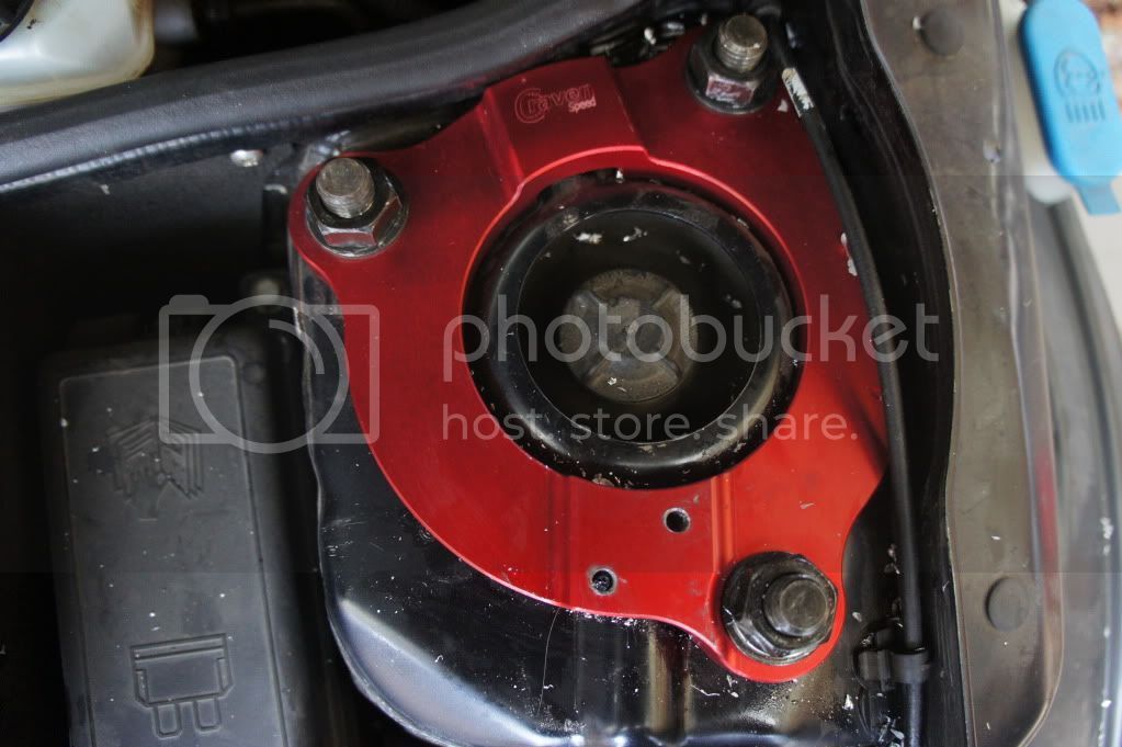

Not bad in any way and I have defender plates (cravenspeed) installed
