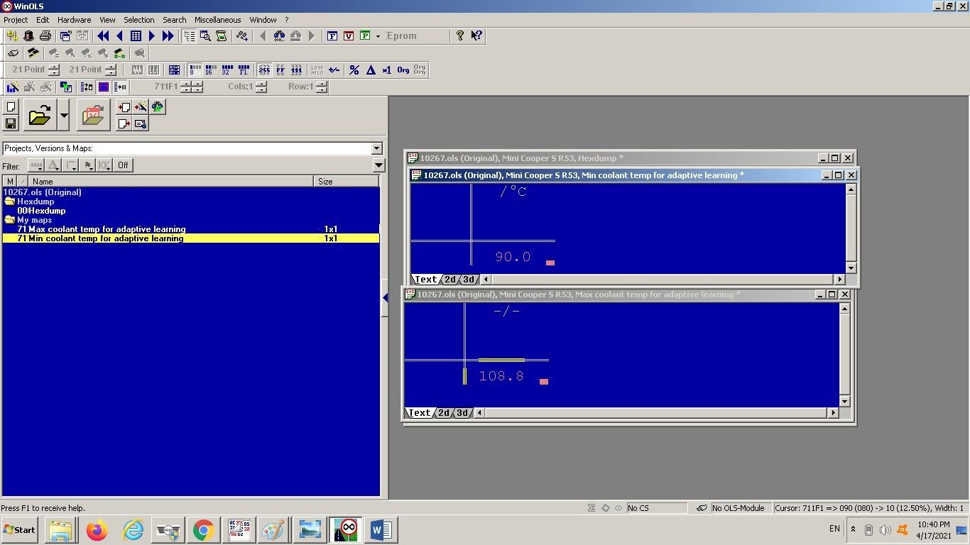

Old Apr 17, 2021 | 12:45 PM
adriancl's Avatar
adriancl
Joined: Apr 2013
Posts: 334
Likes: 186
From: Romania
Minim coolant temp for adaptive learning can be changed for any value .Picture show both values , min and max temp.Because is european car values are in °C.
