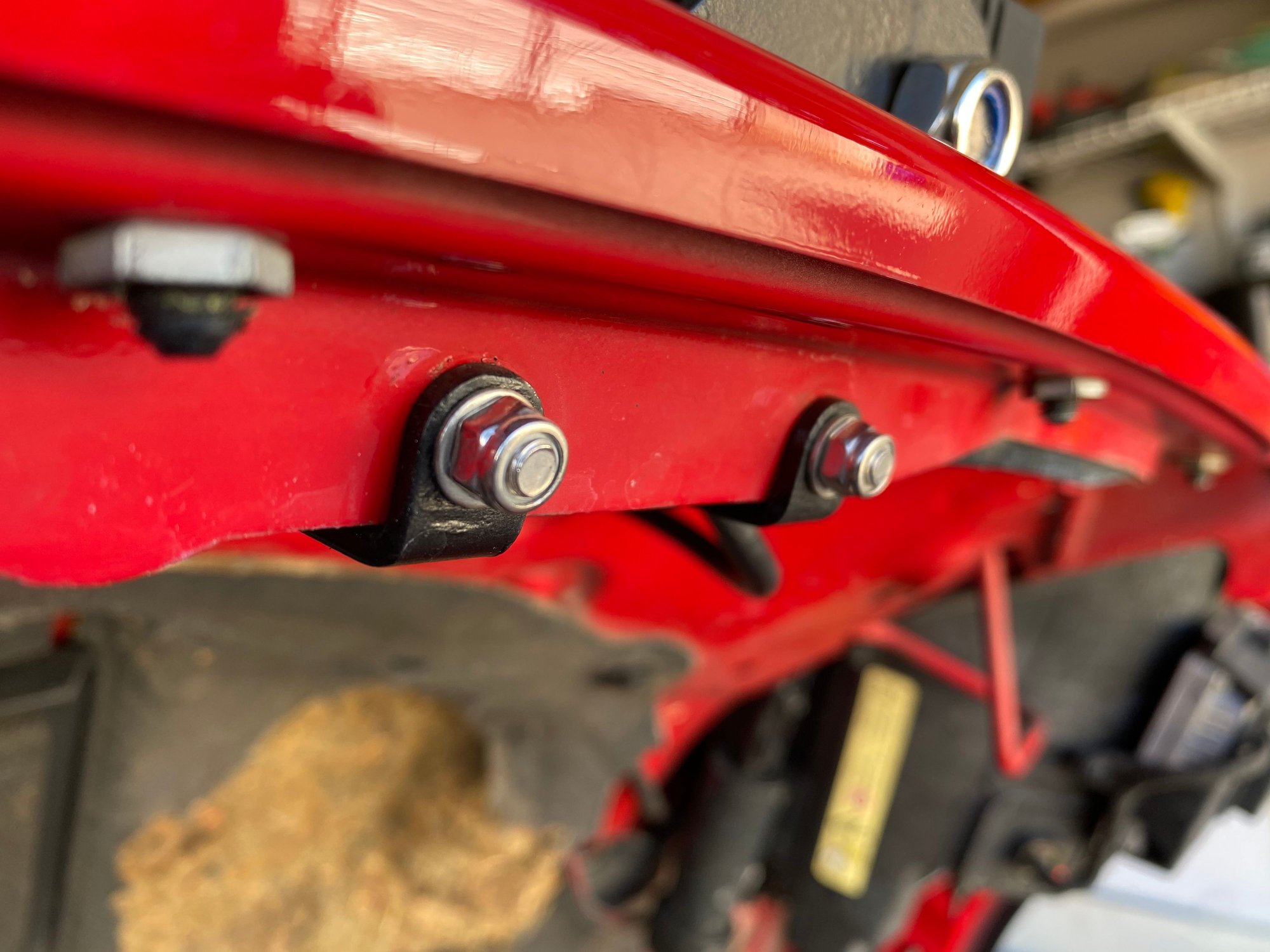

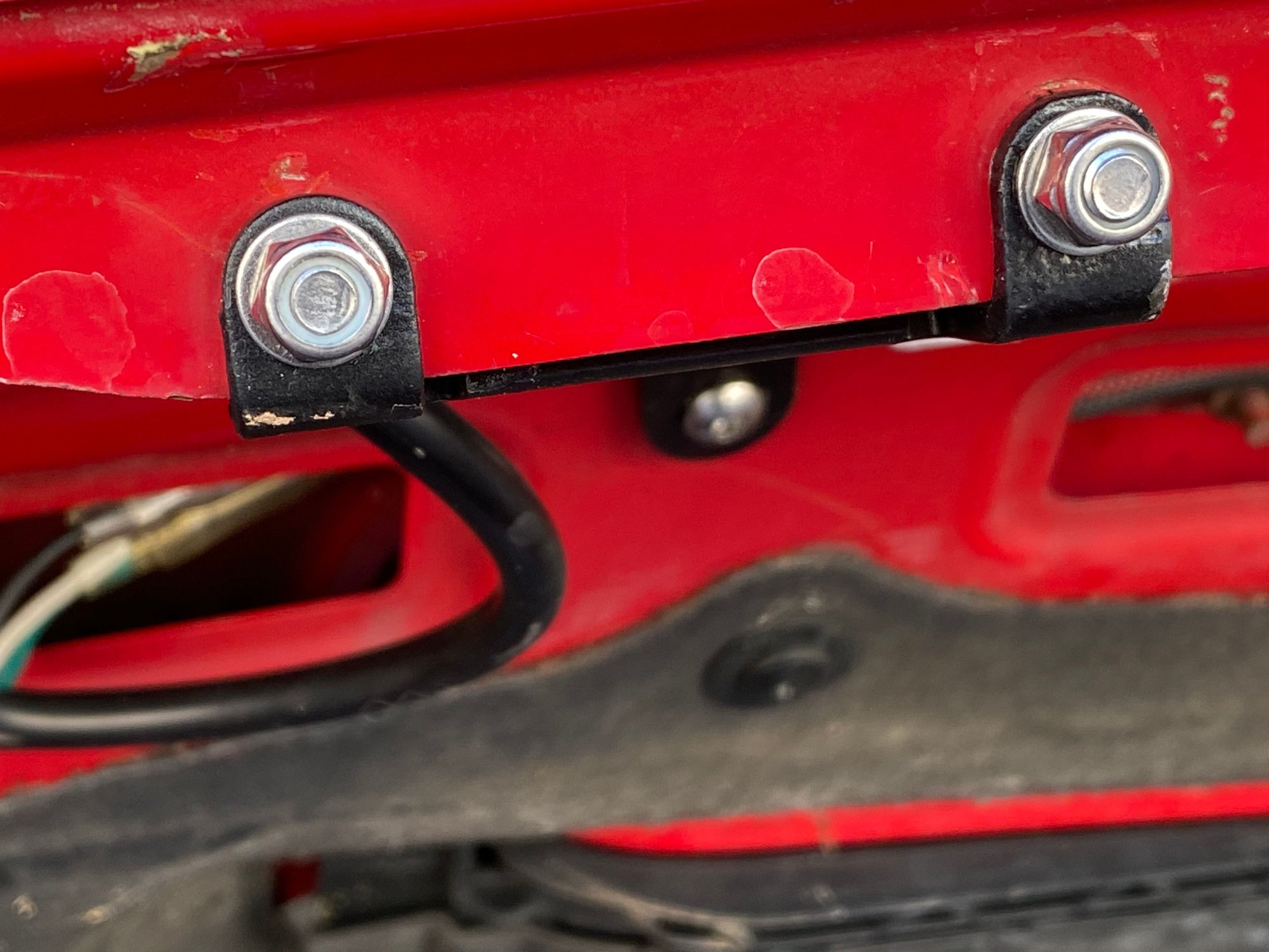

The OEM instructions call for rivets. I plan to use nuts and bolts when I finally get around to installing mine.

Stainless steel button head cap screws with washers and nylock nuts.
Rivets will eventually loosen with vibration, as will the bolts. But bolts can be retightened.

I used nuts and bolts on mine

Thanks guys, I got some pictures from the Facebook group.... I'm going with bolt's and nuts as well
Bryan

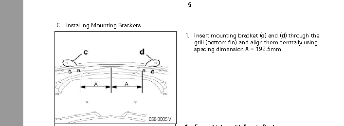

https://www.minimania.com/pdfile/NMA3030_INSTR.zip
Old Mar 13, 2021 | 03:39 PM
A383Wing's Avatar
A383Wing
Joined: Sep 2017
Posts: 1,515
Likes: 255
thanks for the PDF instructions.....I don't have the other special bracket they call for if the car has washers and Xenon headlights.....are they really needed?
