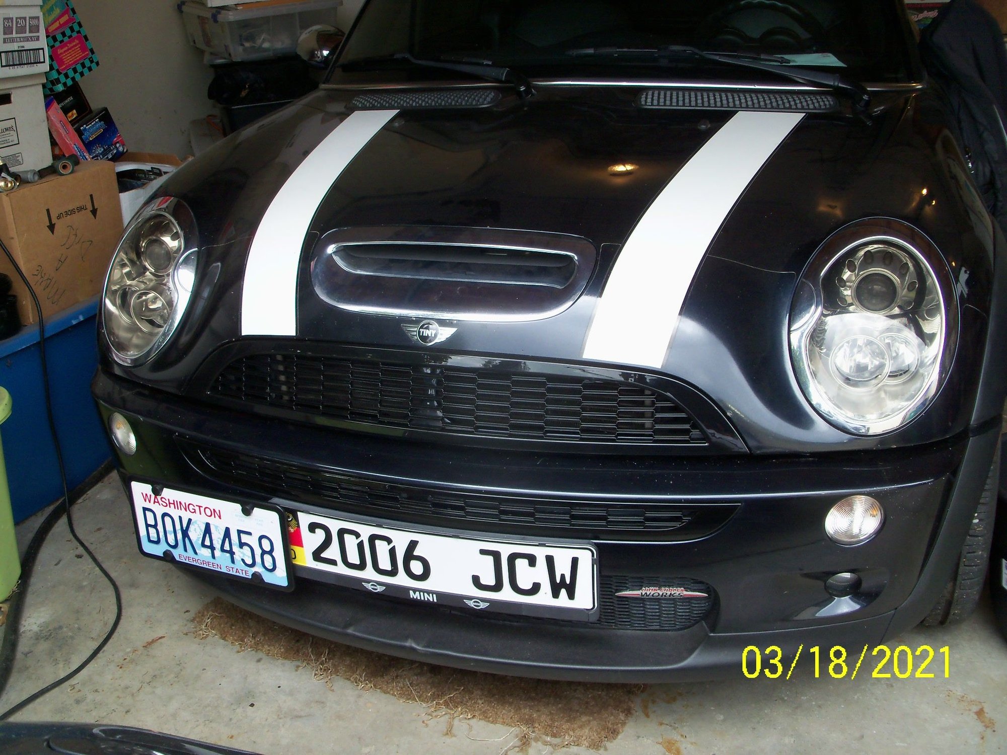

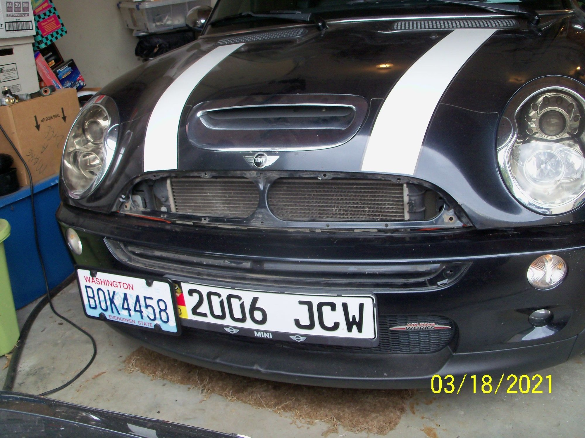

got my new grille and lights installed, now to wire them up....I don't have to find the heavy duty hood struts....the ones I got from eBay are very strong and have no problem with the lights on the end of the hood.
Bryan
