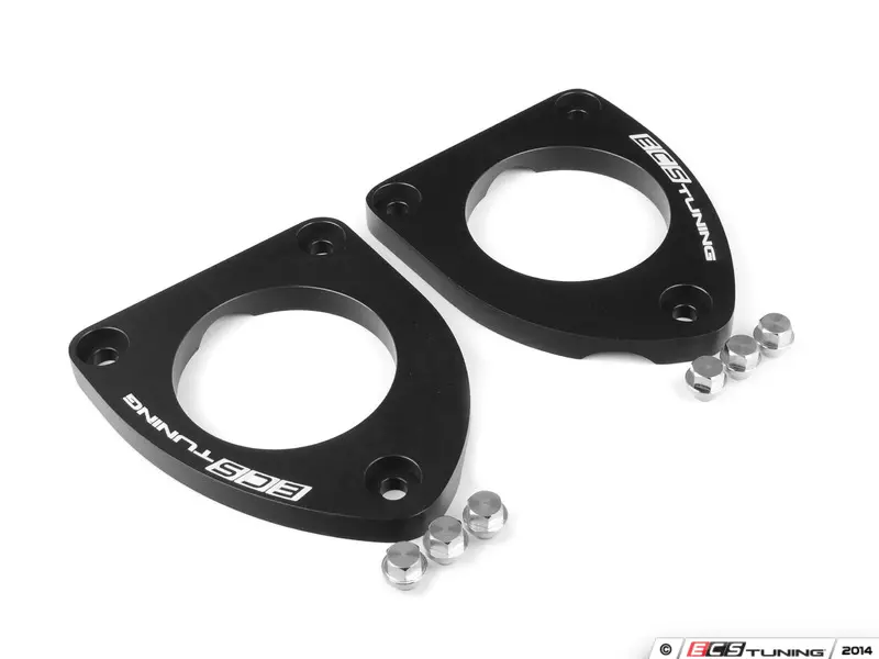

I am running our ECS plates for some time now. Easy to install and has the correct finished nuts. Thats my R52 with them.
https://www.ecstuning.com/b-ecs-part...001717ecs01~a/
Love how they look (contrasting black/orange) on your R52.
What I like best is; the simplicity. Install looks clean and easy.
Glad I caught this older thread in time - I was just about to pull the trigger on the CS variant.
Not that the CS is less desirable...Just too many bits and pieces for my likes..
BTW: It would be nice if you re-did the installation video to cover start to finish. Maybe on a day that didn't call for rain?
Edit: Ooops! - My mistake. It appears someone else (not ECS) created/posted the vid.

BTW: @ECSTuning , do you have a part # for extra nuts for these strut tower plates?
Following
Old Jan 3, 2022 | 12:19 PM
Posts: 36,758
Likes: 2,548
Hello,
https://www.ecstuning.com/b-ecs-part.../001717ecs03a/ we only have a couple of them in right now as they other were consumed in our built kits on shelf.
Thanks for the support
Old Jan 3, 2022 | 12:53 PM
Here2Go's Avatar
Here2Go
NAM Community Team
Joined: Jul 2021
Posts: 2,536
Likes: 1,611
From: Anywhere but here
Thanks!!!
Any idea how often you stock them??
Old Jan 3, 2022 | 01:24 PM
Posts: 36,758
Likes: 2,548
We have like 9 in stock right now. More on way from the supplier as they have to be machined. Not a standard nut.
