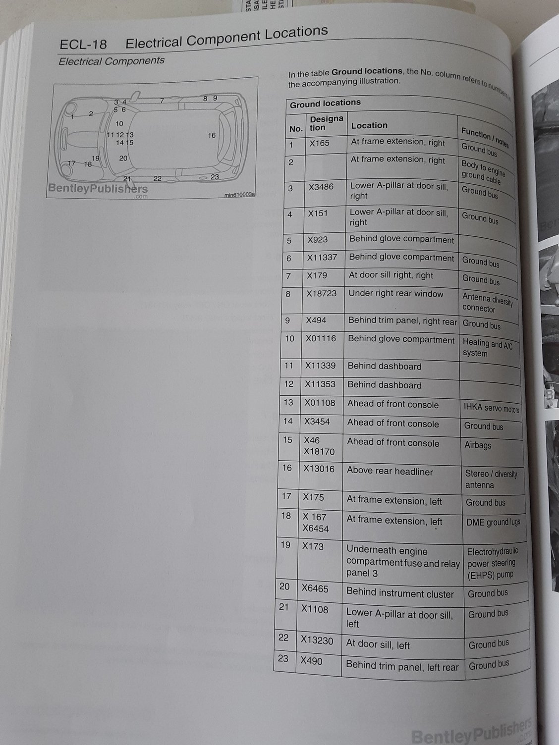

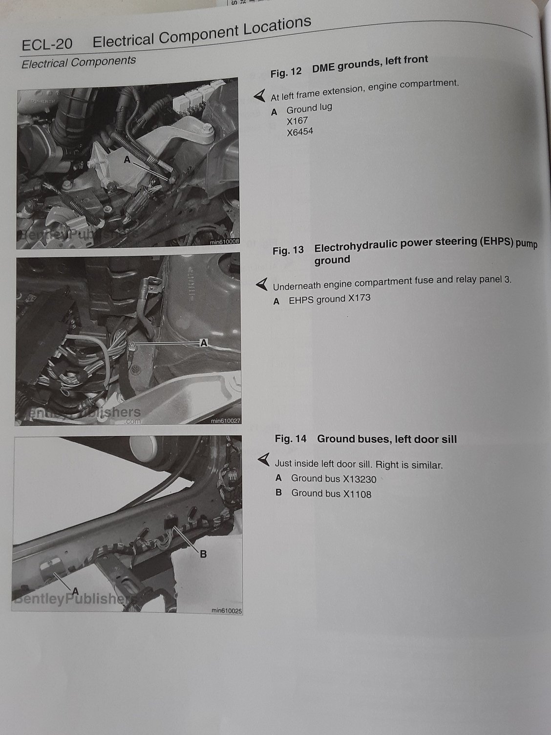

Should have 12.6V battery key off and removed. 13.7-14.2V or so idling and unloaded. No lower than 13V or so with loads on (headlights, AC+blower on high, radio etc) at idle, back to 13.7-14.2 loaded at ~2500rpm.
If you're reading high, >15V you're looking at a bad voltage regulator (integral to the alternator).
If you have a multimeter, check your voltage drops across the positive cable and positive battery post, and again with the negative cable and post. Should be nothing or <0.1V, but you might be surprised to find it isn't. That equals clean your posts and cable ends, and re-install everything tight. Also check all your major ground points. Like Mike says these cars hate-hate-hate low voltage, but they also hate compromised / sketchy grounds. List of them follow:

Thanks a lot for sharing!

Most welcome. Ordinarily I'd provide the N3w-T1s links (we all did) but now that the Right to Repair haters from the Black Forest have yeeted that site and similar ones off the web, all we can do is encourage people to pick up their own copy of
Uncle Bentley Uncle Bentley
and
Uncle Bentley Jr Uncle Bentley Jr
. (yep, they've already doubled in cost boys, get 'em while you can) and meanwhile provide them the pages they need to fix their own cars without getting a$$-r@ped at the Stealership and dirty Indies. I encourage others to do the same.
