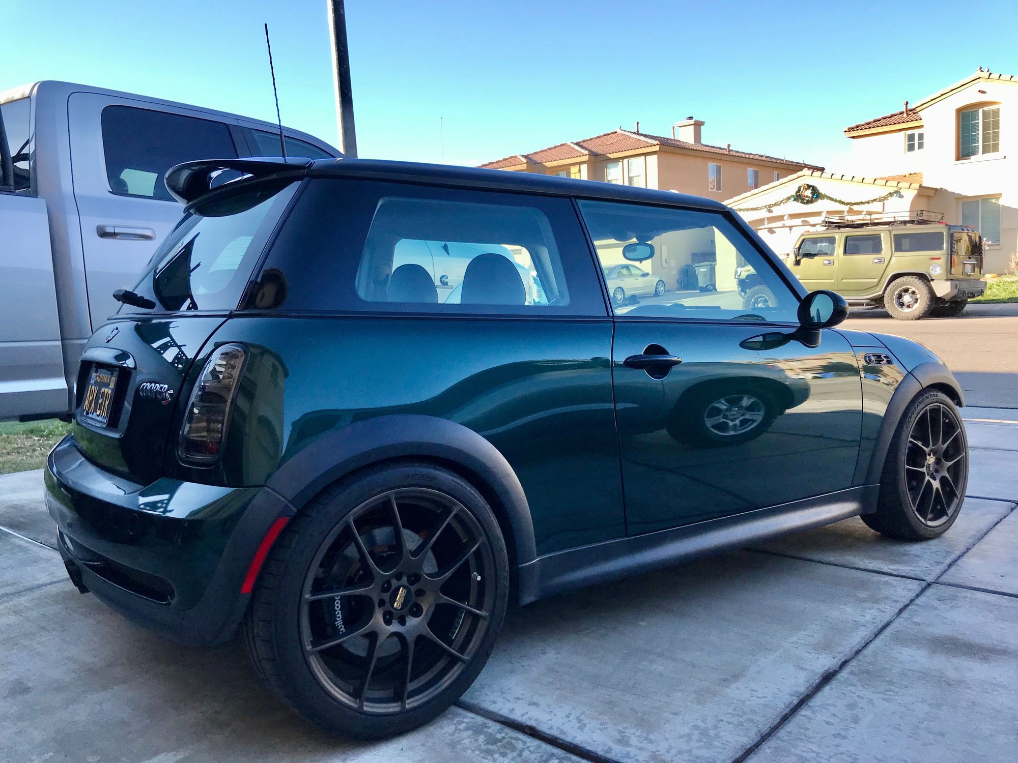

Try to get a wheel you don’t have to use spacers. I’m using spacers to get my wheels where I want them and don’t have a problem with them.
That’s the look I am going for! Love the pic!
