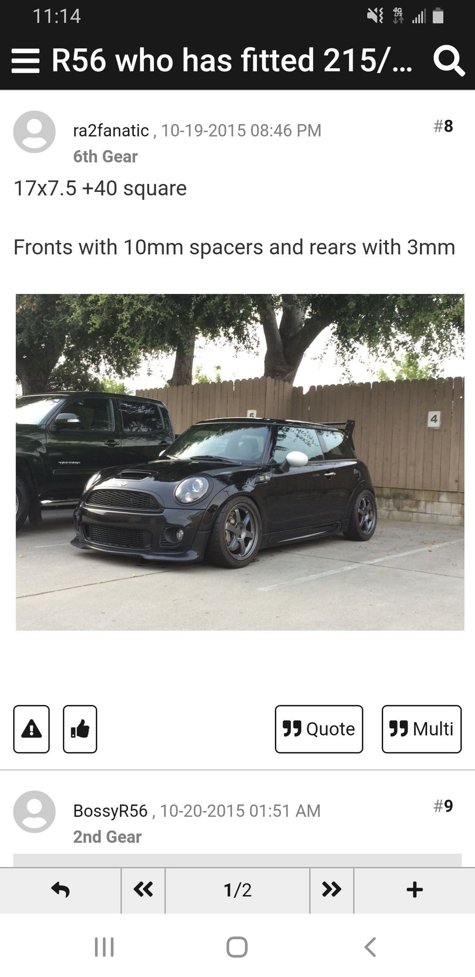

I like the way this car sits. Only difference i think is he has 205 45. I have 215 45.

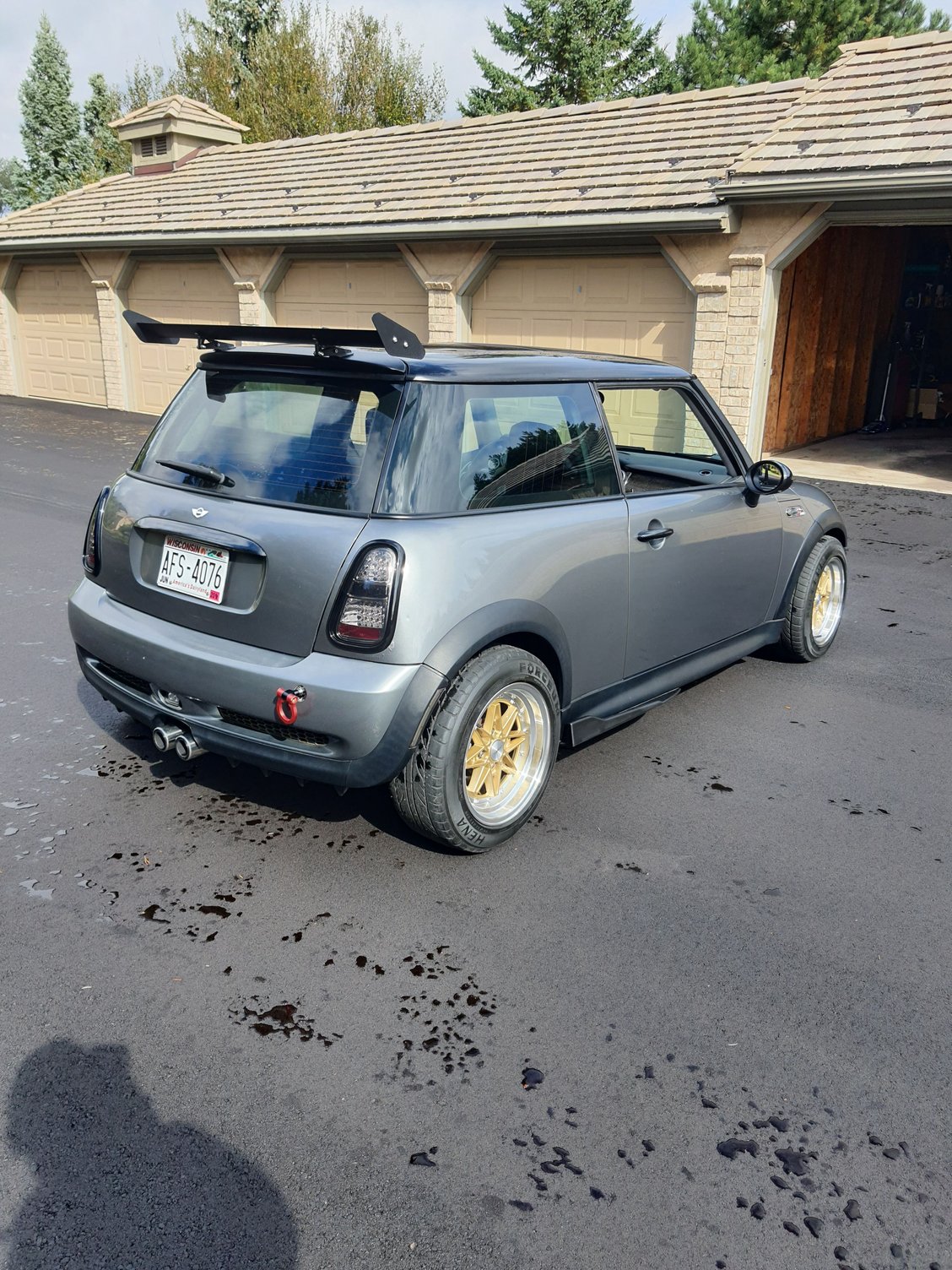

I'm on 15x8 et20 with a 5mm spacer running 205/55r15s and LOVE how it sits even with stock springs..I MIIIIIIIIGHT get coilovers but I don't want to go an inch low which is the minimum drop for any set up.
