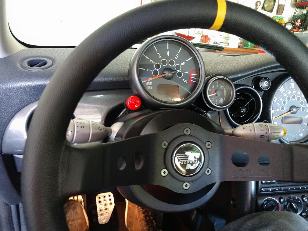

I used the tee from a GlowShift kit when I installed mine.
https://www.glowshiftdirect.com/repl...auge-hose-kit/
This one would work also I would think:
https://www.ecstuning.com/b-new-sout...hoCc8AQAvD_BwE
