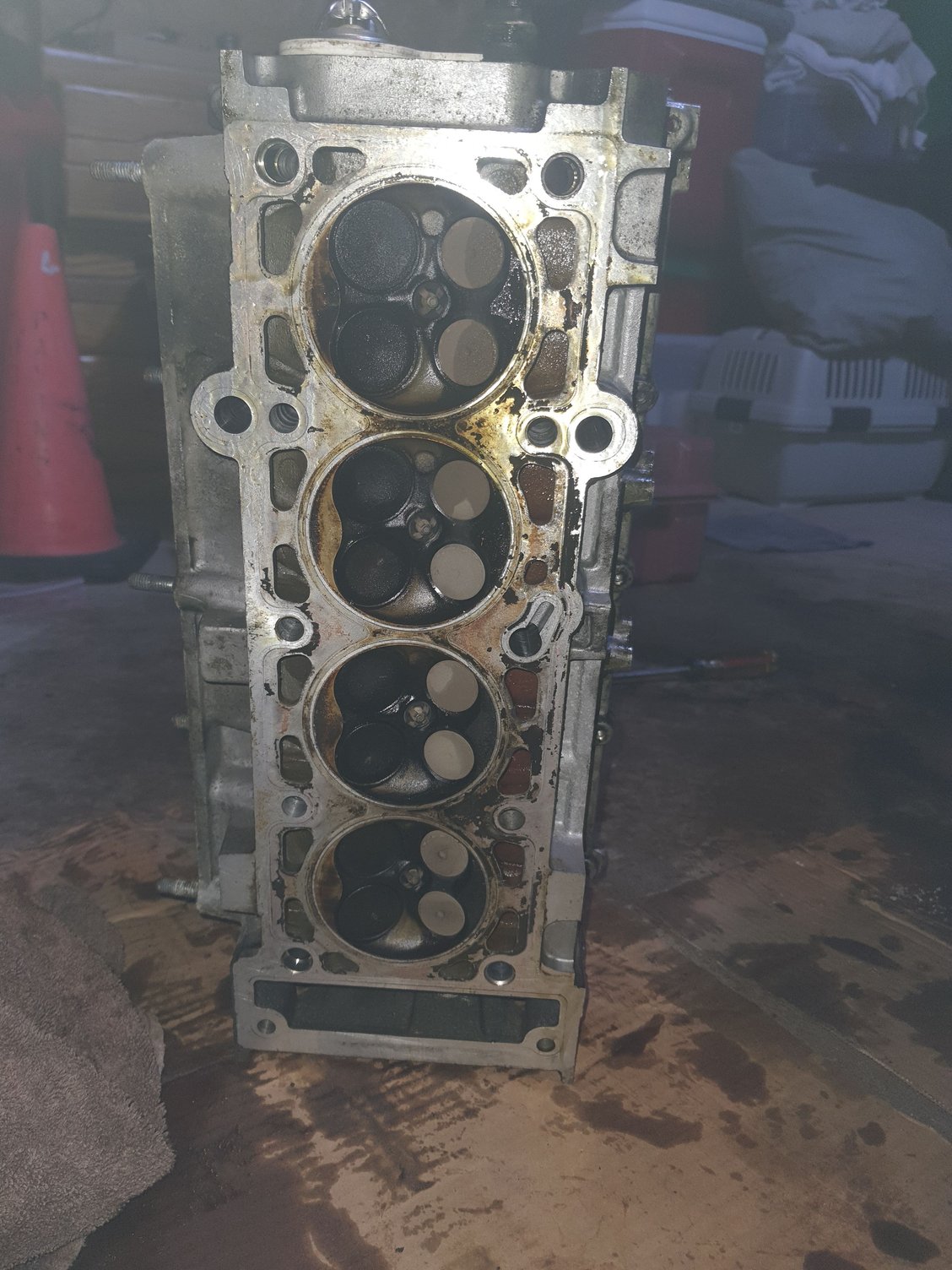

Why would my valve cover have this sealant stuff underneath it like it does ? Also , is the block number sapose to match the vin ? Either I looked at the wrong numbers but they don't match my vin and the old head is in great condition and my cyl walls the cross hatching is still clearly present. I found the source too of my very seldom oil drip,it was my dipstick tube o ring , lol the engines CAKED in crud I'm gonna scrape off there now n prep everything.
the removal went very easy . Took us only 3.5 hours to get it all off n stuff. So now I'm going to port match my intake and next weekend put it back together.

that stuff on the valve cover is normal, it's for sound deadening I think, everyone has it. Any trouble getting your exhaust manifold off? I'm nervous about breaking those rusty bolts.

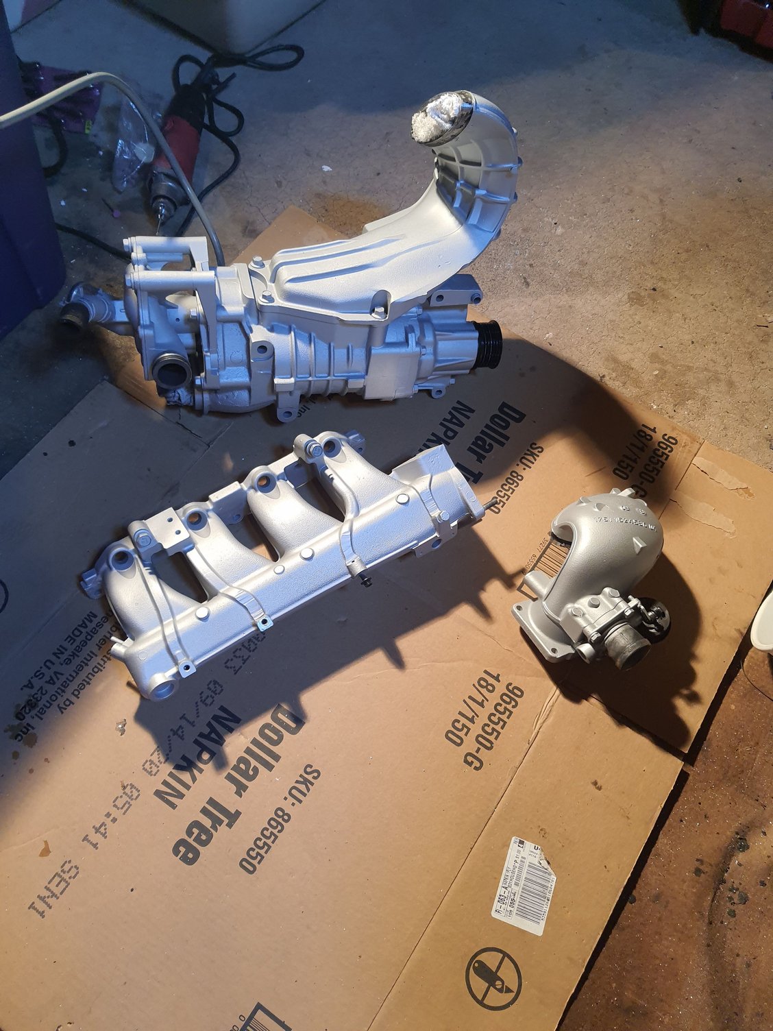

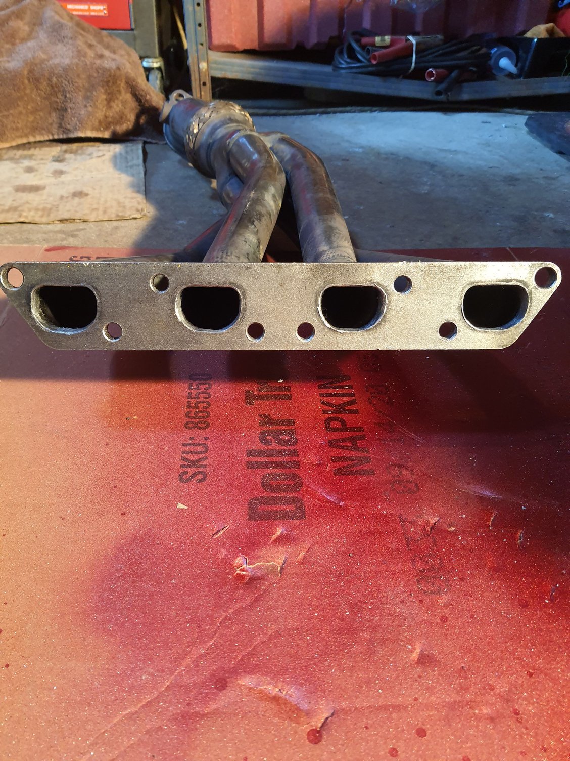

ported my exhaust manifold and intake manifold and antiheat painted the sc and intake pieces then put on a chrome red with flake paint.
Only thing I had to repair that broke was a coolant Tpipe so I rigged one together. I also fixed my oil leak at my dipstick tube. I also bought some oven cleaner ( my favorite degreaser ) and cleaned up ALL the caked on oil and crud on my engine block and trans. I then cleaned up my block and prepped the top surface to get ready to put the head on
I also put new oil in the sc and inspected it, is it just me or are the rotors in it in amazing condition ? Are they the coated rotors can you tell ?

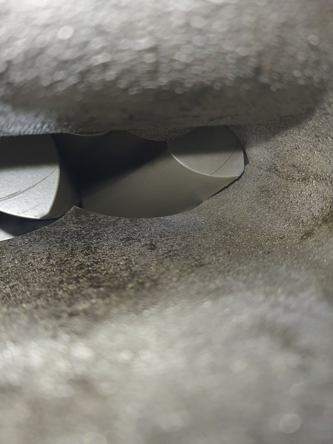

Is my motor at correct tdc I swear I read #1 piston should be at the top of its stroke, does mine look correct to you guys...now I'm nervous.
is this the timing mark and line that we're supposed to be lined up with the top of the head ??? If so I'm ****ed

looks like your 180* out. got a pic of the crank gear on the motor with the marks? Yes the #1 piston needs to be at the top of its stroke.
I thought so. My mechanic said wed be fine so I hope this is true... he said because the cam is geared and we have it all marked it should be ok ???
the side im pointing at too was facing towards the passengers side when we removed it, shouldn't it have been facing the drivers side since thats the timing mark. Atleast I've seen it in pics like that...ggggerrrrr
