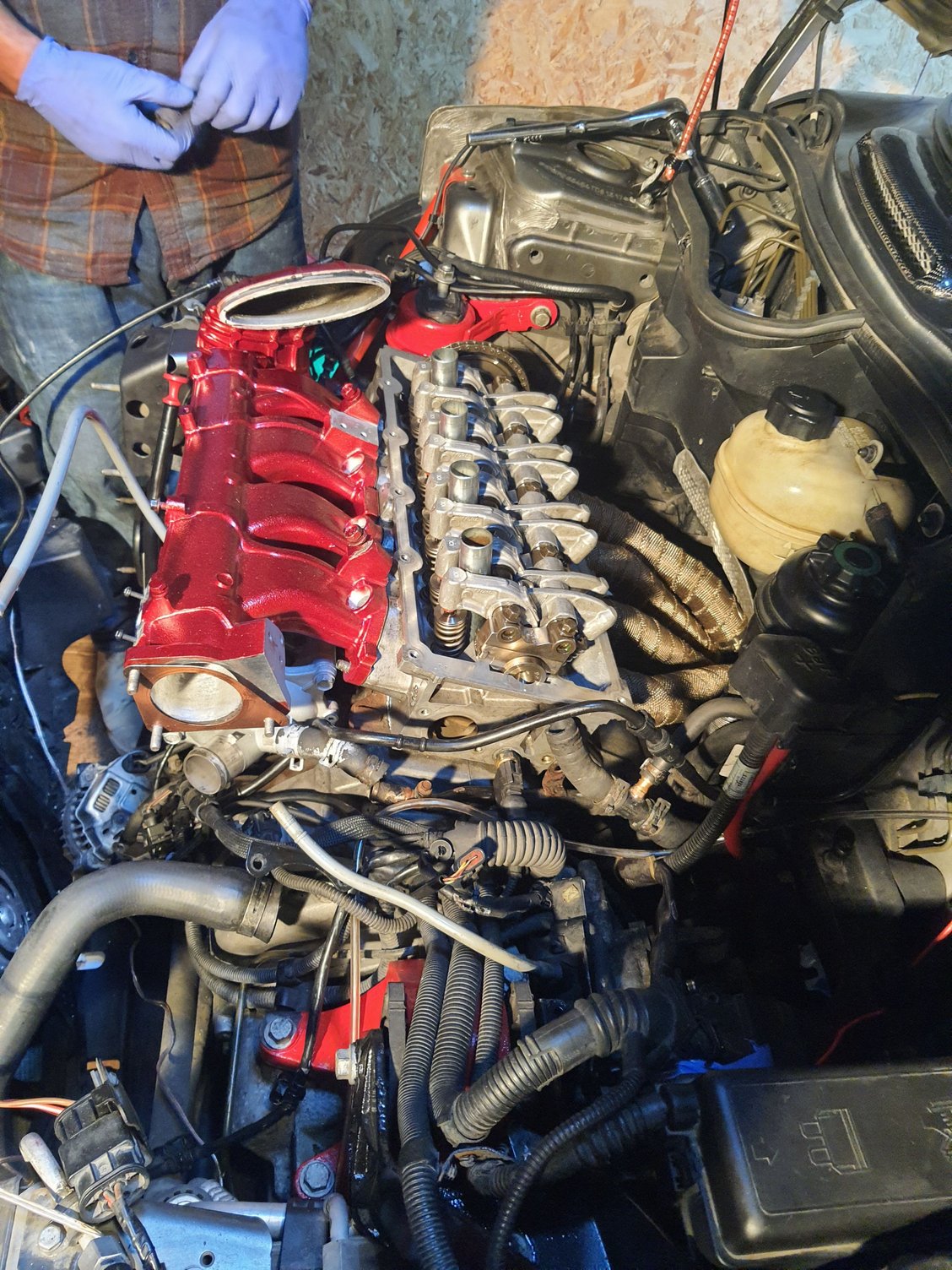

HA ! I switched around the plug wires and EVEN THOUGH the car idled fine n stuff it picked up power..😆 🤣 😂 those were wrong from the day I got the car and any time I had to remove the plug wires I just put them back how they were thinking that was correct since it seemed to be running fine..
all in all I put about 25 hours into this job and thats the removal,cleaning , porting and reinstall ect so imo that wasn't bad at all. I paid my guy 260$ too for helping me out because without him I would have been stressed out worrying about timing.
I'm so glad everything went well. The car absolutely PULLS STRONG now and it lost 0 low end. It launches just as hard if not harder. I only drove about 5 miles , adriancl will be doing my tuning for me..
so if your interested in following and seeing a 1st start up video then one while tuned, check out and follow my build thread " project rice"
​tuned.thx again for ur guys help and guidance
p.s don't mind those wires to the right hanging , I am in the process of wiring up my horns to my aftermarket wheel.
