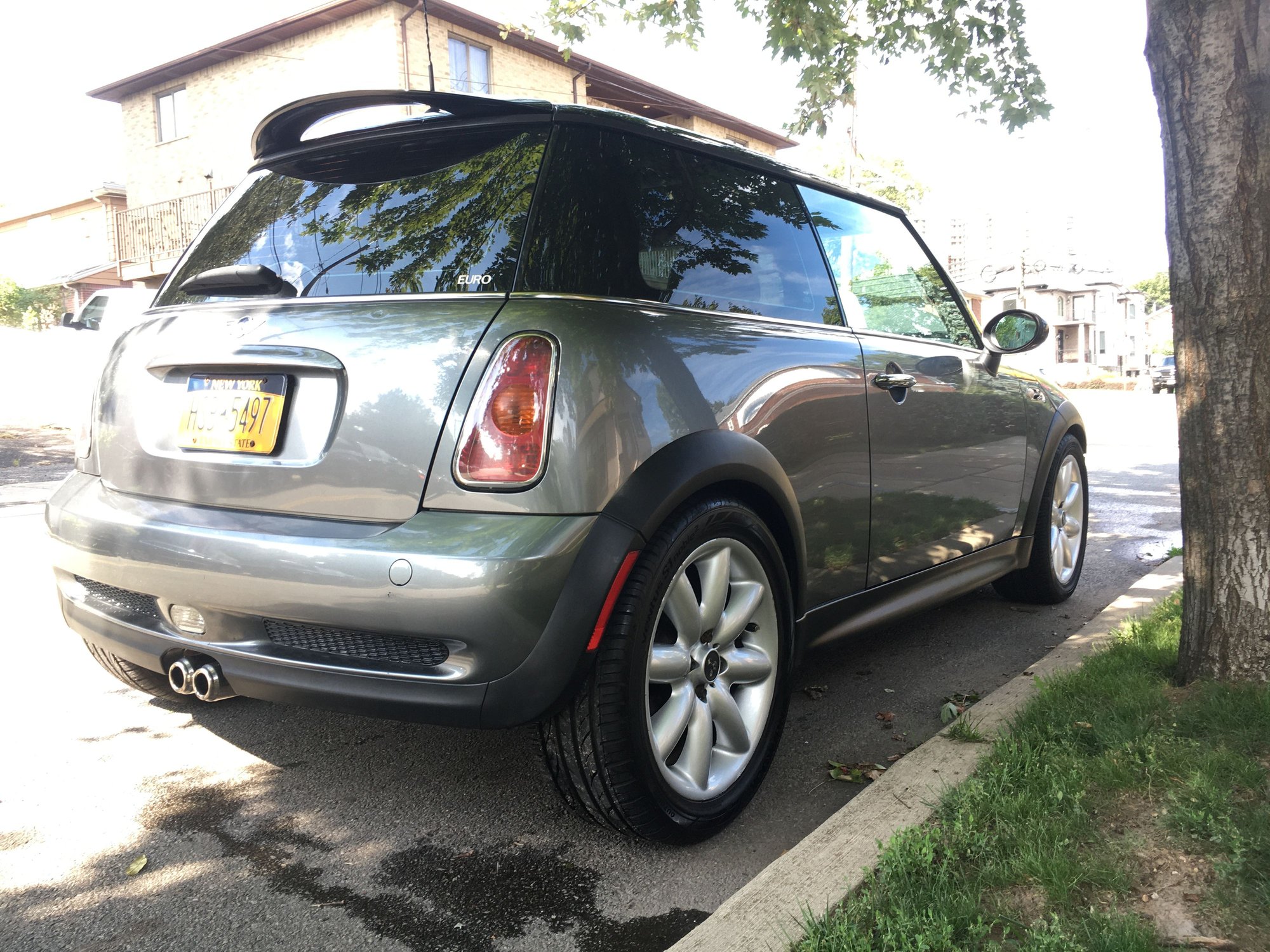

Rewind 3yrs ago a good friend of mine was in the market for an R53. We both searched high/low and i found this particular one in Connecticut. Had about 80k miles and serviced at the dealer until my friend picked it up.
During his ownership, he completely overhauled the front end, new strut housings, both axles, Both wheel bearings, both control arms and bushings, crank seal, motor mounts, oil pan gasket, new ac compressor, new spark plugs, wires, coolant expansion tank, new radiator, power steering pump, brand new hankook noble S3 (meatier setup which i personally love)....list goes on.
fast forward to 3 weeks ago my BIL mentioned he always wanted one. Made a quick call to my buddy and 2 days ($2200) later the car was his!

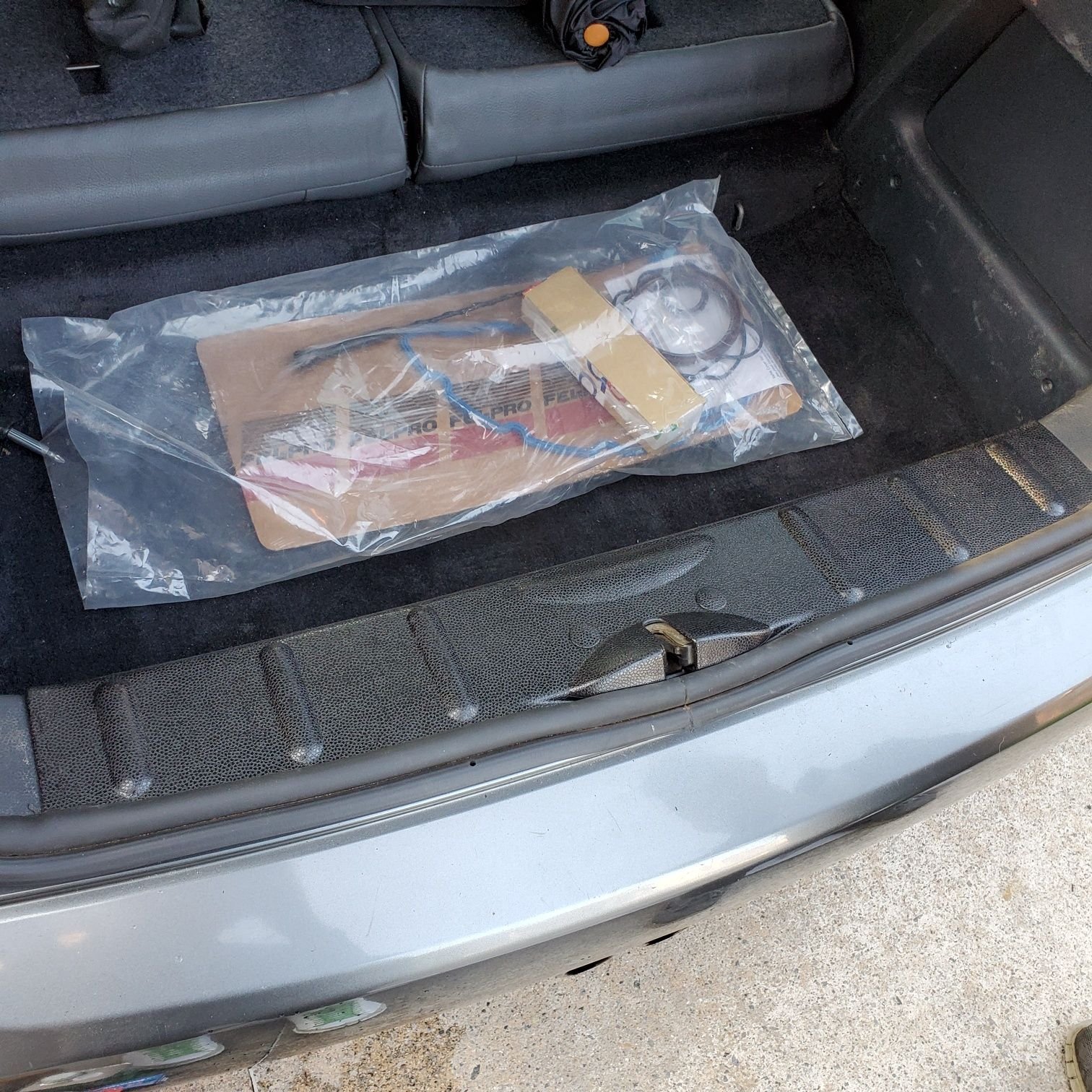

parts that came with the purchase but not installed, abs sensor, new oem rear arches (original was sideswiped), and some oil filters
here are pics from the day we picked it up
car currently had 106k miles, 6 speed, CEL light on at the time of purchase due to LDP evap leak and post car O2 sensor + trifecta of abs, low tire pressure & traction light due to bad abs sensor. Car drives like a dream otherwise

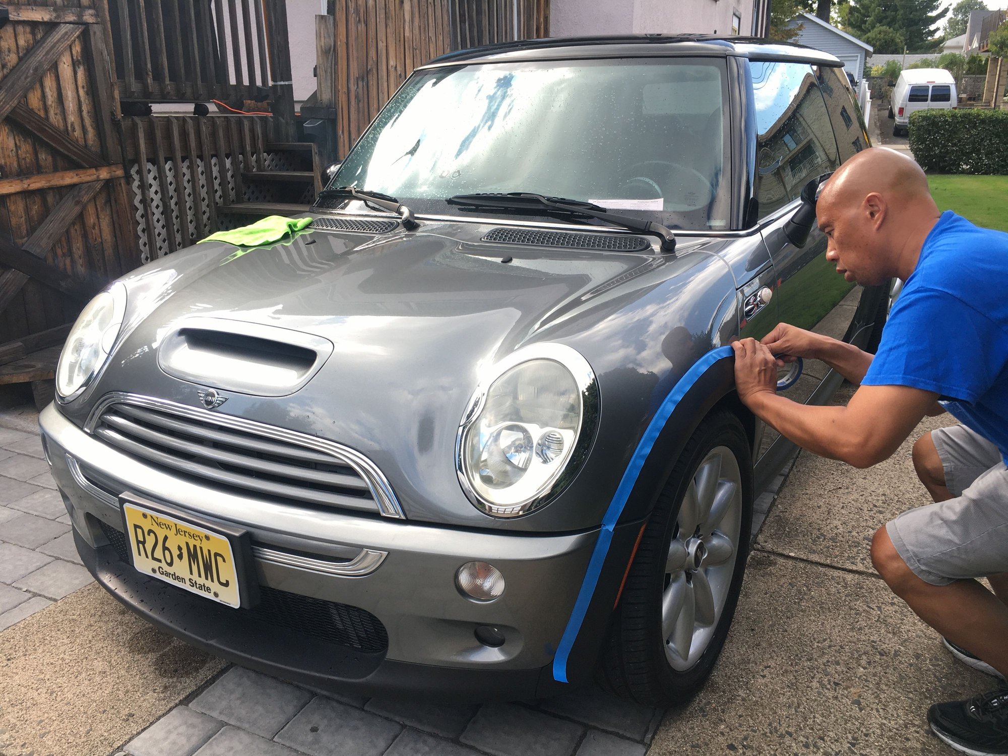

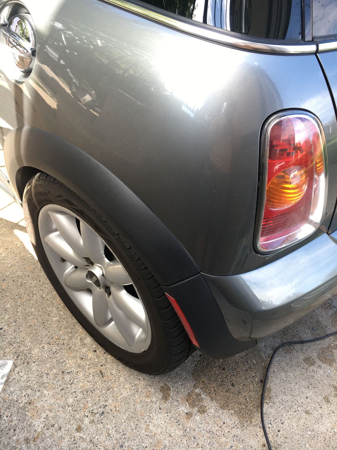

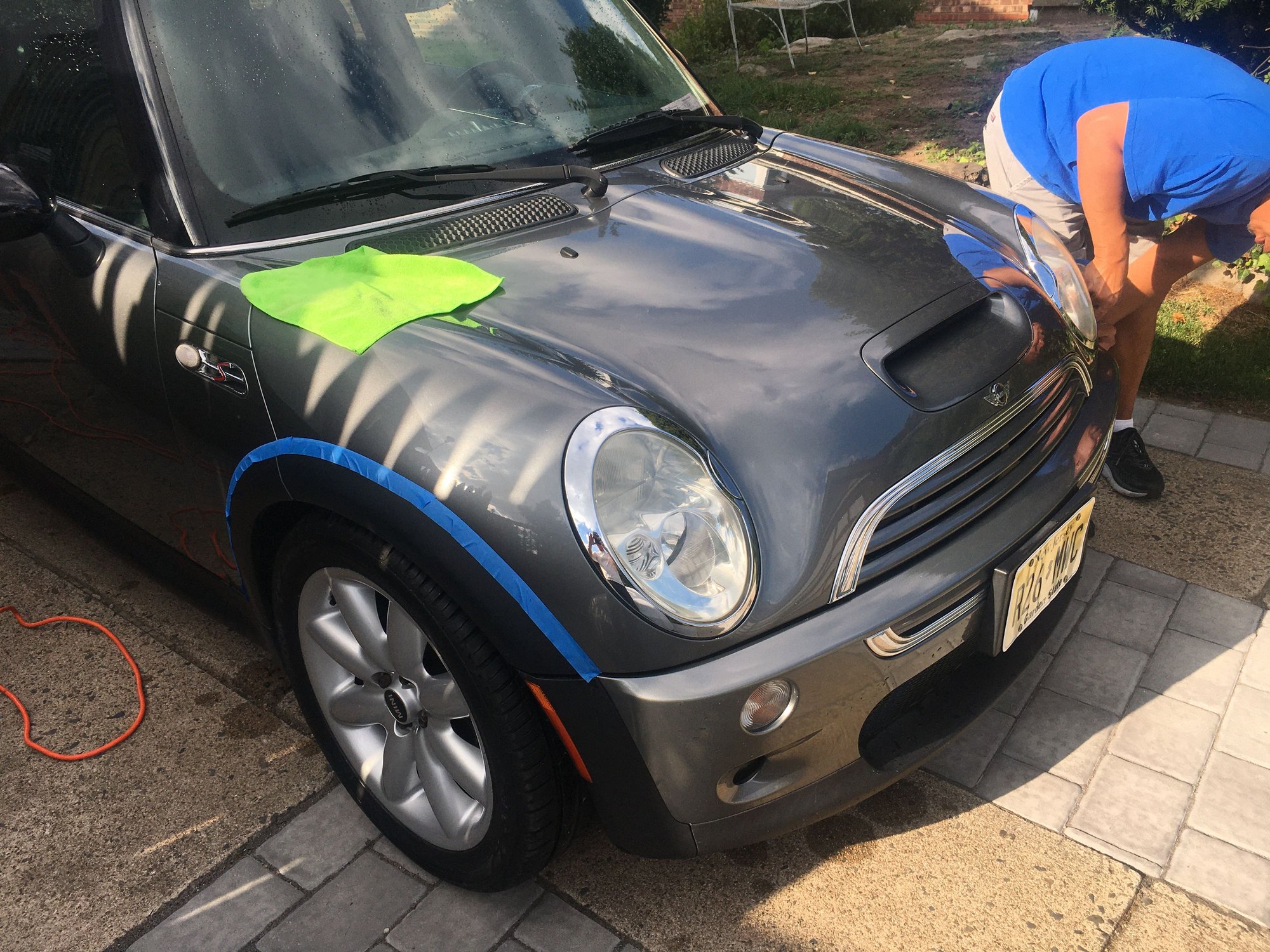

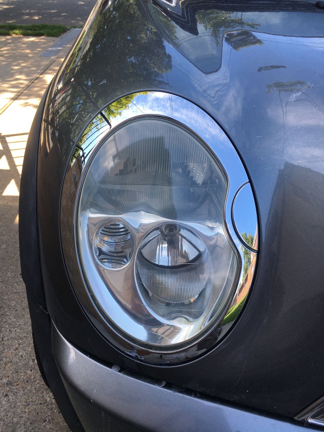

As soon as we got her home from queens, we quickly wetsanded both headlights and taillights, and buffed with my orbital. Also installed the new rear arch trim pieces my friend gave with the purchase

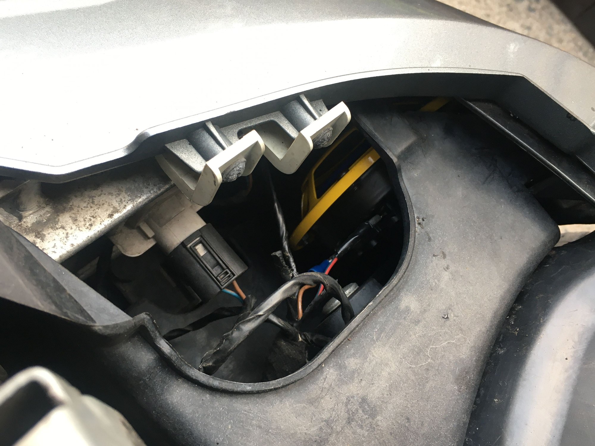

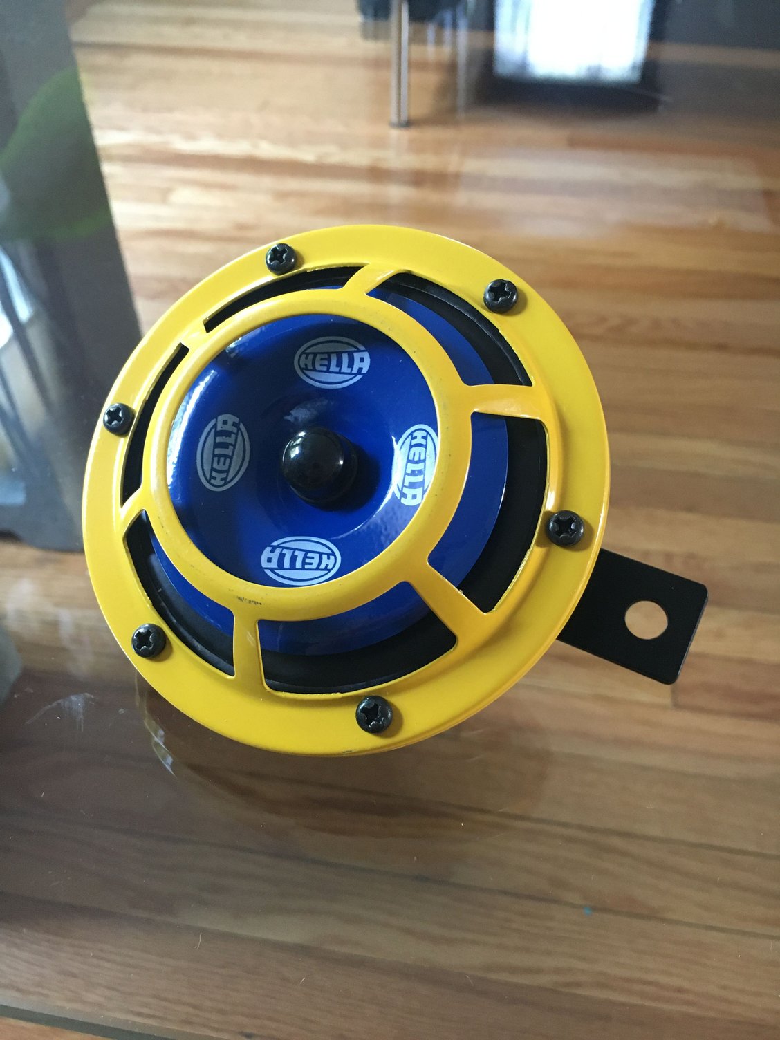

My BIL realized after driving around a bit that one of the horns didn’t work. He ordered a pair of Hella horns on amazon and we removed the front bumper to access the horns. A little wiring, and the horns were installed and sound amazing!
while in there we adjusted the droopy front passenger side of the bumper by raising the height adjustment bracket. Head bolt snapped off so i was able to drill a hole in the adjustment bracket and zip tied it in place to hold proper height. Now the front bumper sits even!

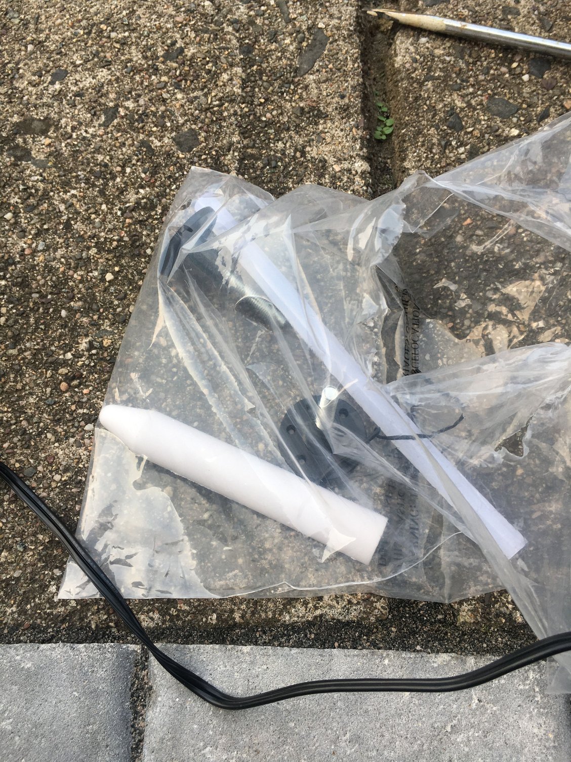

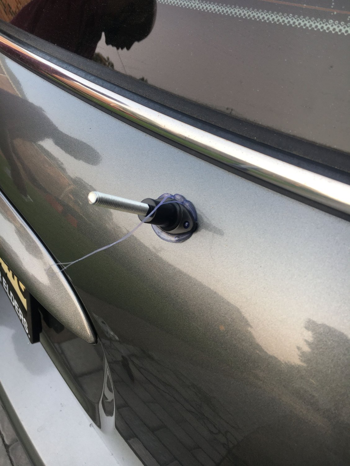

Then we decided to take a stab at Paintless dent removal. Picked up a $20 kit from autozone to take out a couple dents on the trunk and door. We were pleasantly surprised at the outcome. 1 of the dents came out completely. The other 2 about 80-90%
Before pic

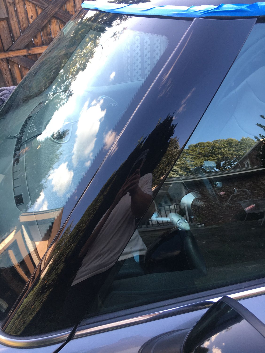

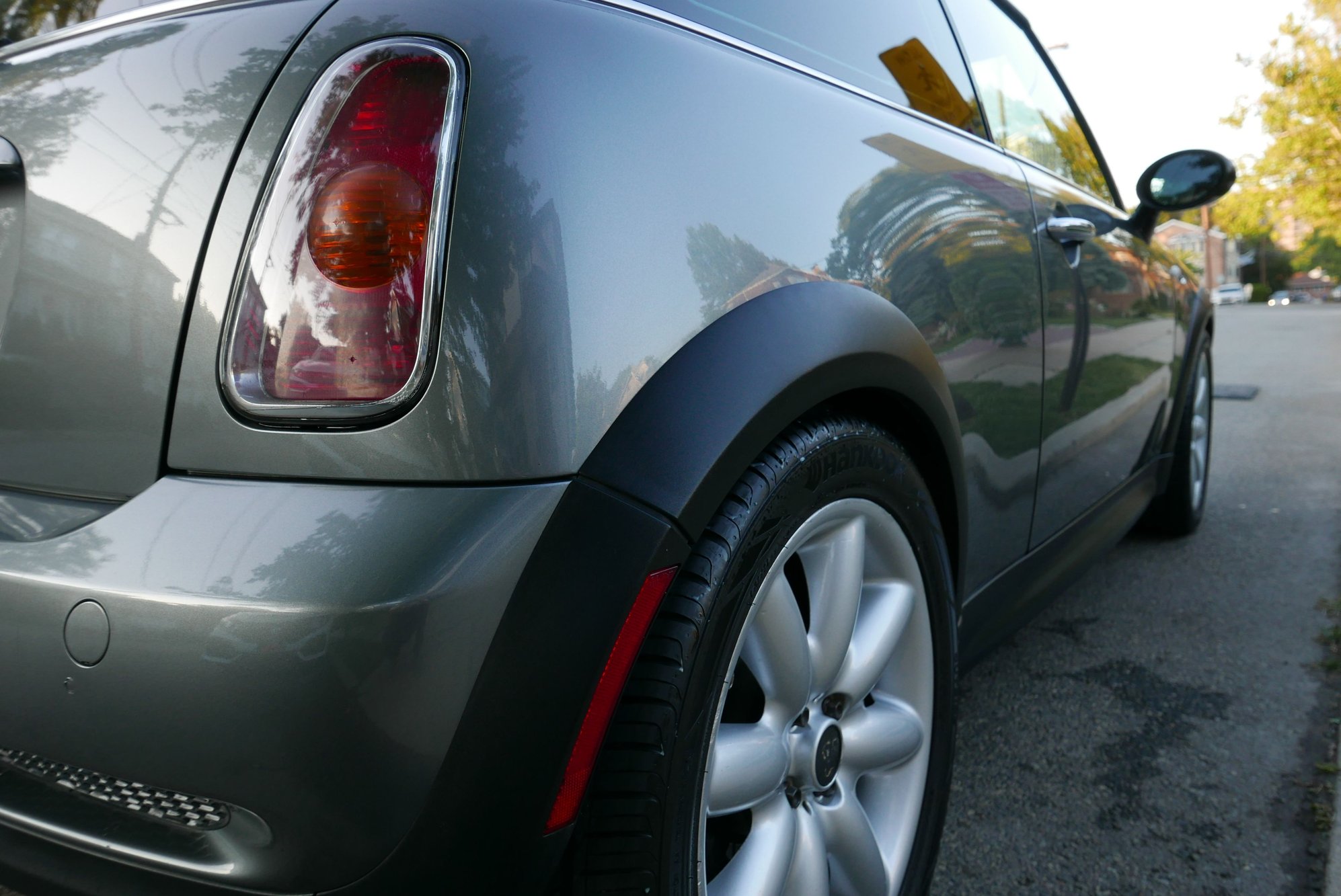

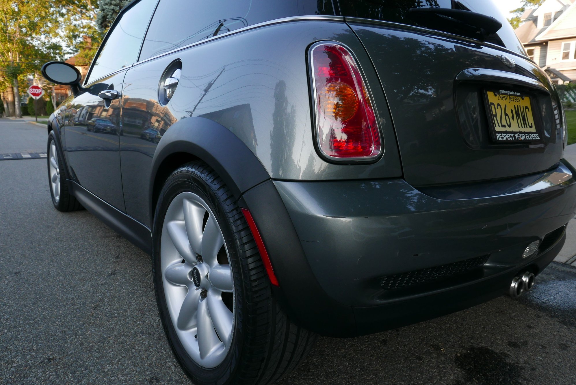

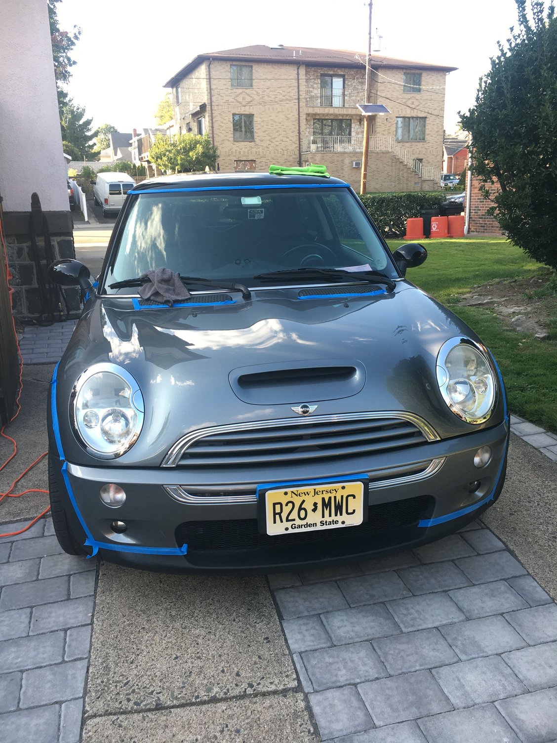

Today was the next hurdle. We spent the day clay barring the rough feeling paint, and did a paint correction on the entire car. Unbelievable results!!! The car looks and feels so slick! Can’t believe how pristine the paint came out....

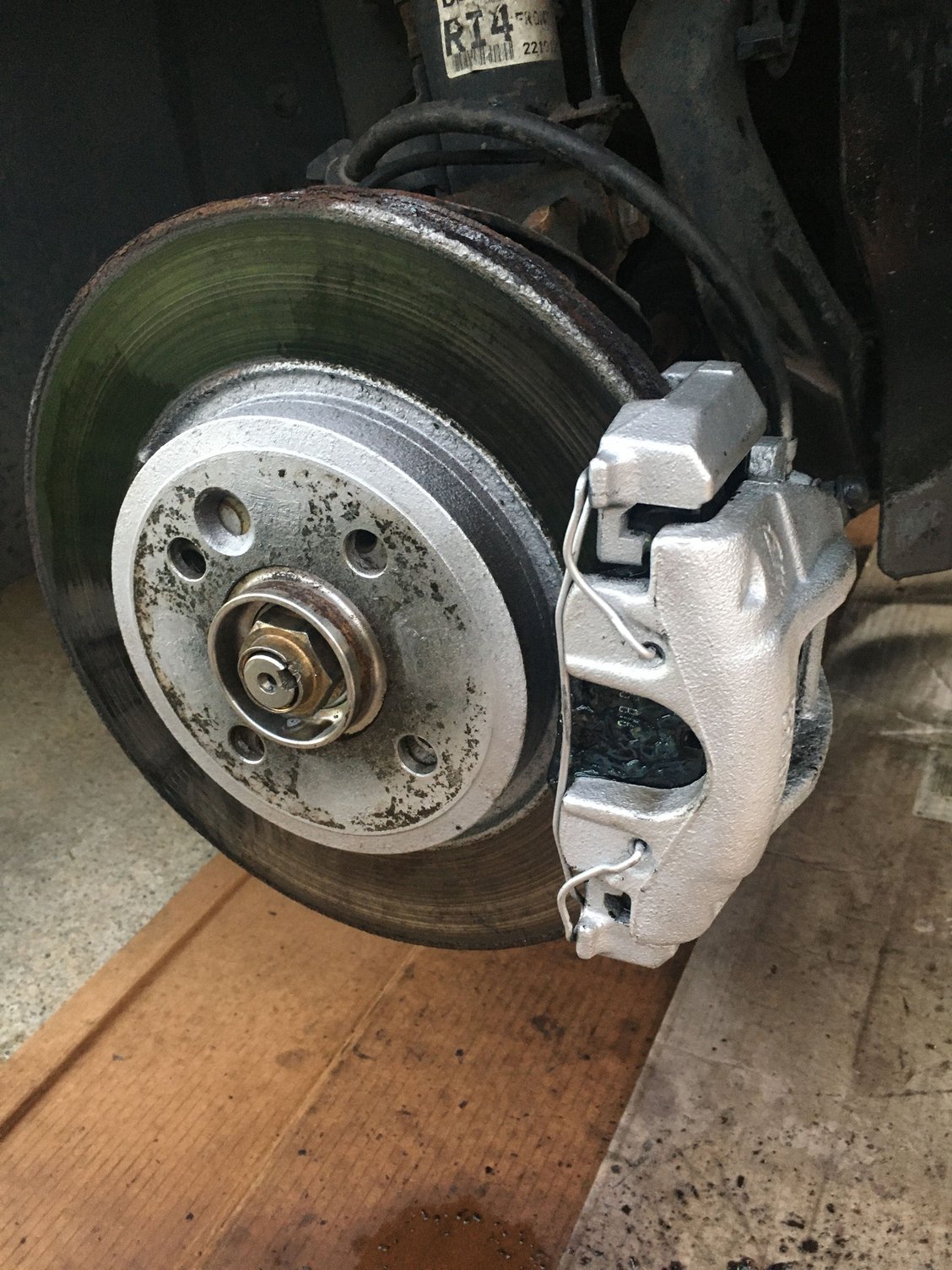

painted calipers the other day too

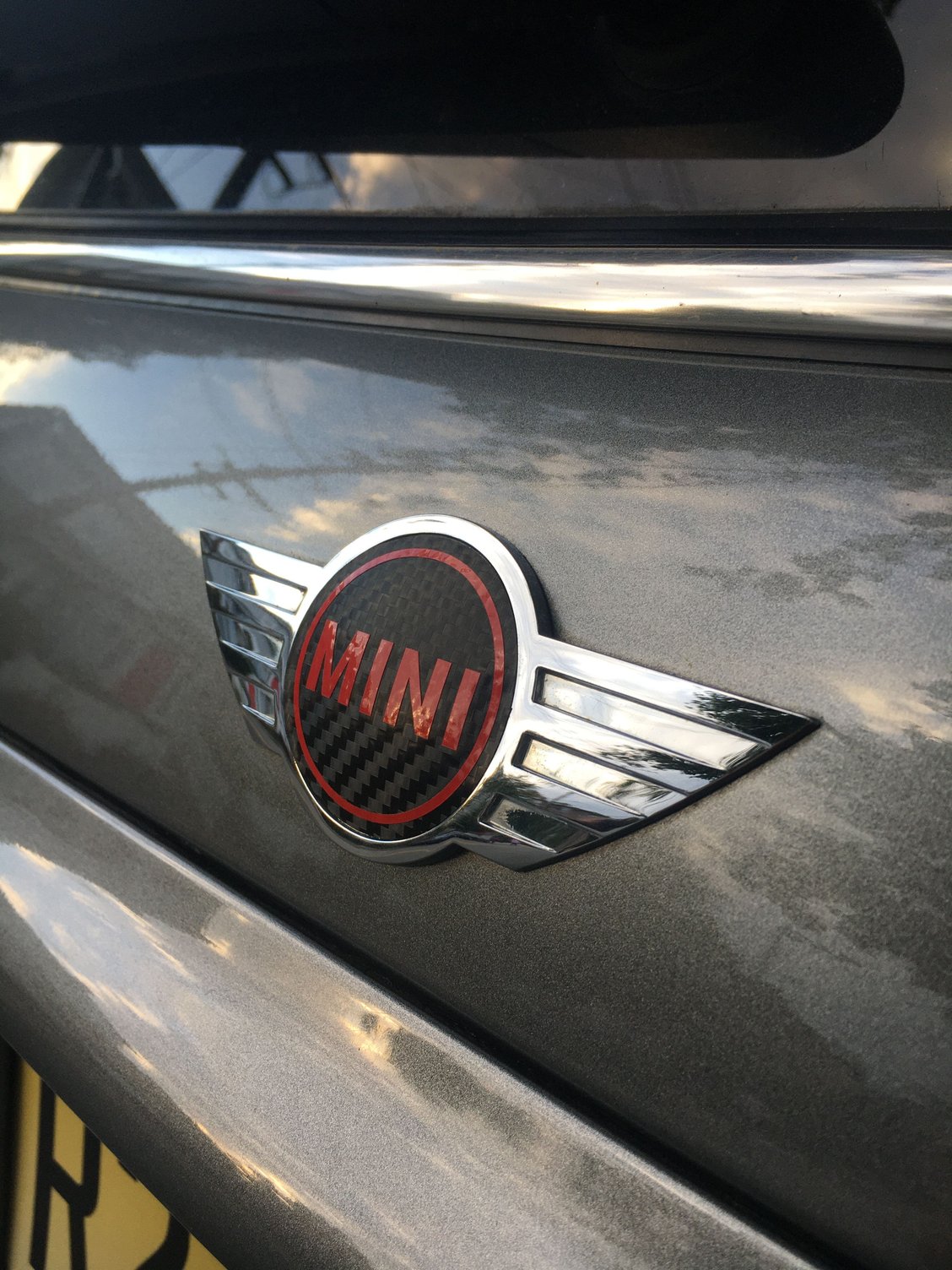

Instead of swapping badges my BIL picked up these carbon fiber decals for the front and back. With a little heat with a hair dryer we got them to stick well

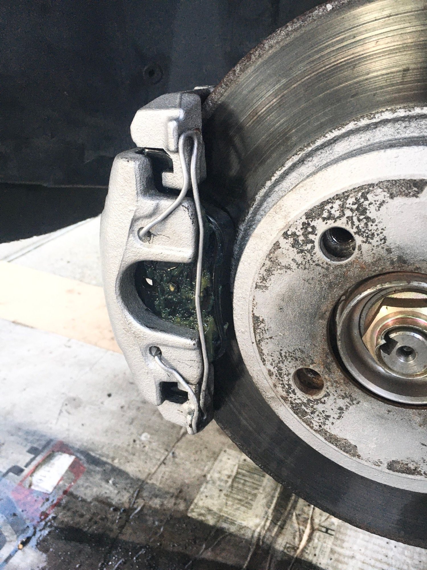

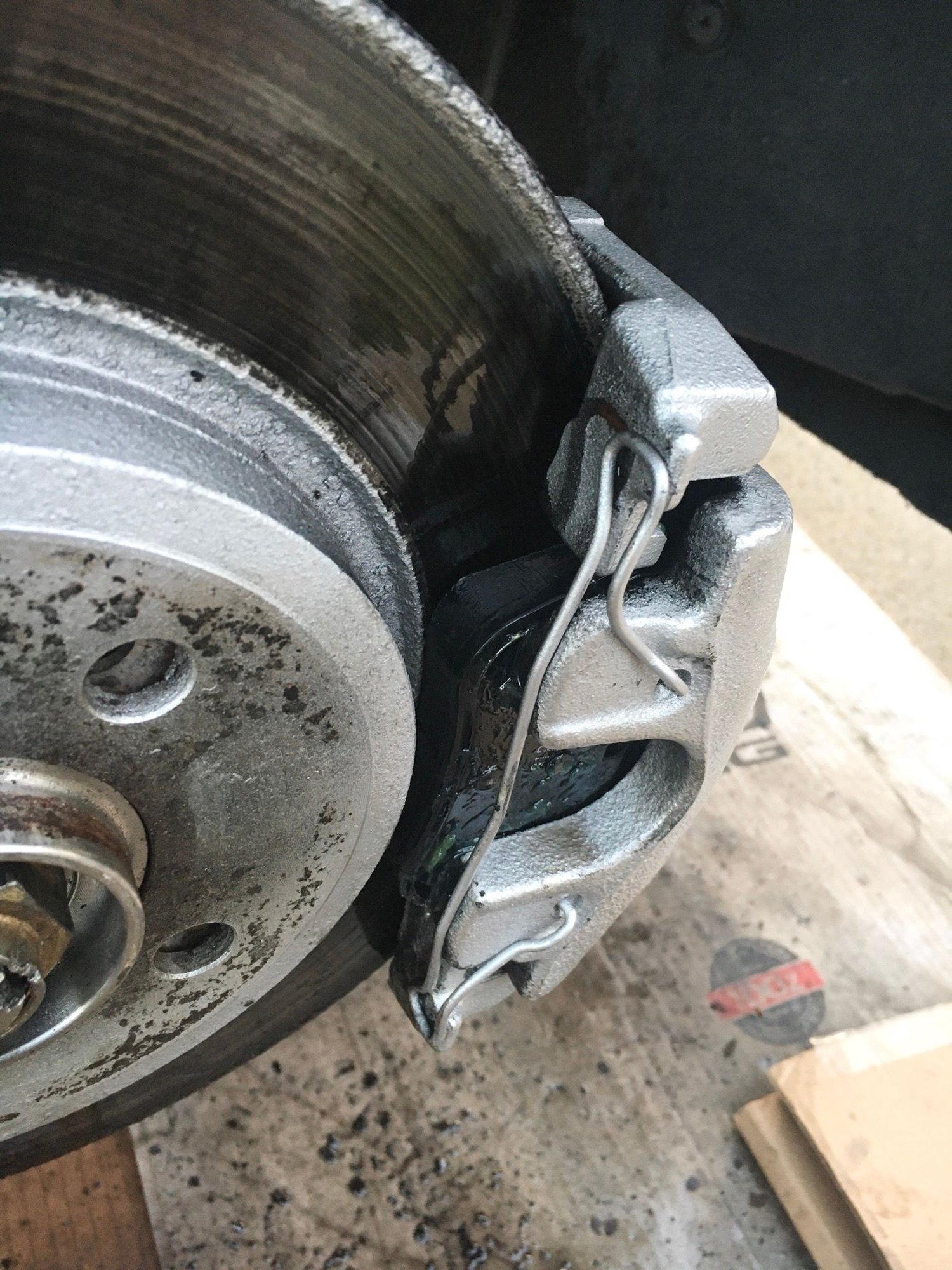

Did a pad slap with akebono pads and new brake pad wear sensors.
