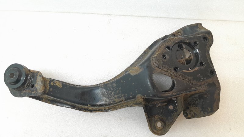

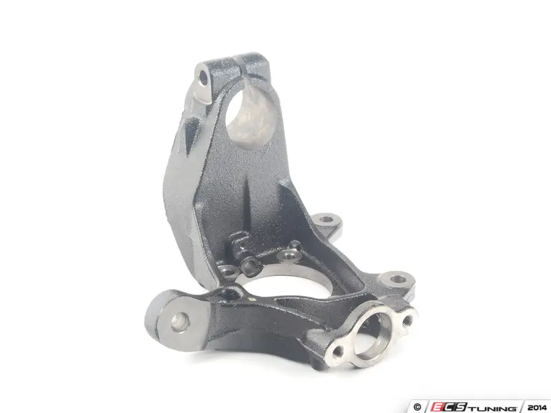

The old ones are most of the time rusted into the steering knuckle/ carrier or tailing arm. So you will break everyone of them trying to remove them.
Rusty trailing arm
Rusty front knuckle
New front knuckles
https://www.ecstuning.com/Search/Sit...h/31216757498/ Right passenger side
https://www.ecstuning.com/Search/Sit...h/31216757497/ Left driver side
Yellow circle is front knuckle ABS sensor location.

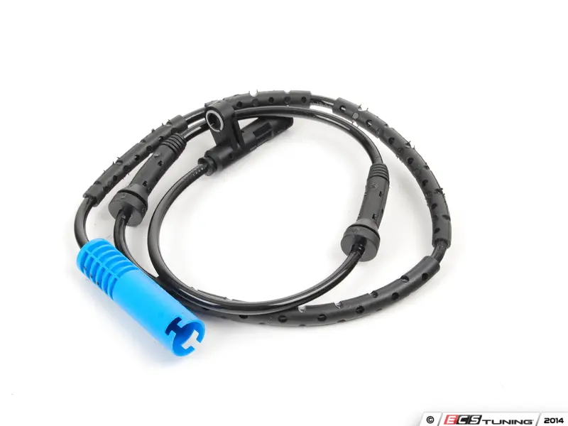

***These will need cleaned with a reaming tool or sandpaper tool really good.** You might need to file down the tabs on the new one to install. Use a little light grease but don't use too much to block the signal.
Front ABS sensor ( work on the left driver side and the right passenger side ) Part number 34526756384
http://www.ecstuning.com/Search/34526756384/
When installing the ABS sensor make sure you clean out the insertion hole, as I have had corrosion built up and when you slide it in they tend to stick. When you pop the old one out and its damaged you might have to take the wheel bearing off to get it from the bottom and push up. Soak the top of the sensor insertion with some PB blaster or penetrating fluid and let soak. There is a little hex head screw that holds in the sensor.
For the rear follow the same thing: These go straight in from the back side of the trailing arm.
ABS Speed Sensor - Rear Part # 34526756385
http://www.ecstuning.com/Search/SiteSearch/34526756385/
