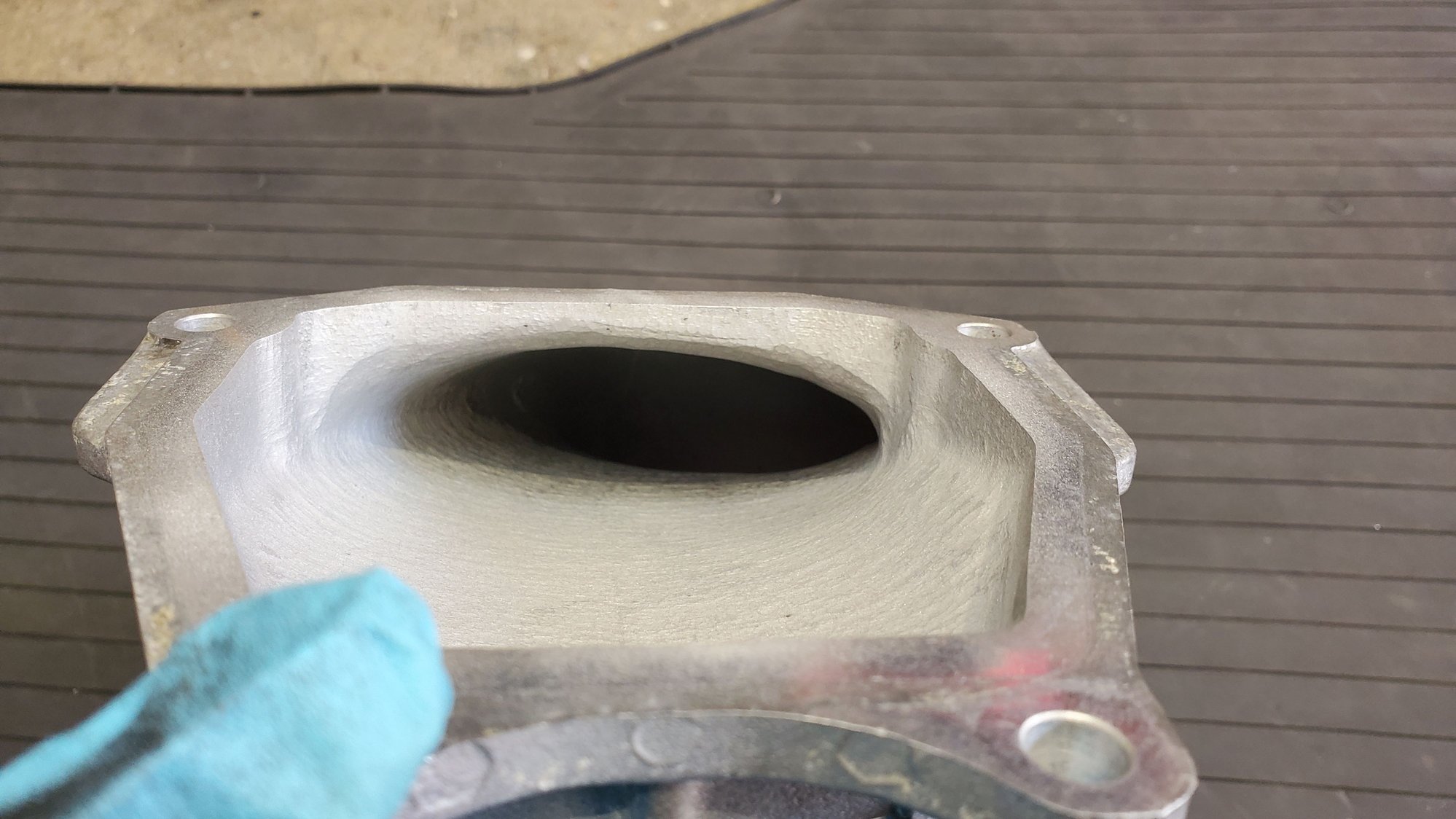

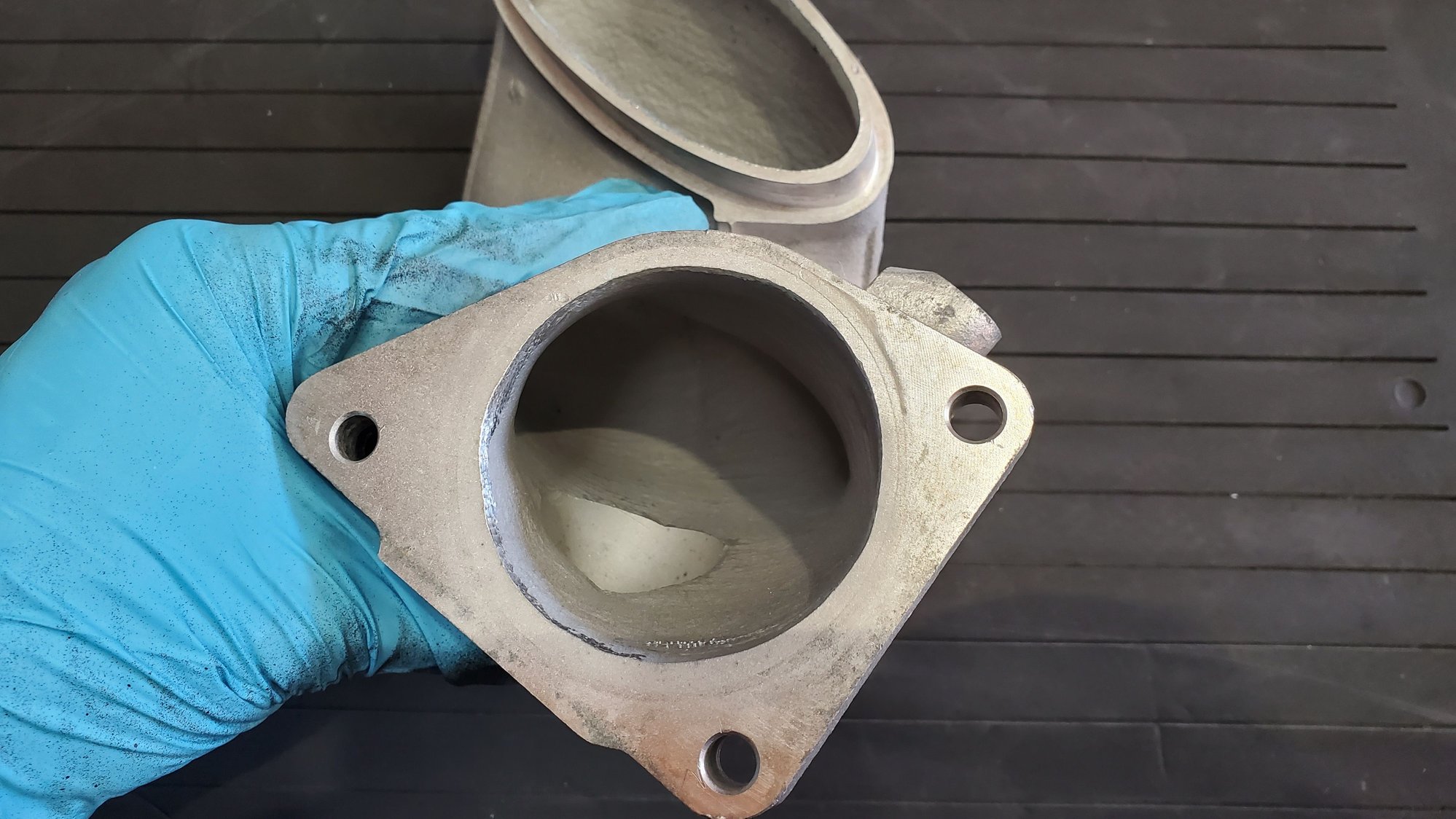

So I found porting just the intake side of the sc and installed a 19% pulley. The combo is keeping stock iat's dang near with other supporting mods and it's making 19psi too !
I ported a facelift sc out on the intake side and completely removed the hump. I also then port the same part out of the plastic boost tube and open the throttlebody end opening up abit. I also port the intake Manifold ports and enlarge its inlet also , I hollow out and reshaped the inside of the intercooler horns also and on the driver's side elbow I grind down the bolt humps inside and completely reshape and smoothen out the air path.
i also ported out a head BUT haven't installed ot yet BUT my buddy installed his i ported along with everything else and his car is night and day.
then you install a bmvv12 65mm throttlebody and 3in intake and I can GUARANTEE your car will pick up some awesome power.
there is SO much room for improvement on our stock intake components. On an all stock engine im sure it would help still but when you throw on a cam , smaller sc pulley ect , that's when the porting really starts helping.
lol I even ported out my Sprintex supercharger horn because it too had crap internal casting and room for improvement too. Though the sc its self cannot be ported.
here's some pics of my port jobs.. I've also been finishing them off by sandblasting them internainternally as it really brings out a much much smoother finish vs just hand polishing. That idea was given to me by a fellow member..
https://www.northamericanmotoring.co...rting-job.html
