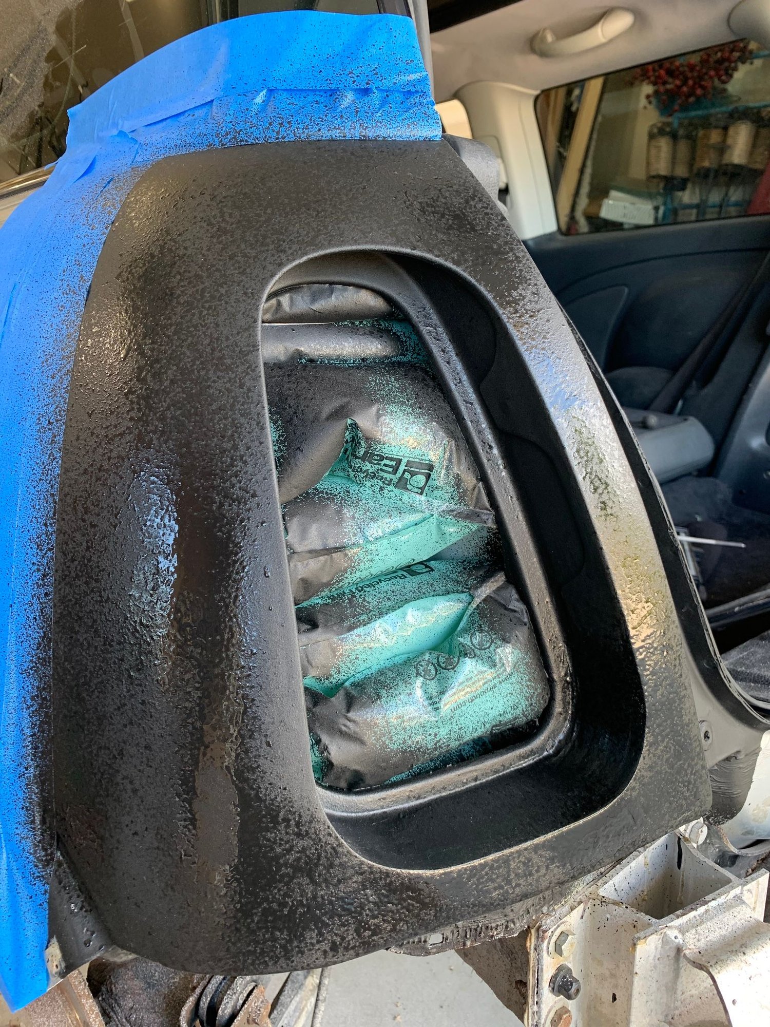

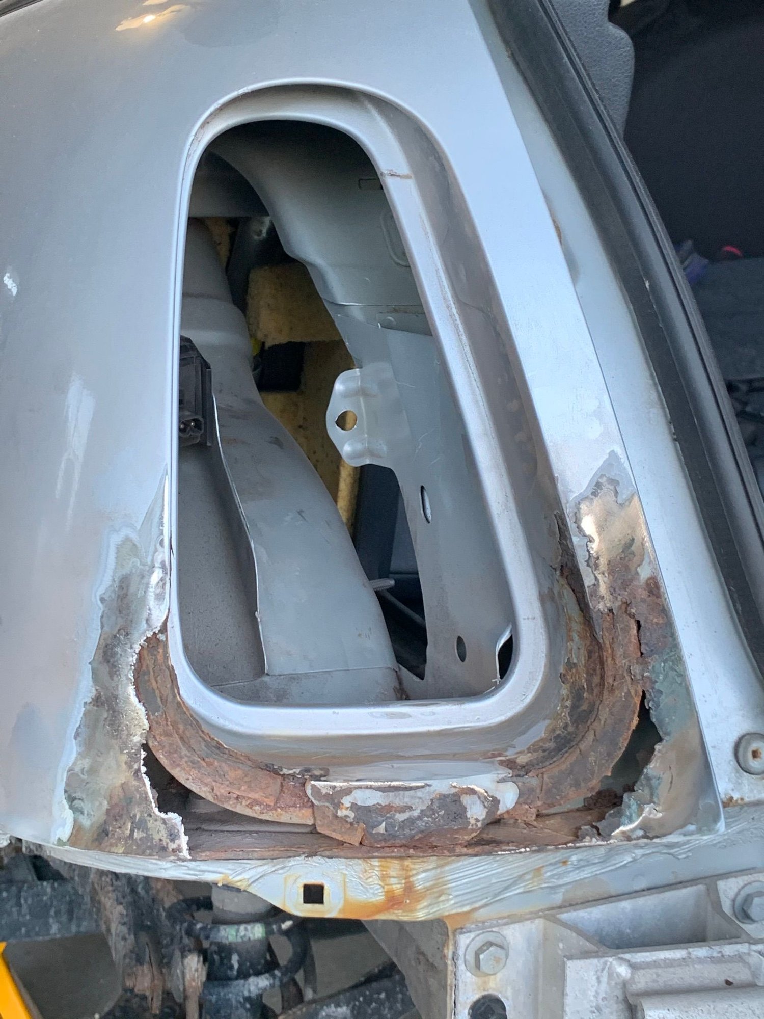

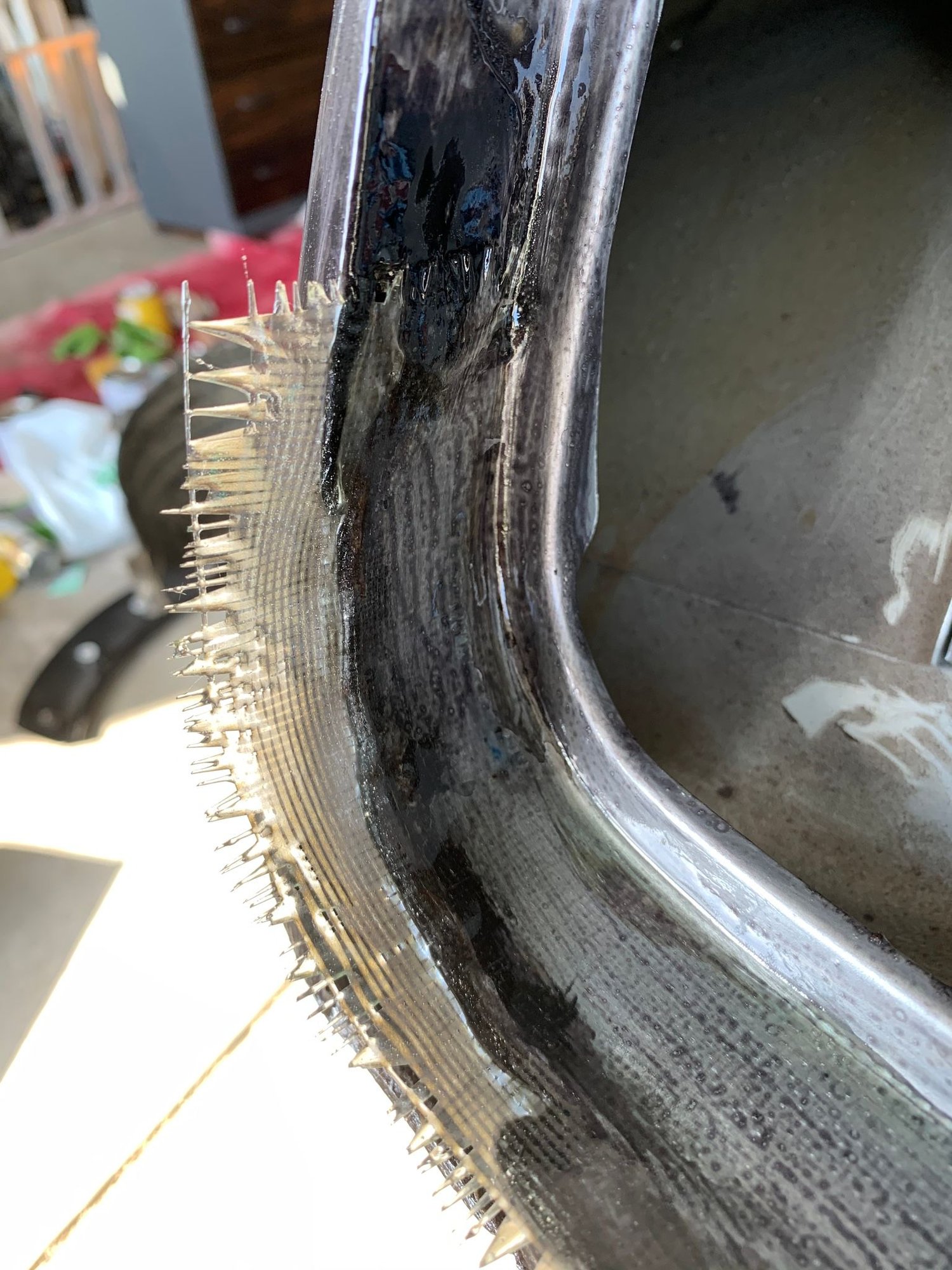

Lesson learned: be careful when you start digging. You might not like what you find. So I brushed on some rust converter (saturated the area, actually) and got to work with the fiberglass cloth, reforming and sculpting the missing metal out of glass. After I got it all stuck together, trimmed, sanded, and painted (used spray bed liner for contrasting lines and ease of hiding my amateur body man status), I’ve restored it to original shape.
Not too shabby. But then I looked underneath the vehicle...

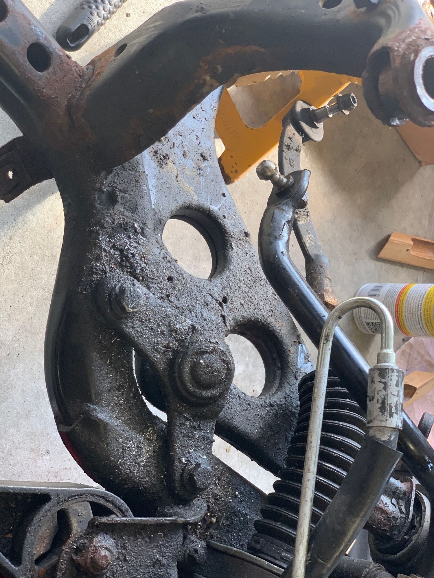

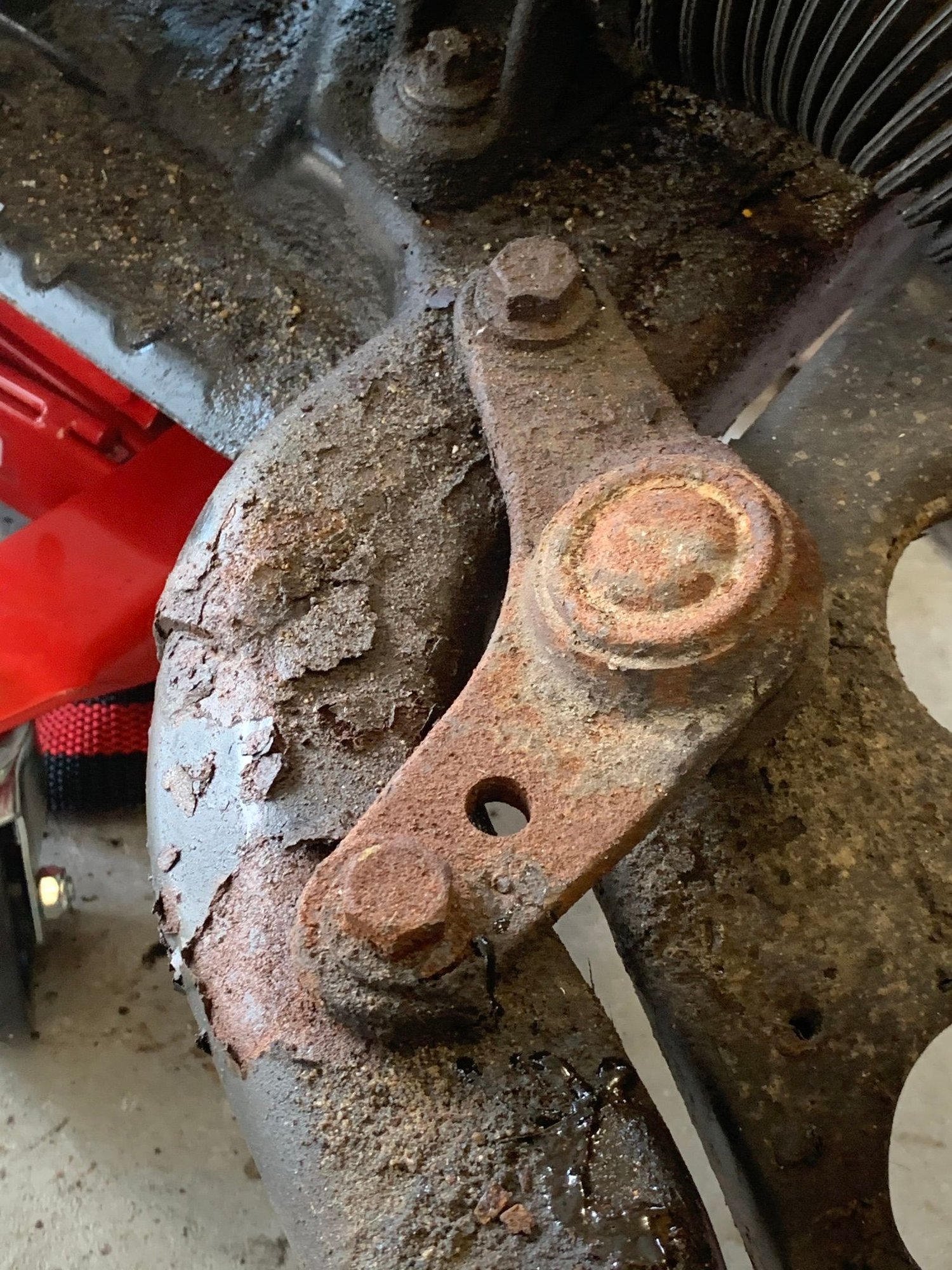

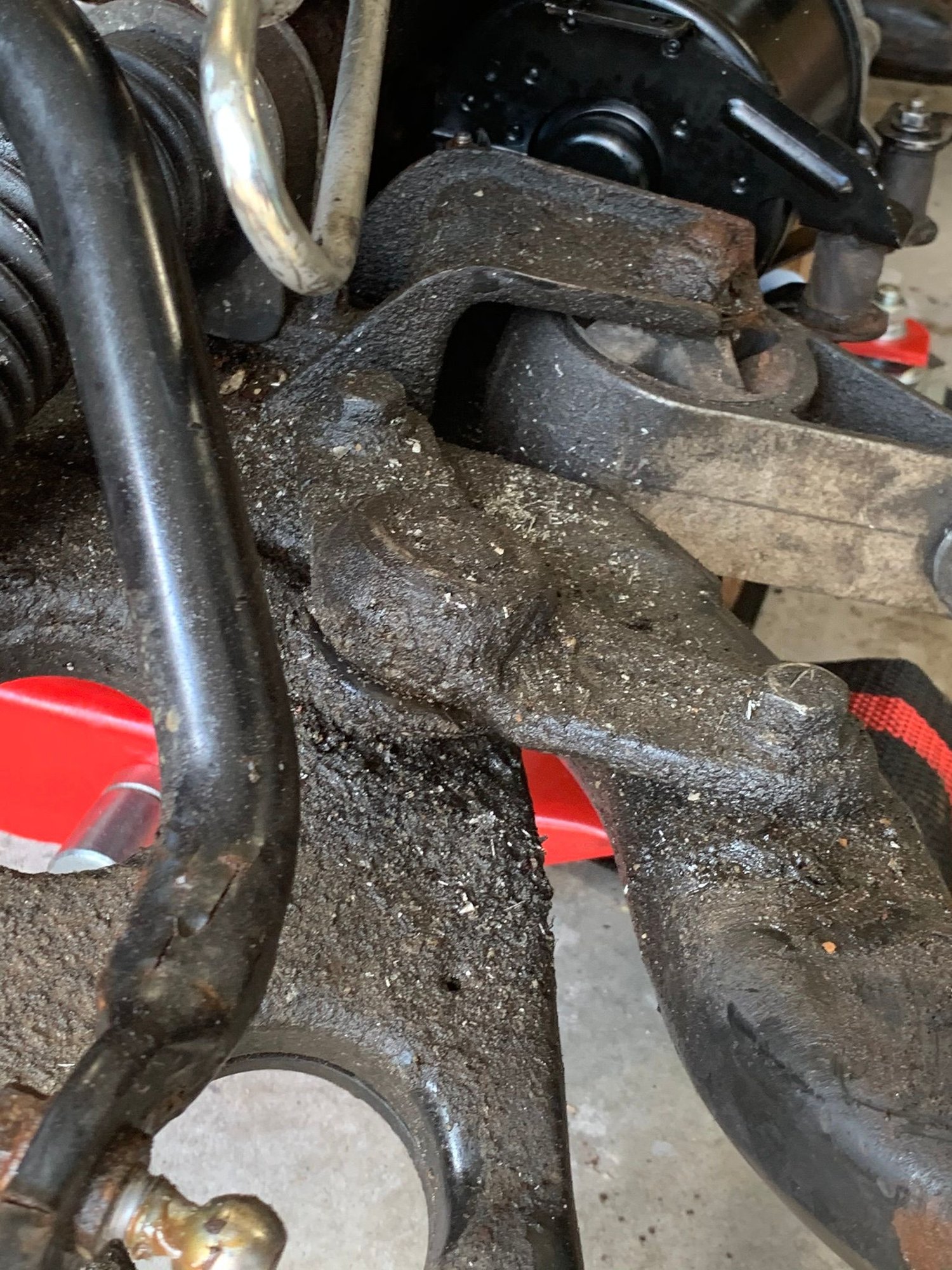

So as I crawled under the vehicle, I saw signs of leaks the guy said didn’t exist. Oil dripping from the front and all over the bottom, inboard boots busted clean off and flinging grease everywhere, rust *everywhere*, every ball joint boot busted and leaking, and you can imagine how the rest might look. Oh, and power steering doesn’t work. I’ve got myself a project!

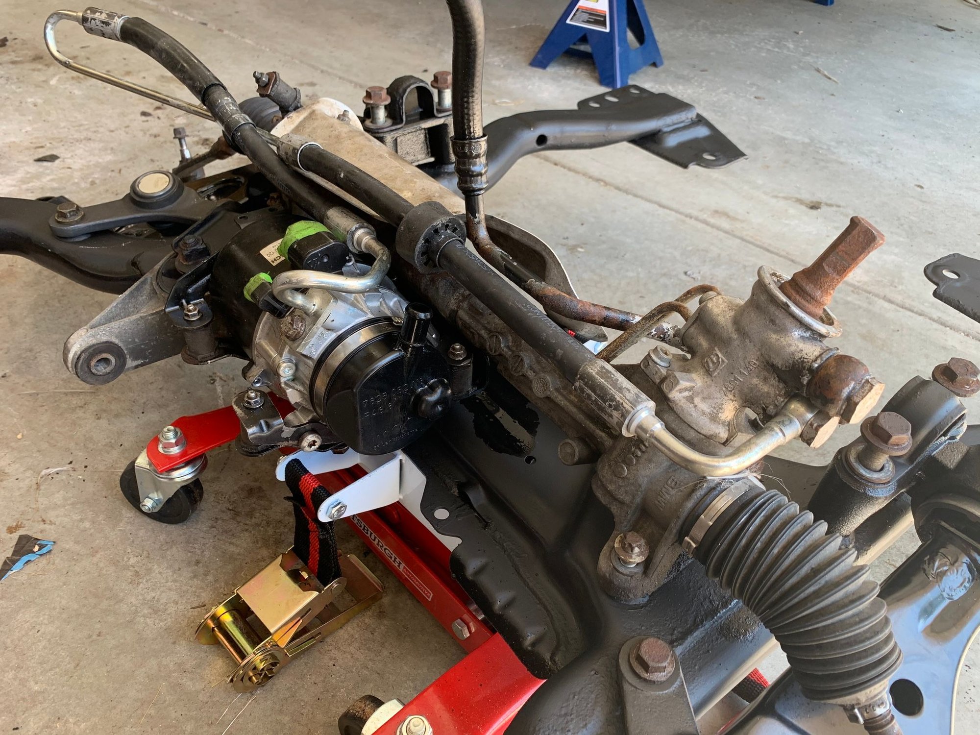

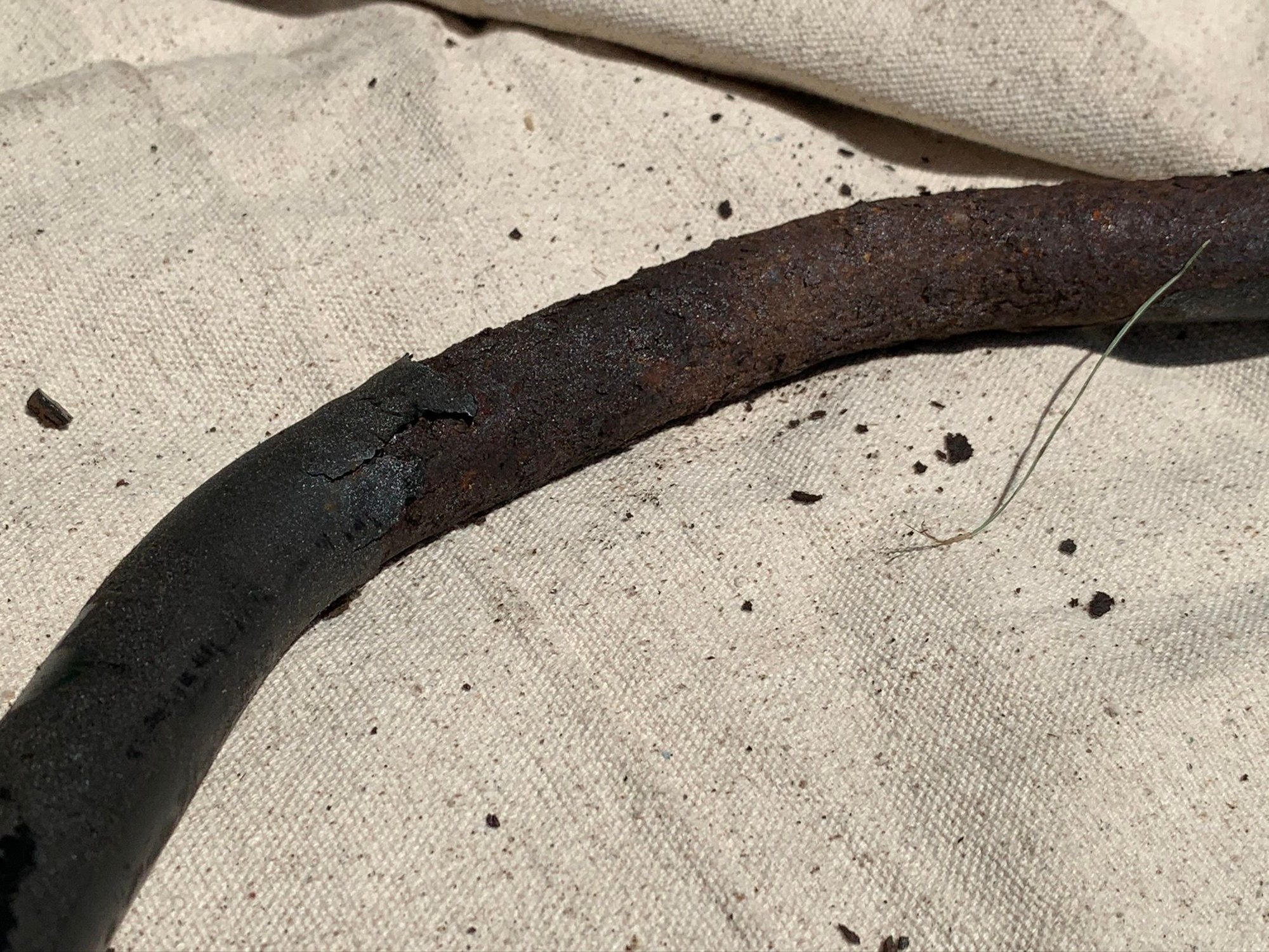

So I started with the power steering pump and crank position sensor seal. Learned a few new swear words, but I can see this isn’t the first power steering pump this vehicle has had in its 148,000 mile poorly cared for life. That’s when I found the axle seals, ball joints, rusted everything... so I set out to order a lot of new parts and started the disassembly process.

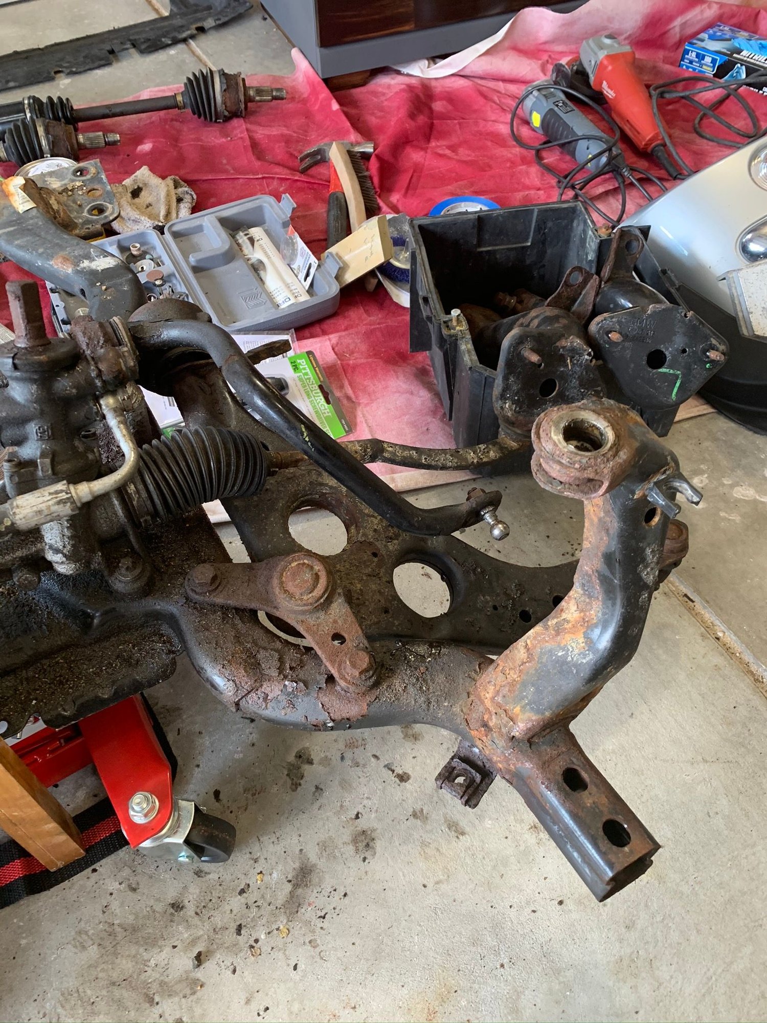

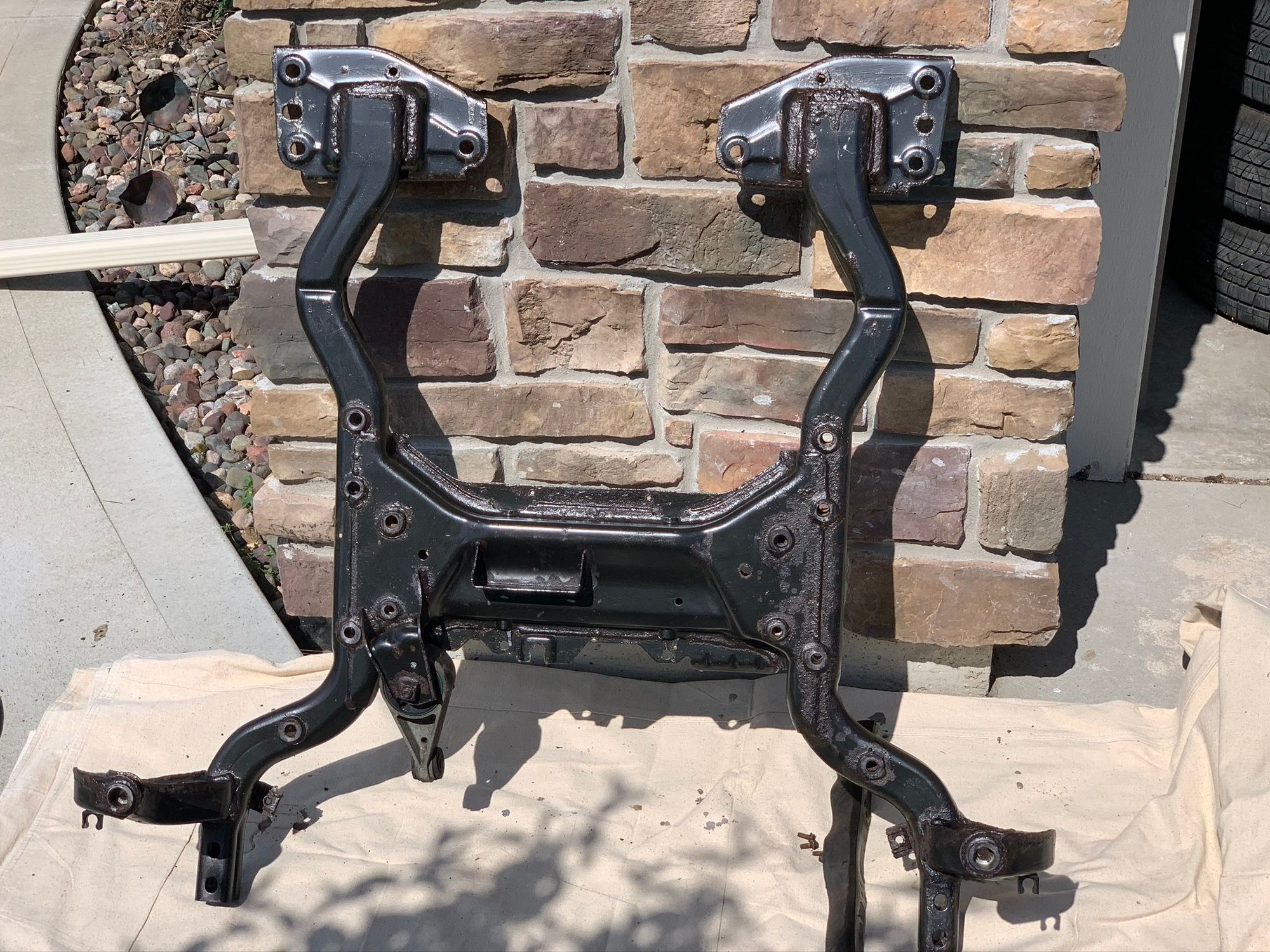

Super gross, super rusty. So I ordered all new ball joints, control arms, and bushings along with power steering hoses from FCP Euro (surprisingly affordable), some new subframe bolts, axle seals, and a sway bar from the dealership, new axles and a host of other small bits from 1A Auto, and got ready for battle.

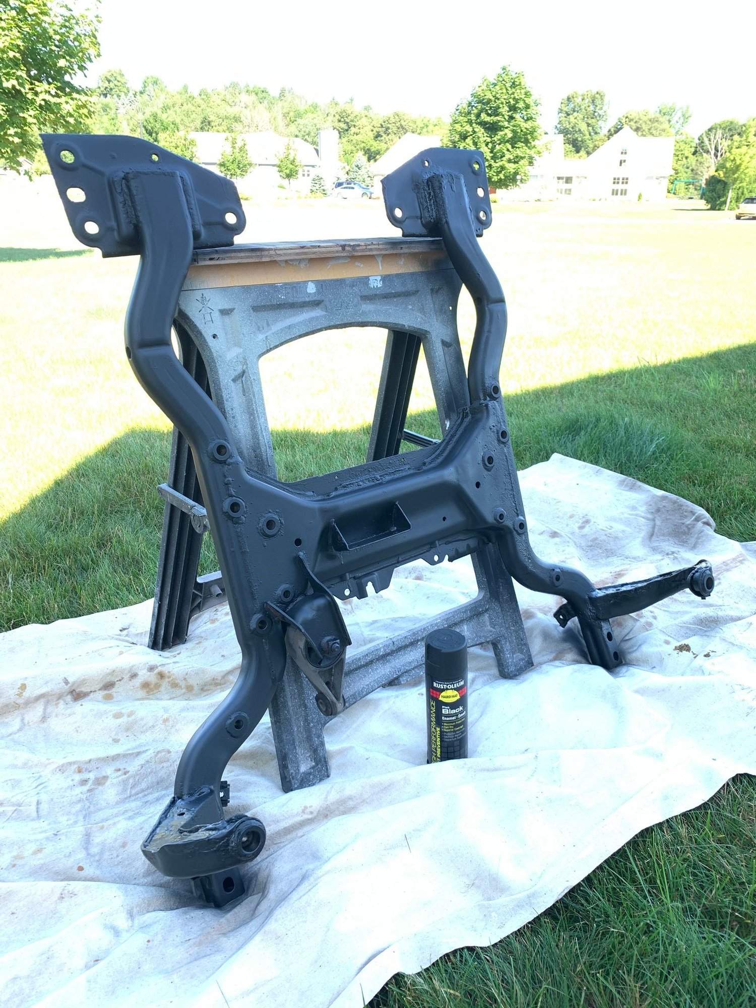

After disassembling everything, I cleaned off the oil and grease with a solvent and pressure washer, hit the rust with a wire wheel brush and knocked off the ugliness, hit the remaining areas with rust converter, and then hit it with a coat of Rustoleum from a rattle can. Starting to look better.
Then I put on all the new control arms and bushings and put the steering rack back on.
After seeing a couple of drips, I thought the hoses were looking a little worse for wear so I decided I should probably order new hoses. Could have been just a drip from the uncapped pump or hose, but it was cheap to replace. So another order in to FCP.

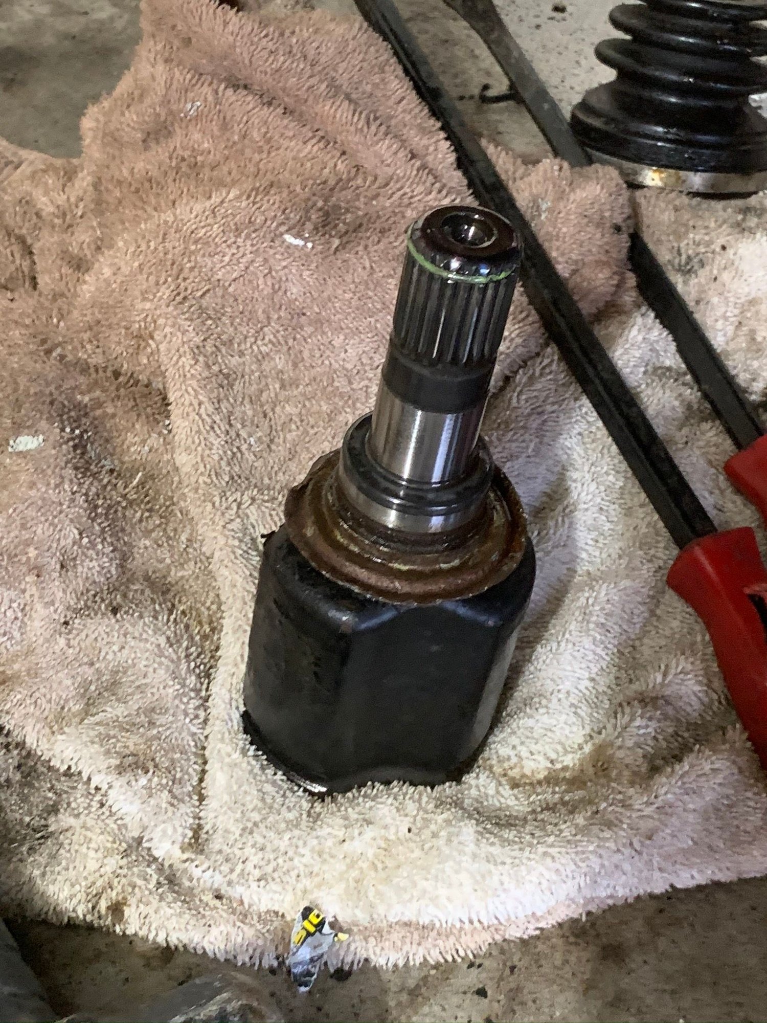

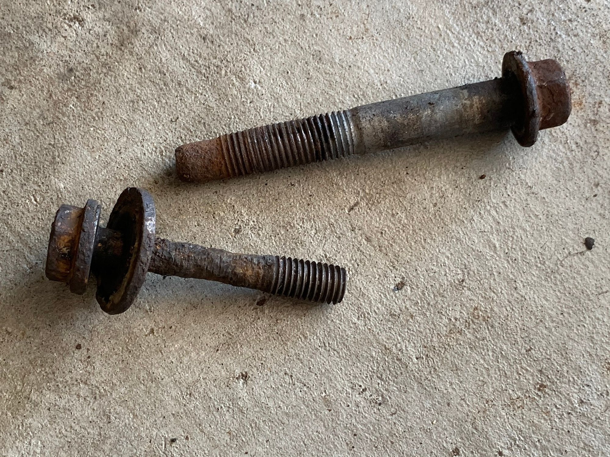

Took the axles out, but the driver side was stuck and wasn’t interested in coming out no matter how hard I pried on it. I ended up wrecking the dust shield and said there has to be a better way to get it out. So I found a guy on YouTube who built a tool I emulated for removing stubborn axles. Worked like a charm for a couple of bucks in a set of vice grips and a threaded rod along with a busted sledge hammer I had.

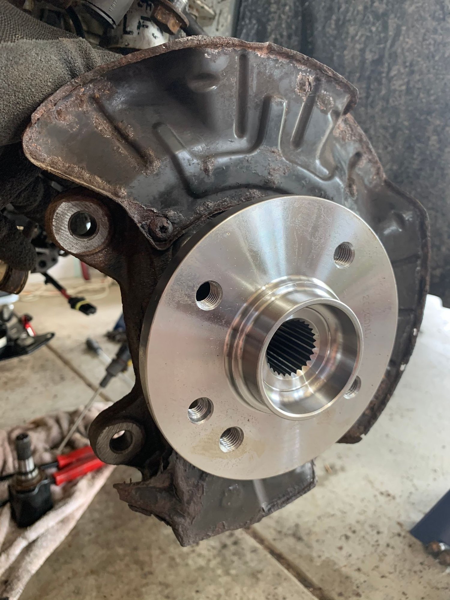

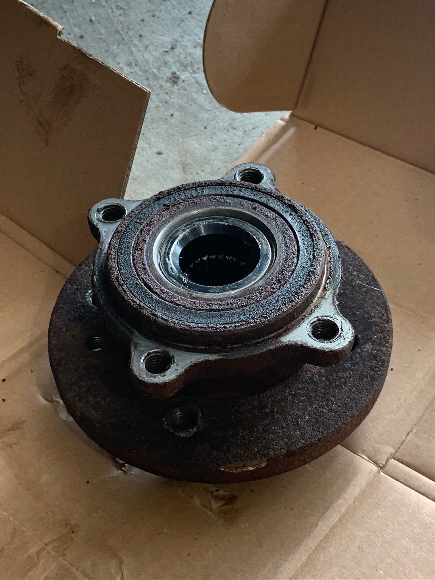

Worked on the hubs next. Had to soak them good with PB Blaster and whack them good with a 4 lb. hammer to break them loose. Ditto with the ball joints on the spindle. Cleaned them up and got those installed. Then I torqued down what I could at the time.

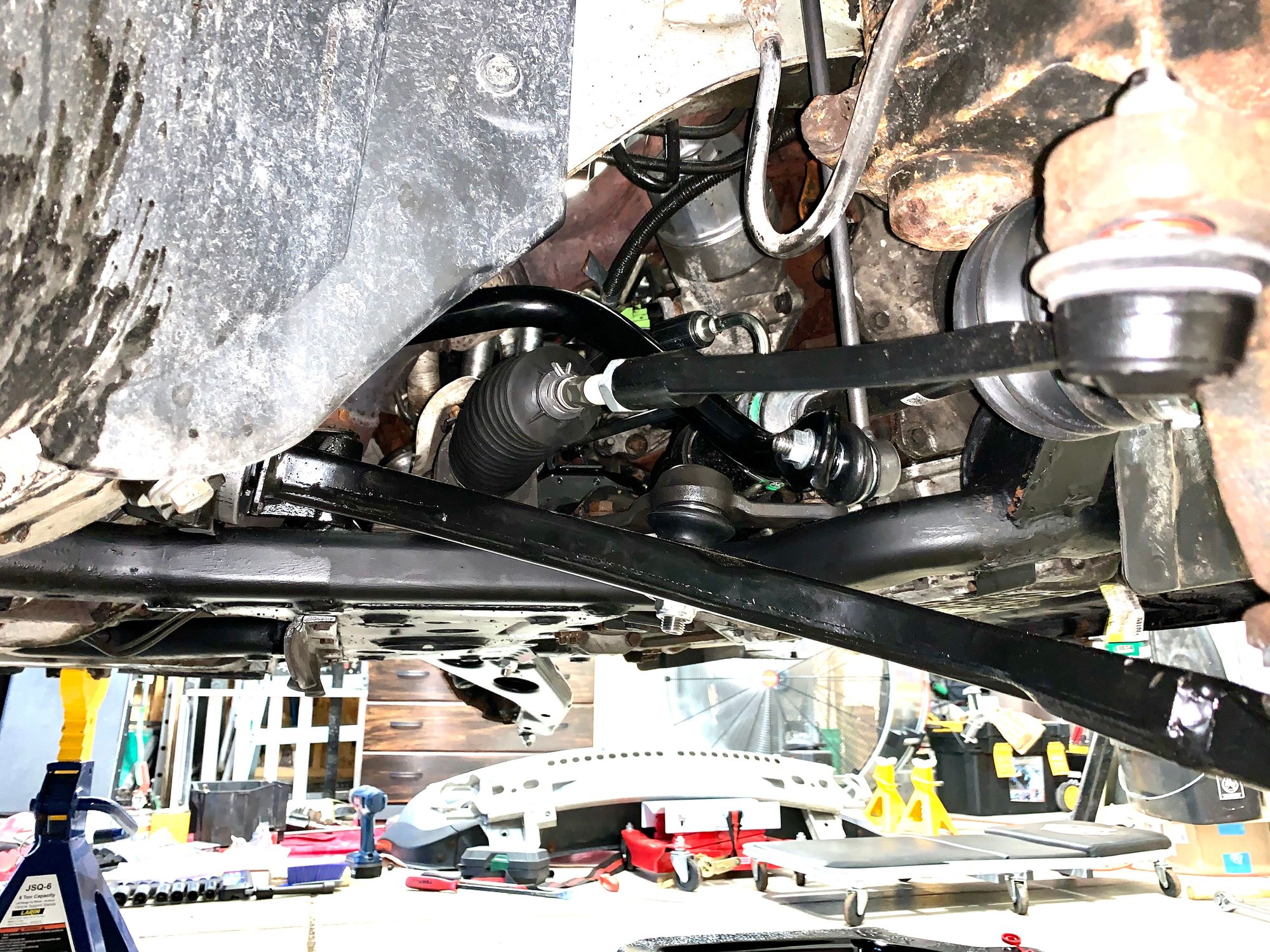

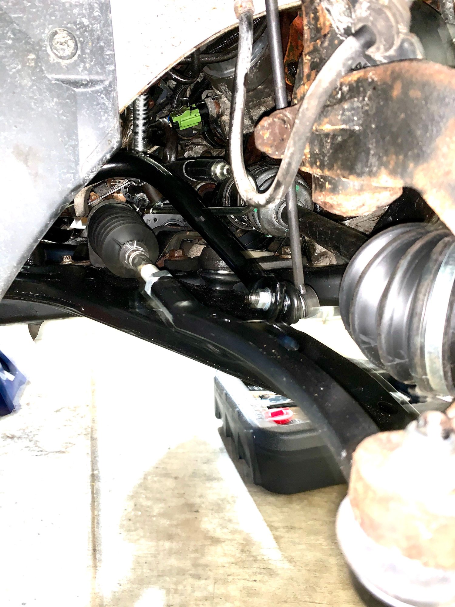

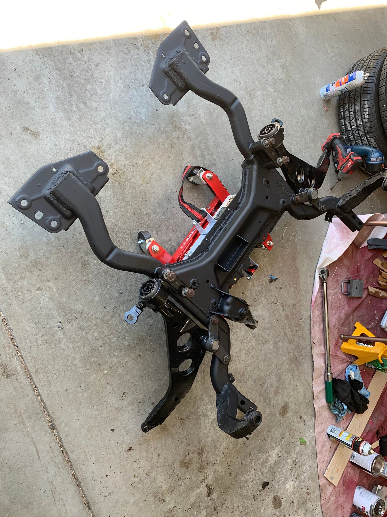

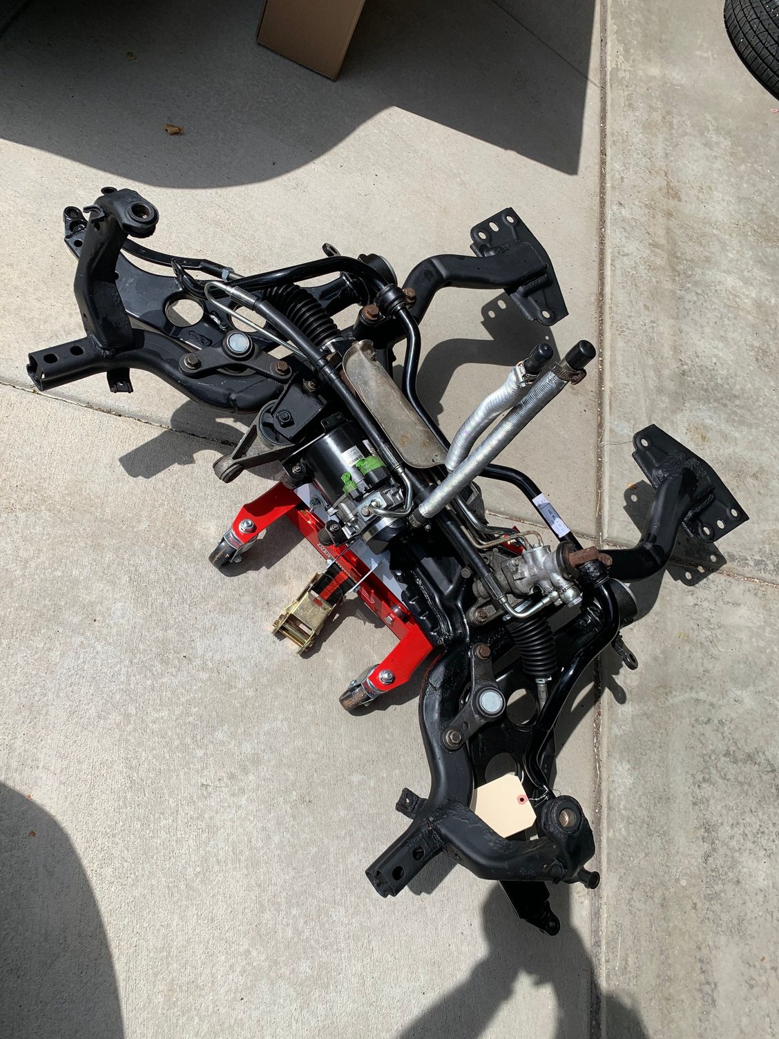

Got all the parts on. Control arms, new hoses, sway bar, bushings, steering arms, and mounting bolts. Ready to put it back on the car. Going to hold off for a bit, though, because I received “S” axles, but they’re .050” too big for a non-“S”. So going to have to do an exchange from the parts provider.

Thanks! It was an interesting problem to resolve. The paint is pretty much how you see it there. Just some spray on bed liner taped off to complement the sharp lines/blocks of the existing paint and trim. I have some vinyl rally stripes I plan to add to the car once I get it back together and on wheels.

You did a great job fixing that rust under the tail light !
Thanks! it’s a 20-foot repair for sure. Looks great from 20 feet away! But it closes the hole, and that’s the important part.

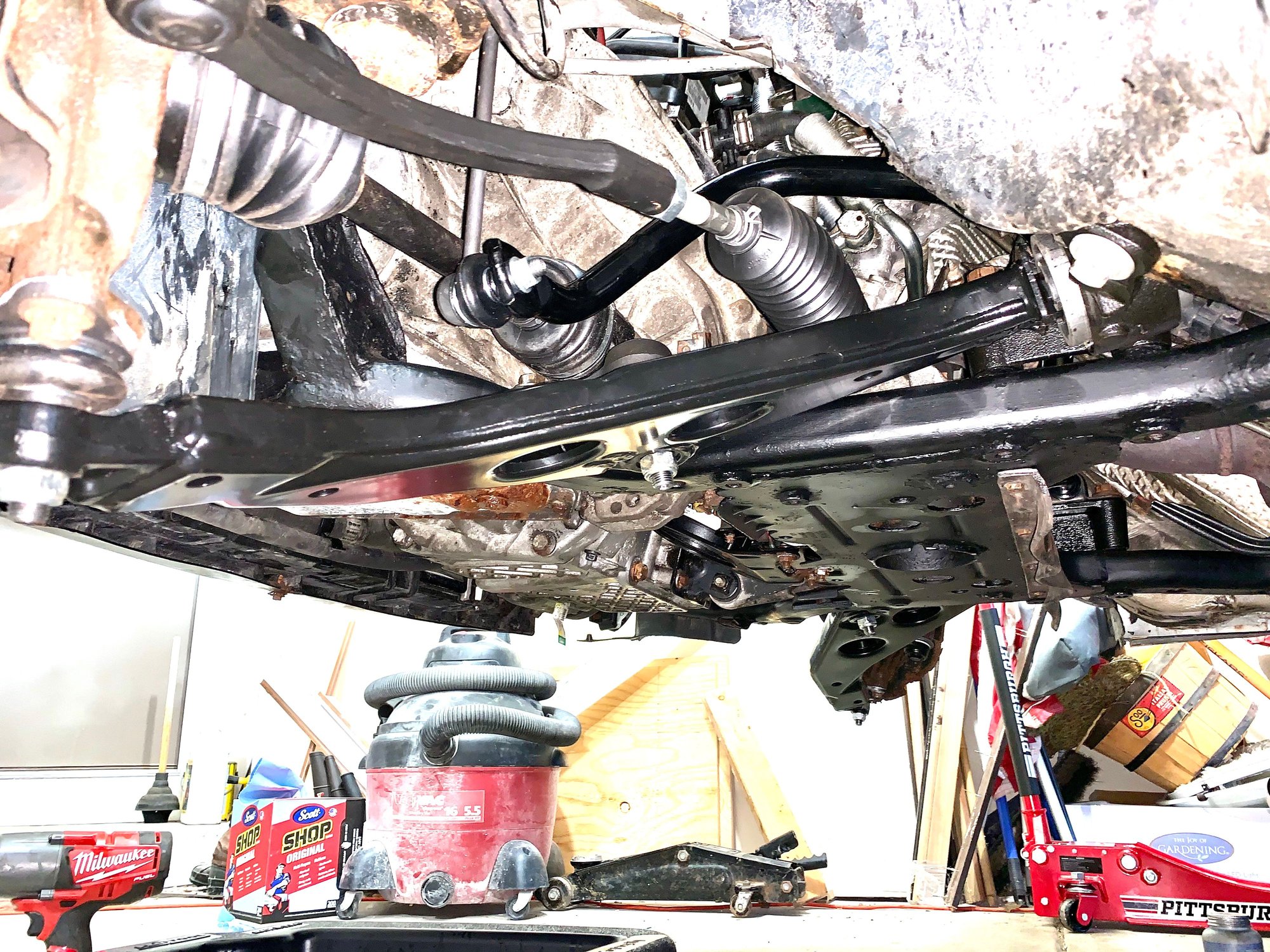

Got everything back together and test ran the systems while on jacks. Everything appears to be in order so far. No leaks that I can see. Changed the CVT fluid which looks like it was quite old. Going to put the front back on in the morning and go for a drive. Progress!

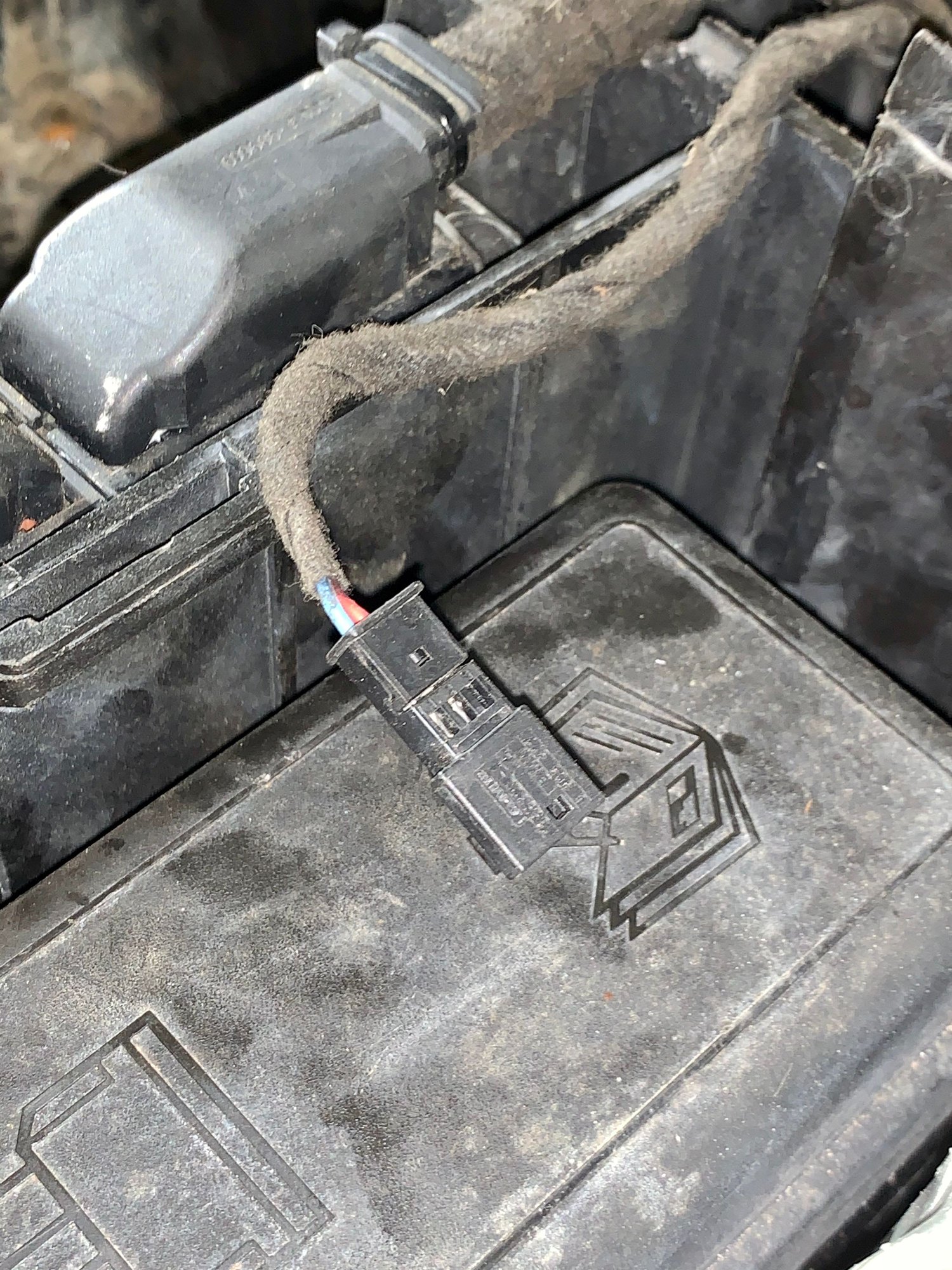

Any idea what this plug is? It was bundled with the aft ECU cable but I didn’t see a place where it may have connected. I do have an airbag light on the dash. Is there an impact sensor up there somewhere by the fuse box? I’d have expected that to be closer to the bumper.

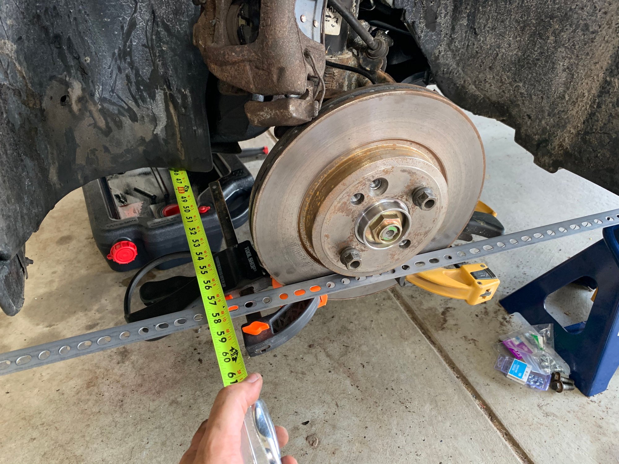

Amateur alignment to get it straight enough to drive to the alignment shop. I actually did a pretty good job, but we’ll see how far off it really was when I get the shop report back this afternoon. Photo not indicative of how the actual process went. There was more swearing involved and further out the lever arm. I hate cheap tape measures.

Just came back from the alignment shop and all went well. They said it was an easy job. Probably because I put all new parts up front.
Rear wouldn’t stay in adjustment, but it’s just barely on the ragged edge. I’ll tend to the back of the car another day. An expen$ive oil change and she’s good to go.
