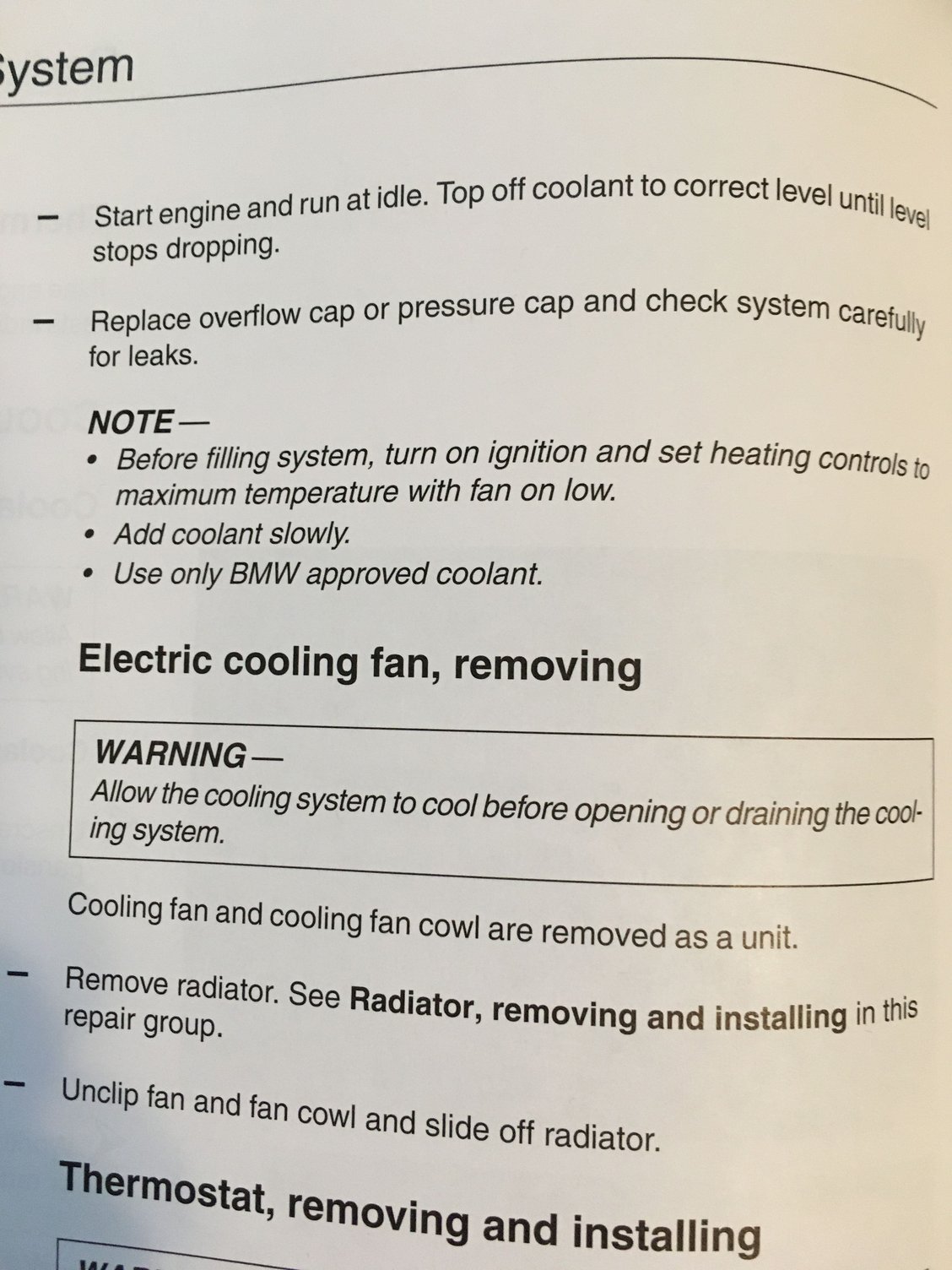

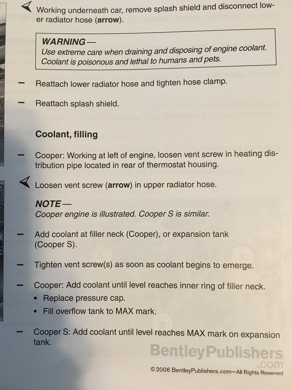

What procedure did u use to bleed?
there are two bleed screws...
Sounds like air in system to my basic understanding
Old Jul 12, 2020 | 08:13 AM

I know it does as I feel the same way. Here are the procedures I've used:
Cap off and bleed screws open, I fill the system and let the engine run with heat on high(fan low). Once I see coolant coming out of of the bleeders, I close and repeat once engine comes up to temp.
once u have fluid only from lower screw, close and keep closed.
focus on top bleed screw...until just water is coming from there, close and keep closed.
focus on fill tank, keep filling as it goes down...check for a few days as you drive it
that worked for me. Attached the Bentley notes

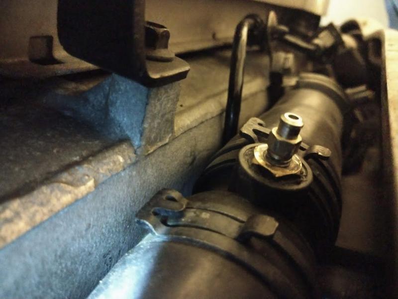

It really grinds my gears how zee Germans are always associated with "precision engineering" yet manage to screw up the simplest of things.
BMW coolant systems are notoriously crap but they haven't got the hint and continue with their poorly designed systems.
My Swedish engineered Saab was vastly superior to this German Scheisse.
When I first used the bleed screw on my R53 I both LOL'd and cried because it's such a painfully lousy design,
geez, talk about low effort. Splatters out everywhere and is just stupid.
I ended up modifying mine to have a proper bleeder and it makes life much easier.
Their choice of supplier is also laughable, from low quality castings from eastern Europe to just about everything else - factory coolant cap is another shiddy design and even brand new can be inoperative as GTT shows here and what I've personally experienced as well.
http://www.gtt.uk.com/gtts-cool-guid...ooling-system/
I ran a Volvo cap for a while which is a much better design but it's rated around 21 psi and I got paranoid about overpressurizing the system.
Worked well though as far as doing the job and never had any overflow splatter on my coolant tank.

Speedwell - if you attach a vertical clear plastic tube to your modified bleeder, would it make any difference?

​​​​​​Interesting modifications and I like it. Does the Volvo cap fit directly to the tank? I don't know that I want to go this route as I know that the system does function as it should. I Doo 300 miles a day, Baltimore/DC traffic and open roads, both of my Gen 1s have held up until now. The parts that I have replaced in the past was not because of part failure as much as it was something else that caused it or replacing out if precaution. With that said, I do get what you're saying with the quality and the cooling systems in general when it comes to BMW.
