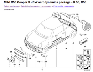

It's there on REALOEM,
but it's a mess.
Don't know why they have to make it so damn difficult to find all the little trimmy bits and such stuff.

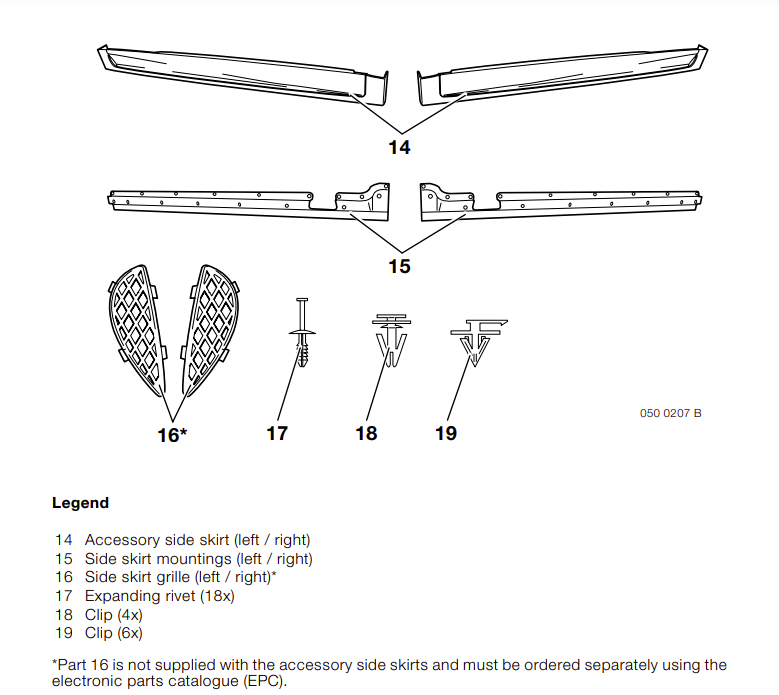

That said,
here's the aerokit install pdf:
https://www.motoringfile.com/howto/A...%20Bodykit.PDF
I cannot find a newer version, that one is from late 2001,
according to it, all you need are these:
But of course they do not give the part numbers because let's make everything as muddy as possible.
These are them tho:
#17 - 51118174185
#18 - 07131480419
#19 - 07137073915
Those type of fasteners are cheaply available by the big bag from Chinatown of course, easy to find, and the OE parts are likely sourced from there too I'd wildly guess altho the quality control may be upped a notch, but I don't really know.
