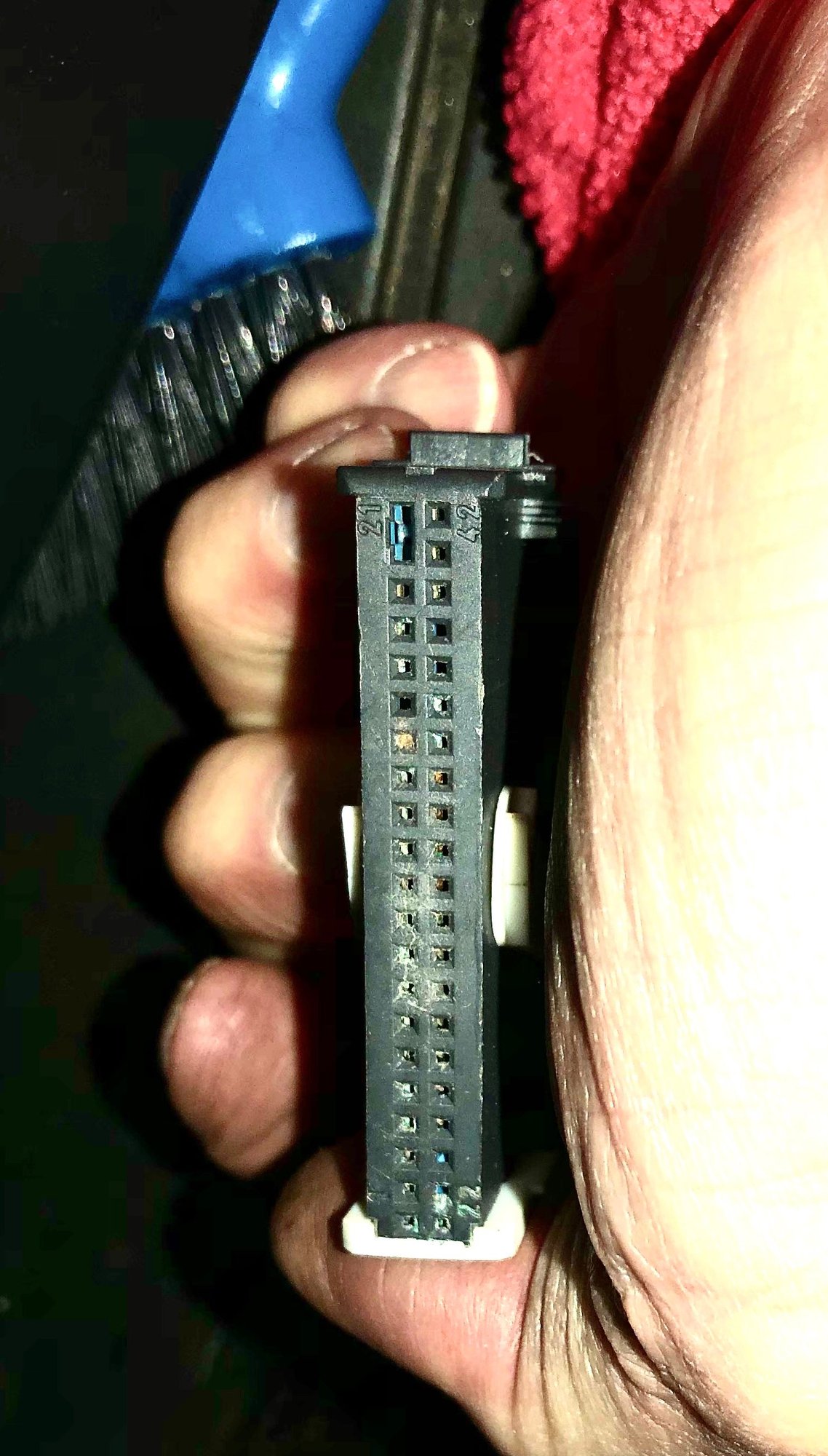

That’s the one
Thanks for the responses. New information that I hadn’t seen before.
The connector pictured is the one I’m working on. I haven’t yet figured out how to remove the bottom (male) portion for better access. I found a diagram in my Bentley manual, although it’s in code. I’ve gotten that connector apart and cleaned it. Fixed some things and maybe broke some others. Hoping I didn’t fry my BCM during the futzing. Long story.
That trim panel must be more flexible than I’m giving it credit for.
here’s a picture of my female connector. You can see the broken pin. So something doesn’t work. I think it may be the OFB connector, but I haven’t verified that yet.
Any useful contact cleaning tips?
