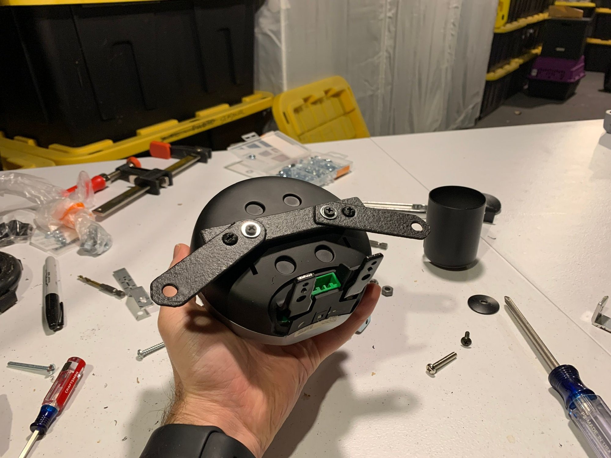

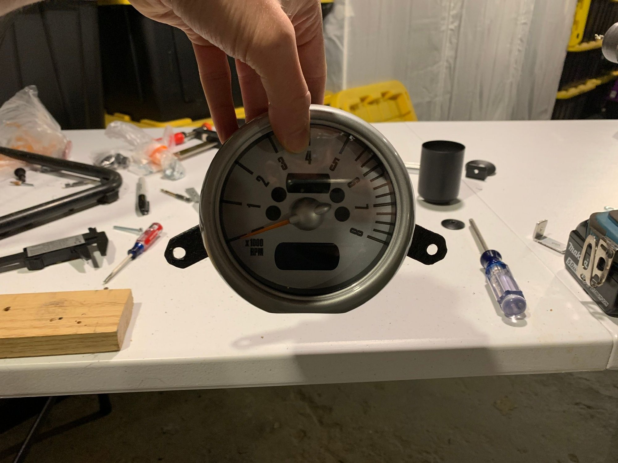

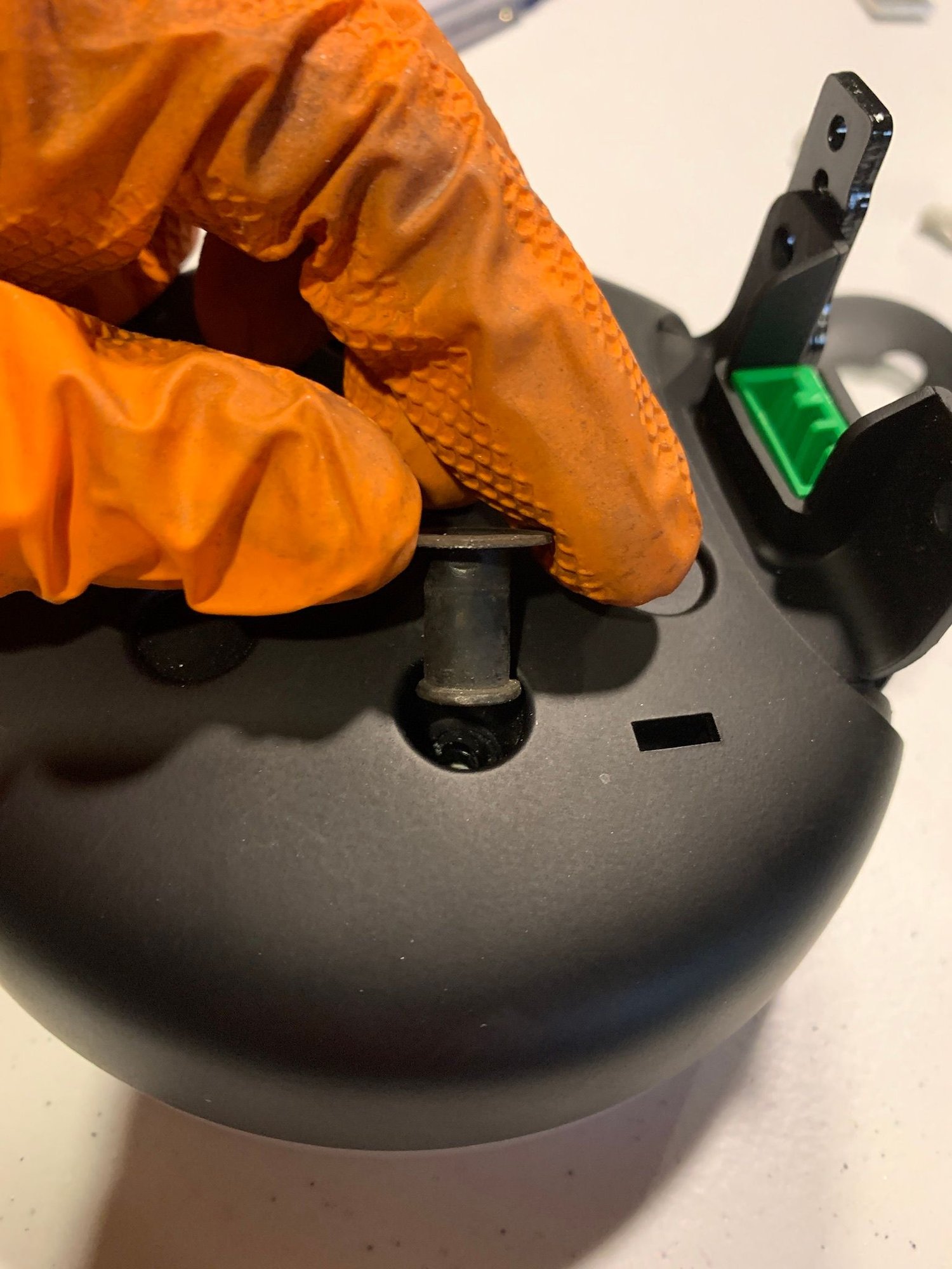

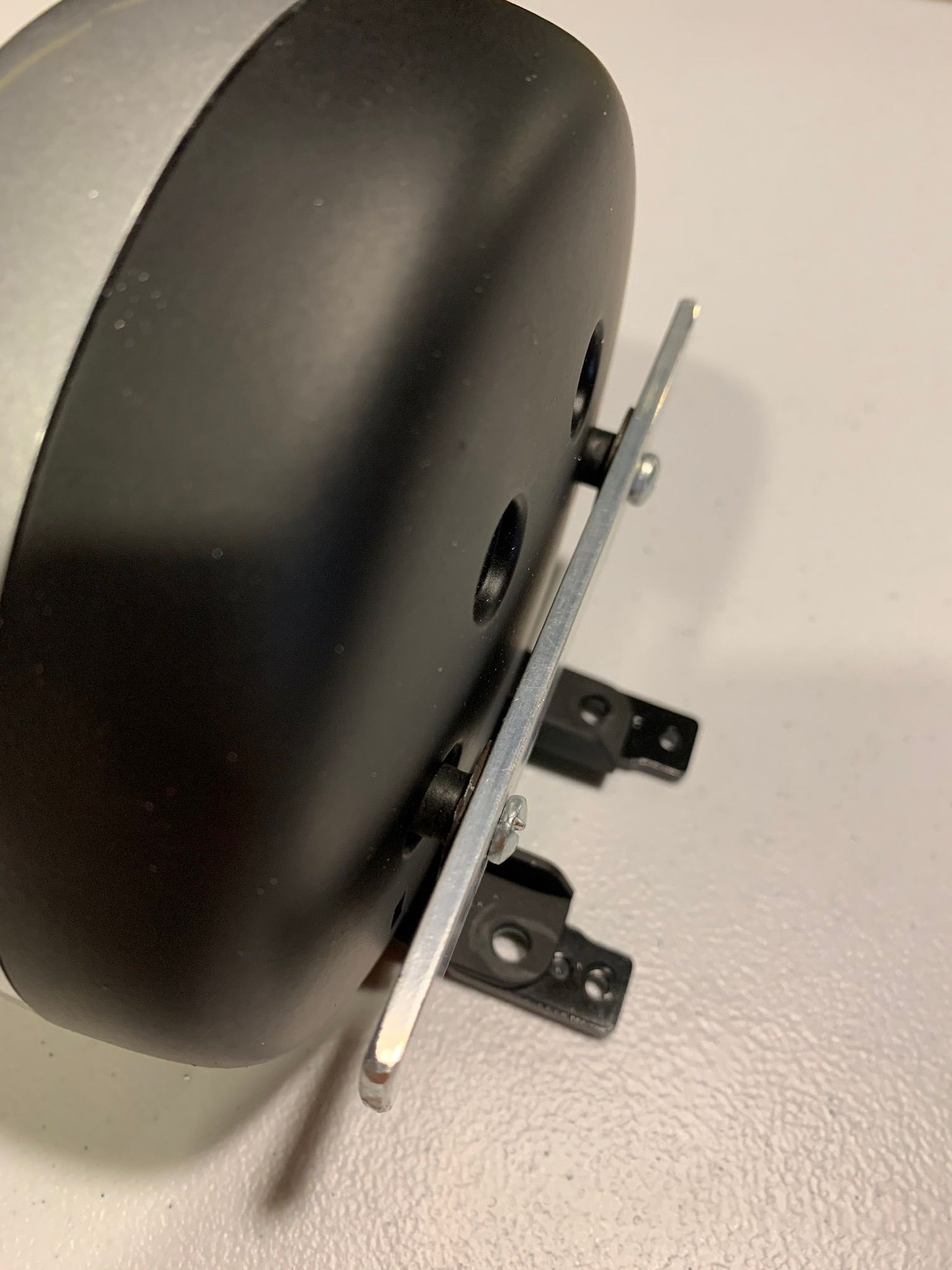

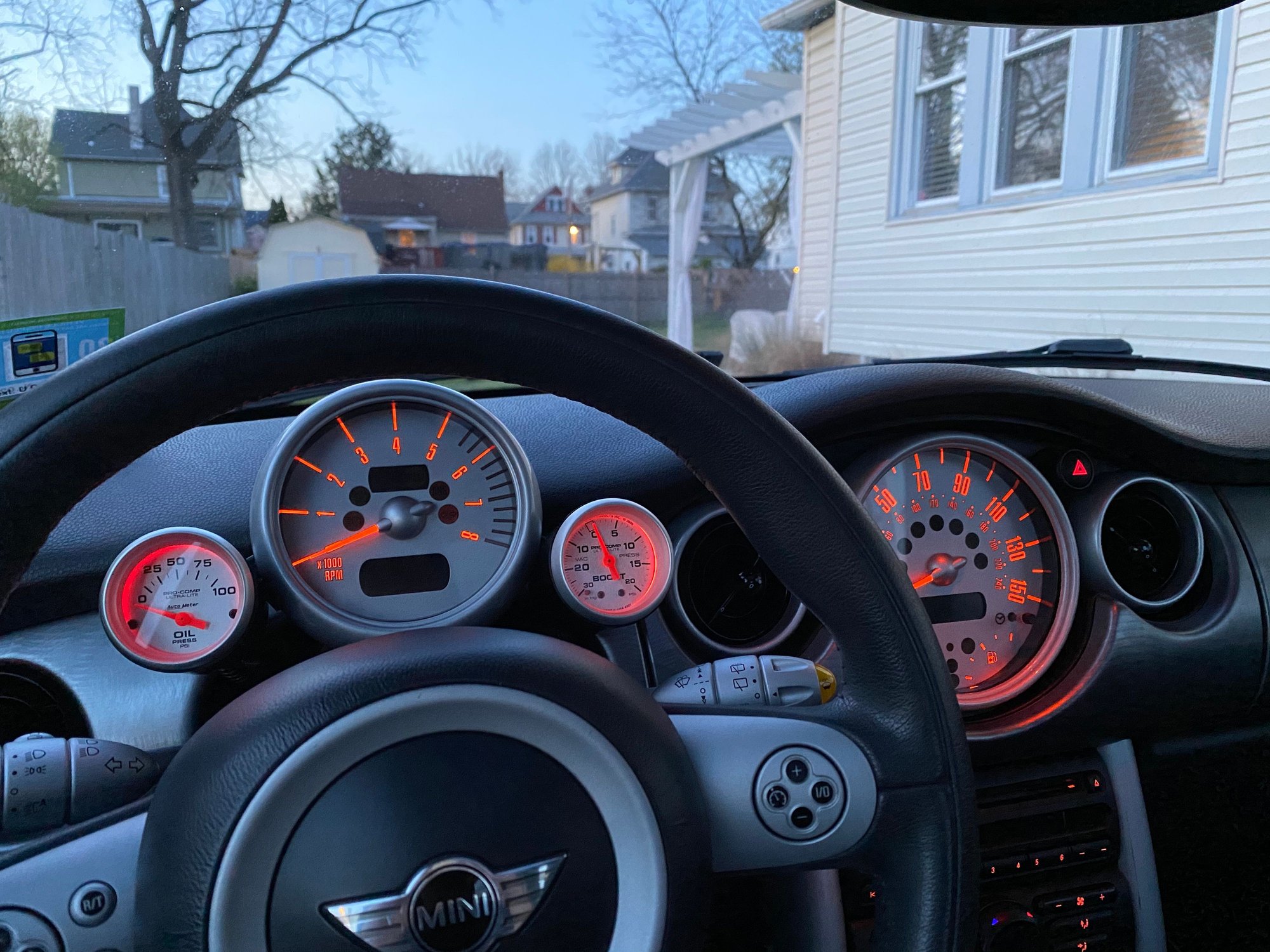

Related: Someone else probably thought of this before I did.. but if you have a bit of aluminum flat bar and few used gen1 valve cover bolts laying around like I now do, you can use the collars as an absolutely perfect sleeve spacer for a DIY dual gauge pod bracket. Couldn’t have bought anything better than those old collars.

Clever idea...
