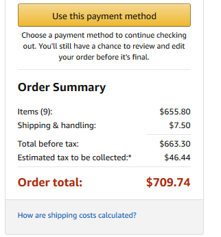

OK peoples, here is what I have it narrowed down to; Amazon;
I have 5 hours of price comparison invested and Amazon is the most competitive.
Am I missing anything?

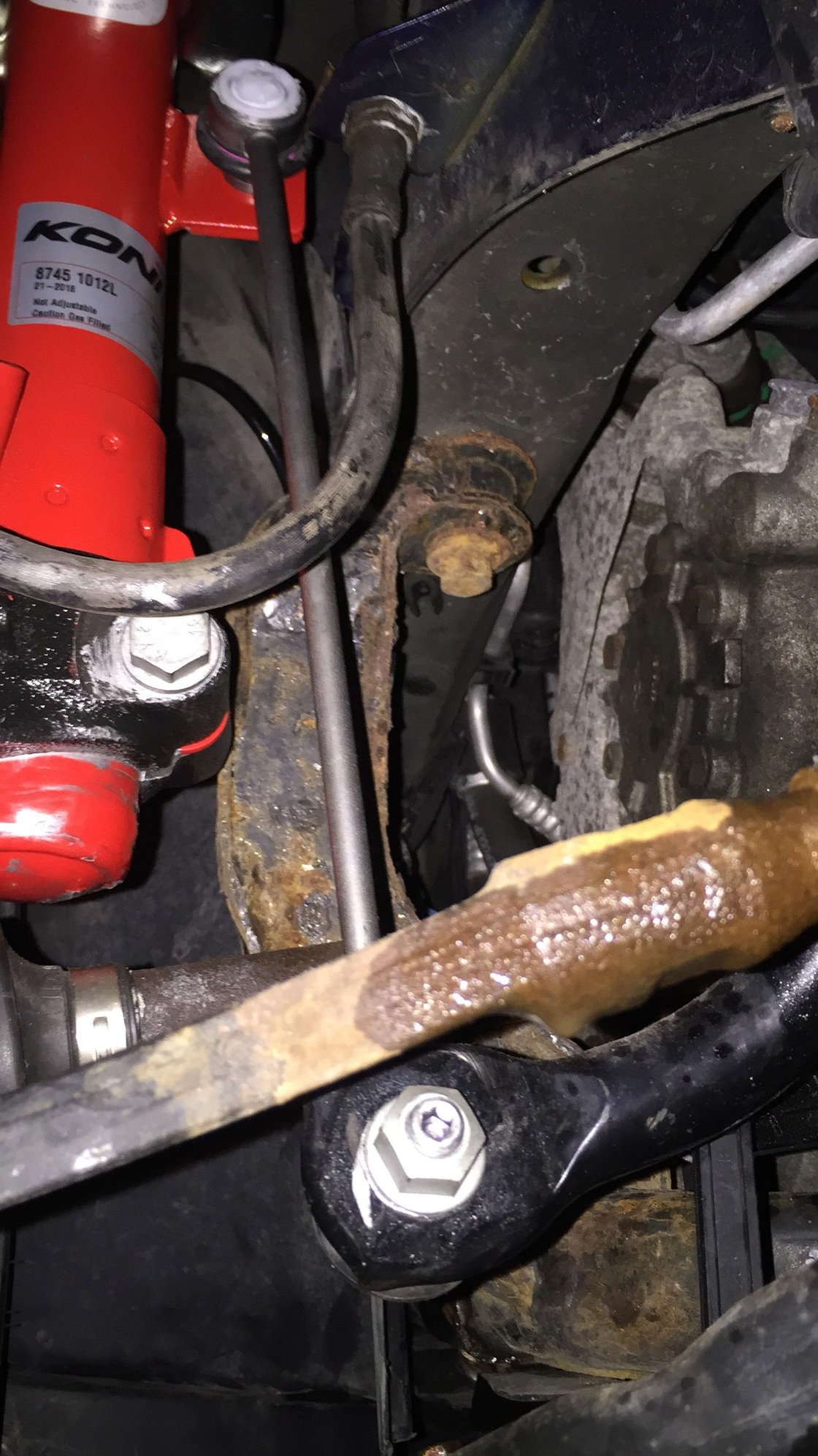

First off thanks for all the advice from you folks. Ran into minor issues with installing the drivers side strut. First off the pinch bolt was hopelessly rusted into place and could not be removed unless I paid $200.00 just to remove it and have it drilled out on a bench. Second the ABS sensor was also permanently adhered to the wheel carrier also. Ordered a new wheel carrier from MINI Mania for $189.00 and an ABS sensor and lower outer ball joint plus new sway bar links from ECS Tuning. Other than that, the installation was one of the easiest and simplistic maintenance jobs I have ever performed on my MINI. All bolts and hardware were easily removed and reused except for new mounts front and rear. Being that this car has spent it's entire life in upstate New York, all my trips to the car wash washing off the road salt after the snowstorms paid off. Both wheel bearings and ball joints were in perfect condition. The Koni FDS struts and shocks are performing way beyond my expectations and I'm so glad that you folks recommended them. My timing was perfect with the economy slowdown and the prices dropped significantly from the prices I posted in the earlier replies on this thread. Between all the parts and the alignment, I believe I have less than $950.00 invested. I was quoted around $750.00 to have them installed and aligned so I saved a lot of money by doing the job myself and had all the tools and a heated garage for comfort. Overall I feel that after 15 years the original equipment worked very well and hopefully I will get many, many years out of these new parts.
Struts with new end link

Nice work..Good choice. Thanks for the update.
Those FSD/Specials are one heck of a good package.
Stock ride height does not sacrifice handling or safety (or bent wheels ) on the street compared to any 'lowering' spring that takes away useable suspension travel.
An uprated rear swaybar would be the only thing that I would consider if you find a decent deal on it.
