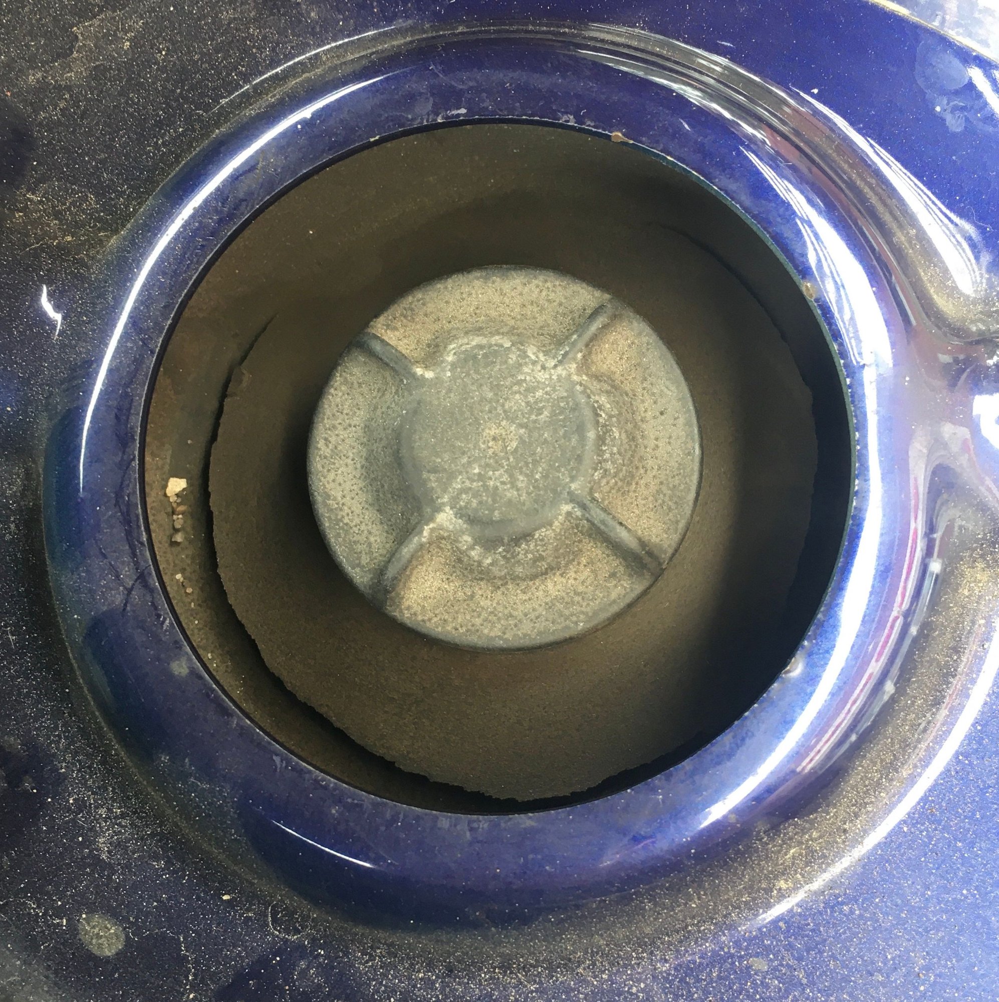

Cracked mount
I’m going to do both shocks when I get home as long as the mount on passenger side holds up ,I don’t understand what is between the crack and strut what is holding it in place will the strut poke through if it cracks all the way around ?

I recently put Bilstein struts on my duaghters R52S, so I'm trying to recall how everything fit back together.
If I recall correctly: No, if the mount cracks all the way around the strut will not poke through. There is a shoulder on the strut below the threads, and the upper spring perch (Part 7 in the diagram below) rests on that. So, if that mount cracked through, the spring perch would bang away on the bottom of the upper strut mount (it would probably make a heck of a racket and your handling/steering would be less than ideal - to say the least).
Buy by your picture - yeah, it's definitely time to replace those upper stut mounts, too. I replaced the upper perch and the rubber spring seats, top & bottom, too. Next Spring I'll put new Bilstein shocks on the rear, as well.
