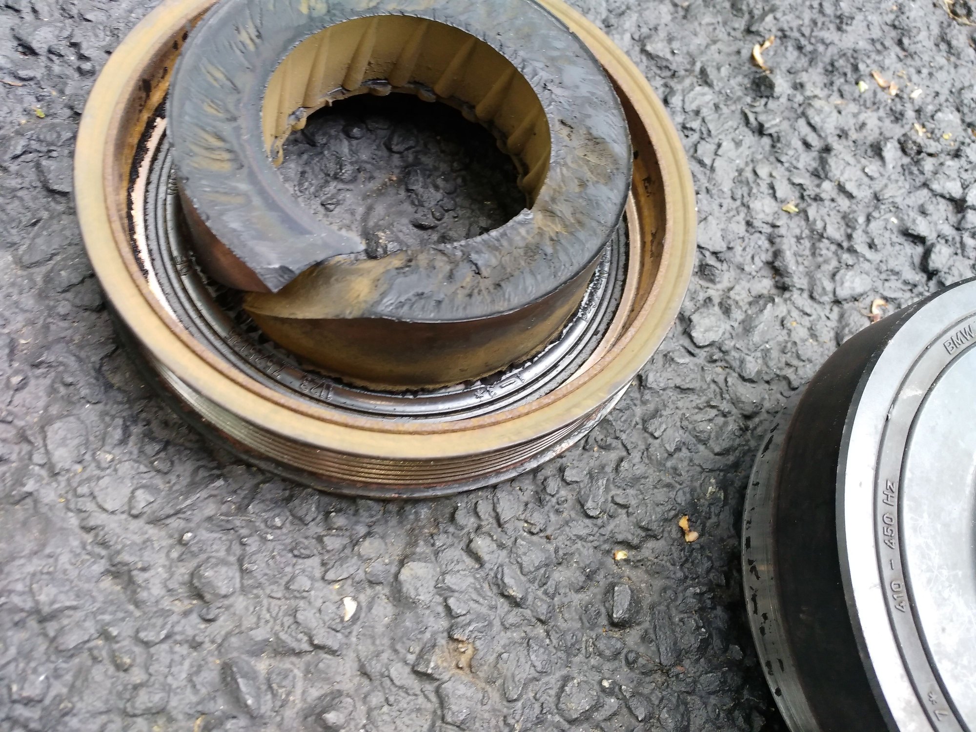

It could be your crank pulley starting to separate. Before mine went, it was rubbing on the block and making a grinding noise. I had no idea what it was at the time. When it finally came off, it took out the boot on the passenger side drive shaft. Luckily it happened at low speed. Could have been much worse.

Not saying this is the issue, but also check the balancer pulley. Mine came apart but I could not see it, just hear it. I finally saw it when I focused on it. Car would start and run but made a racket. Lots of crazy lights on the dash too!

Regardless, on another note replace the crank pulley - preferably with a PRW or ATI - anyway; these things can go anytime leaving you stranded and are a major weak point in these cars. Mine died at 55K with normal driving (no track days).

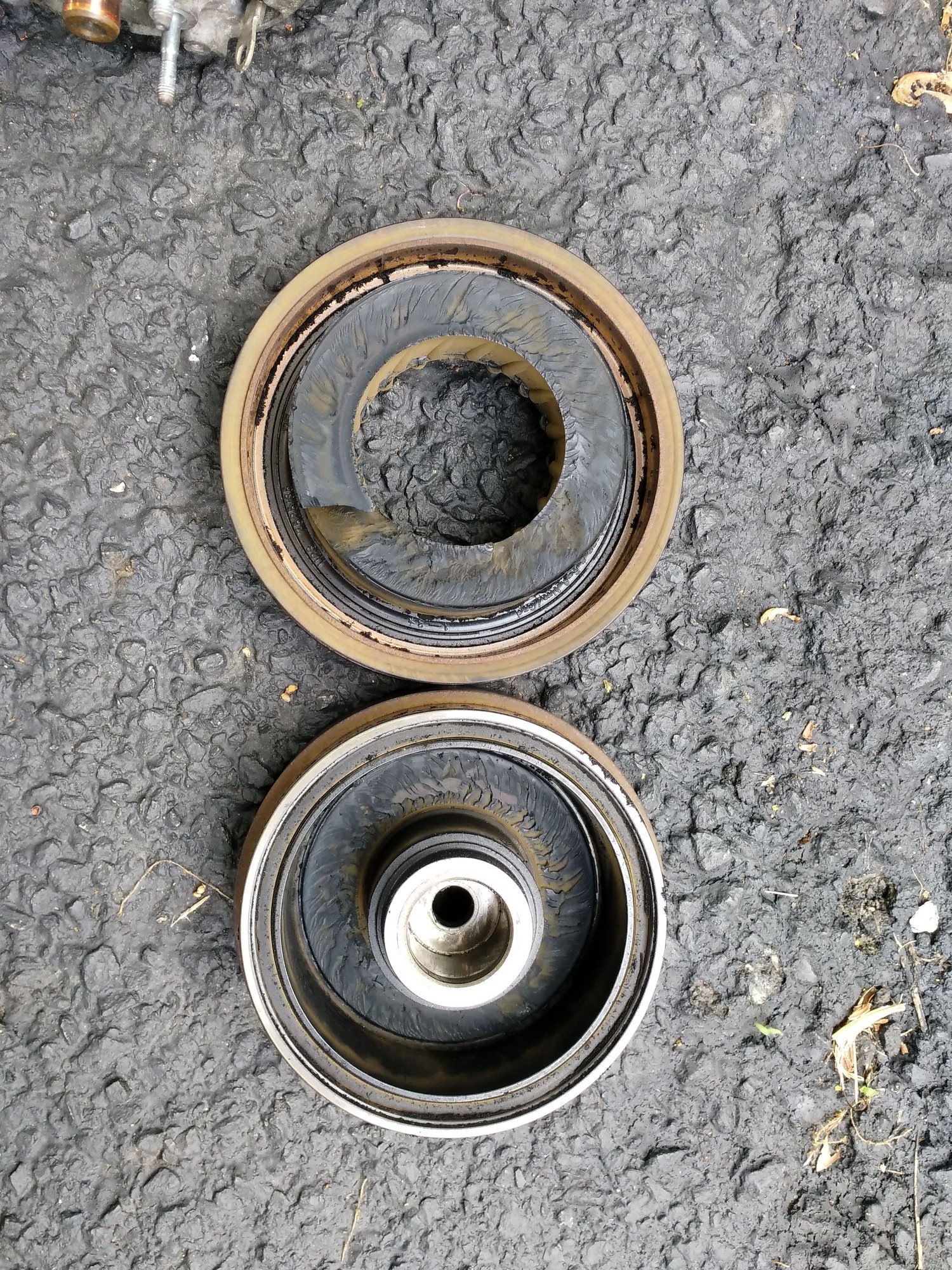

My crank as it was failing had the same noise . I'm too replacing mine as we speak. It would explain your power loss . Also you may be losing power with that 17% pulley from heat soak . I've read alot about some cars loving and some hating the 17% pulley .
do you have an intake and exhaust ? If not I would not be running a 17% pulley .

also with my crank being bad the noise was much worse at idle and I could hear it clearly for a second as I shut off the engine . Lol here's my pulley ..I'm going to go try and pull it off now. Wish me luck!
