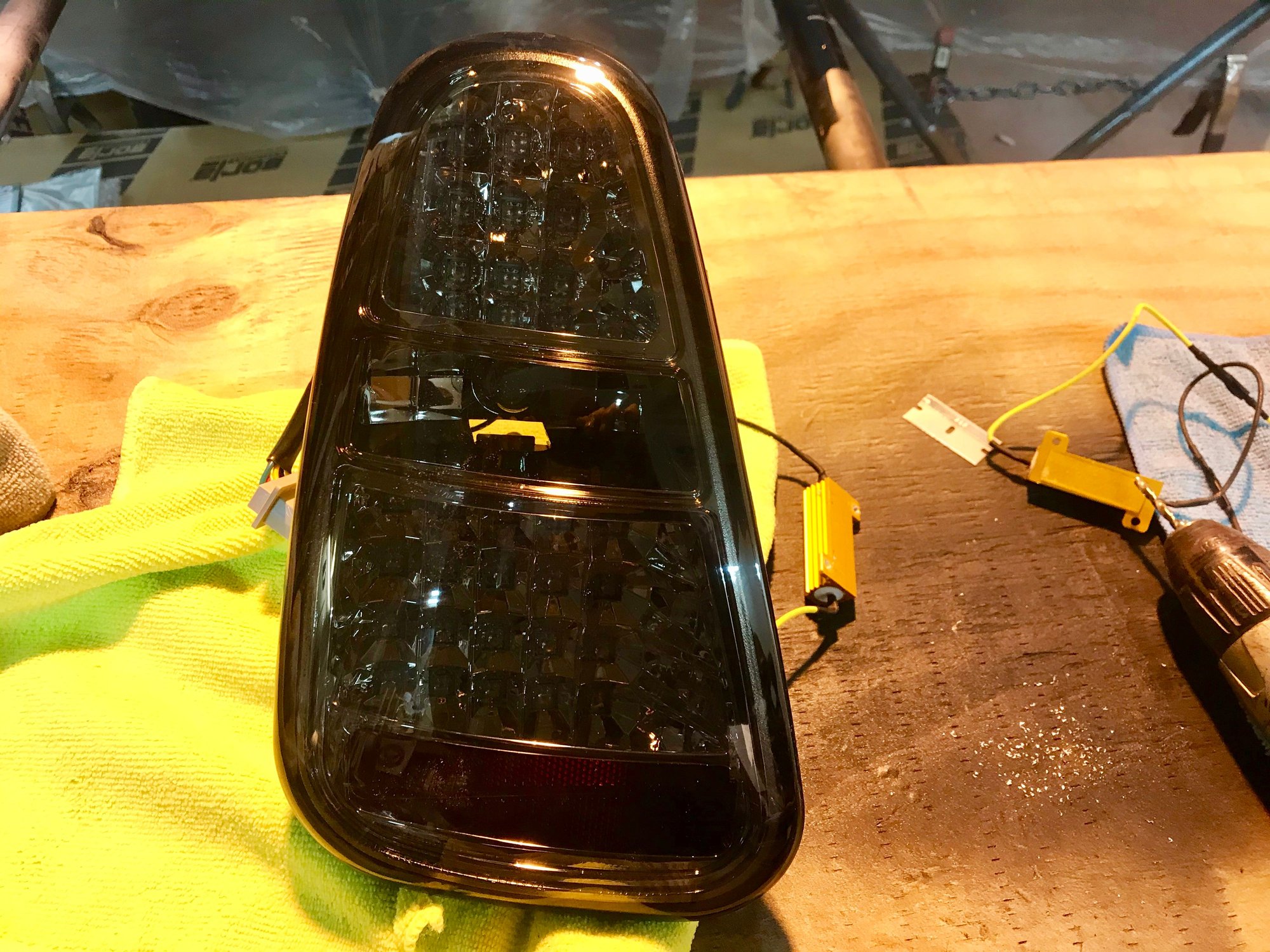

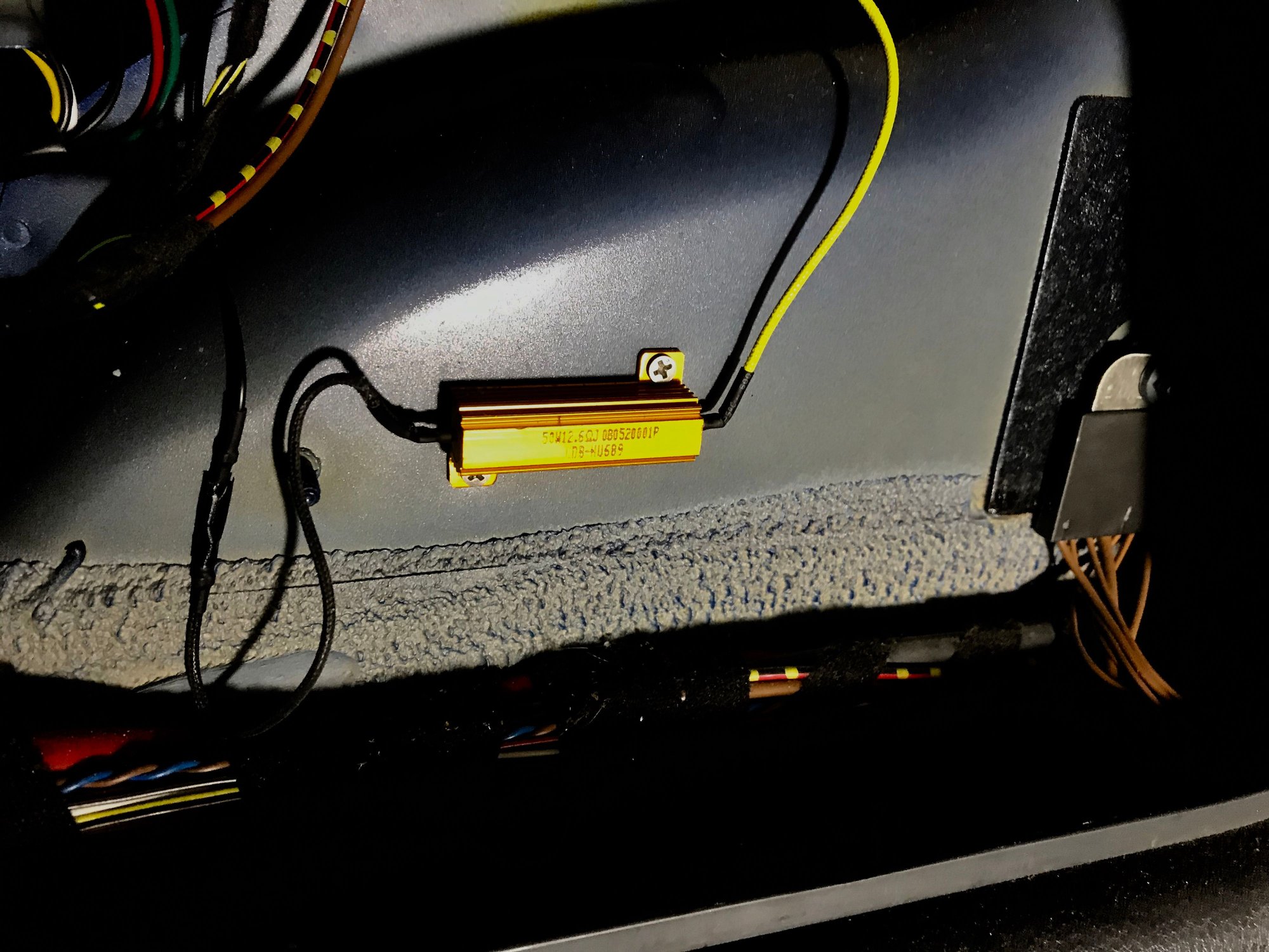

I installed LED taillights with the included resister. The resister came with double edge tape for mounting which is not a good idea. They can get pretty hot so I drilled the mounting hole out a little and screwed them to the inner fender for better heat dissipation.

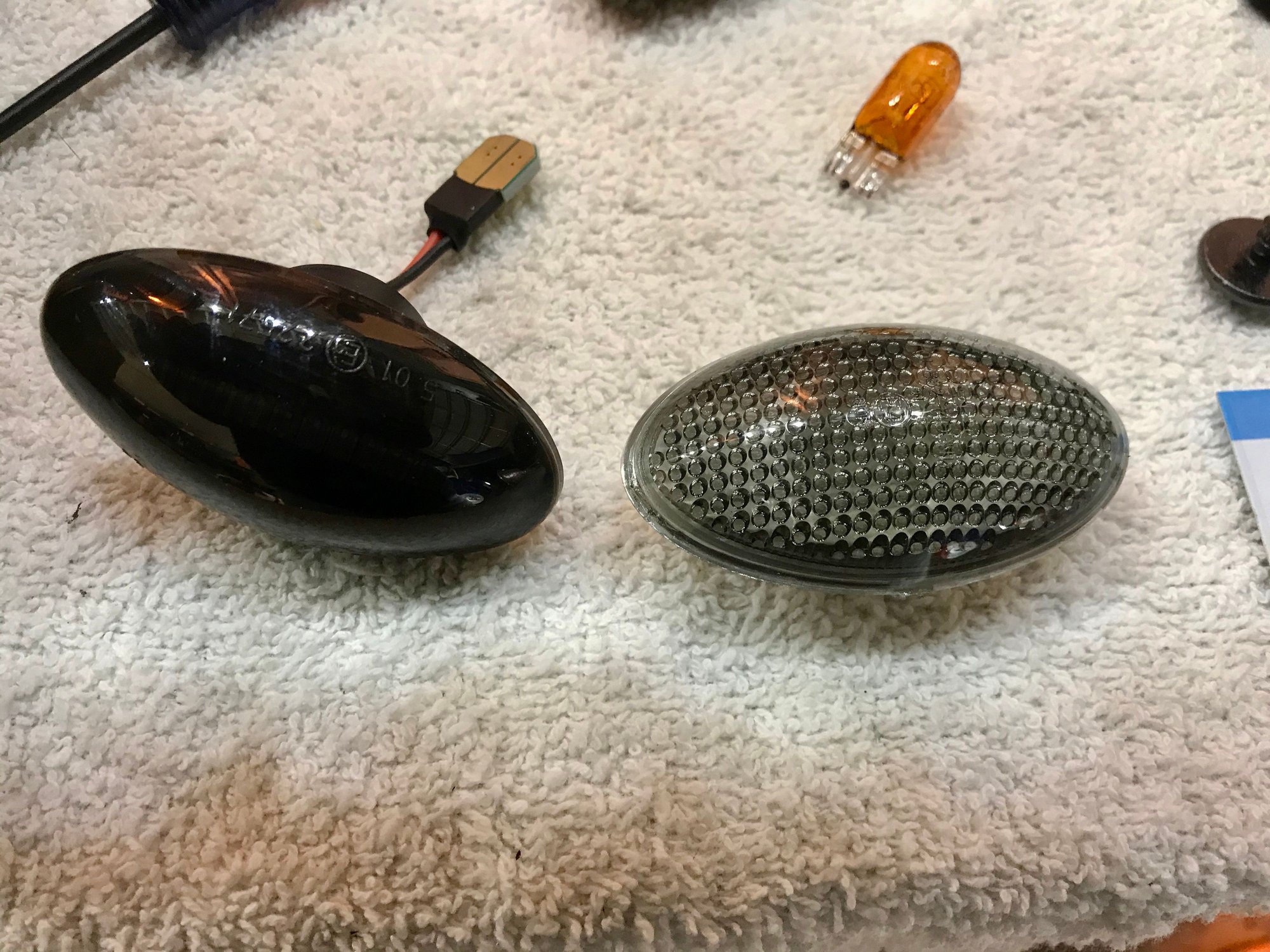

I had originally bought a blacked out LED side marker lamp,[top of fender where the "S" is, supposed to blink with the signals] but got Hyper-flash, as that did not have a resister. I didn't see a really neat way or place to install a resister on them and ditched them, [free to whoever responds first then send a padded envelope with postage. P.M me]
I got some side marker lenses [ at the top of the fender where the "S" is located] that I liked well enough and decided to just go with the incandescent bulbs. I "thought" when I switched out the LED side markers for the incandescent [about 2 months ago] , the Hyper-Flash went away. [The front lights are incandescent.]

Any thoughts as to why I would get Hyper-flash with only the taillights being LED but having a resister?

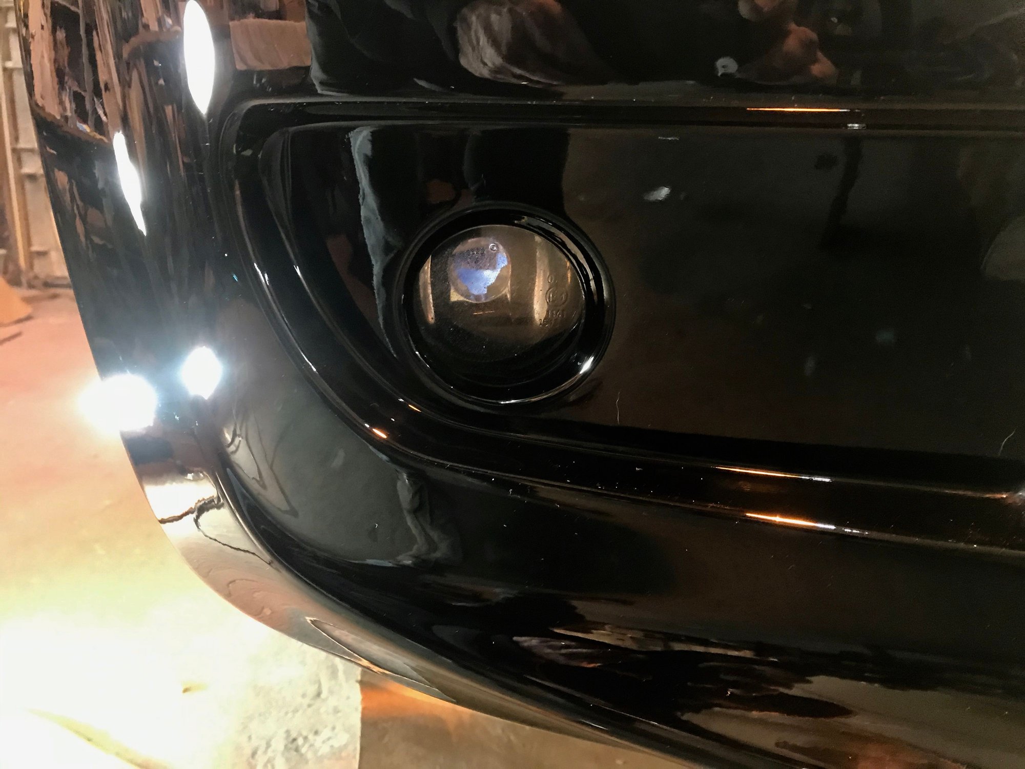

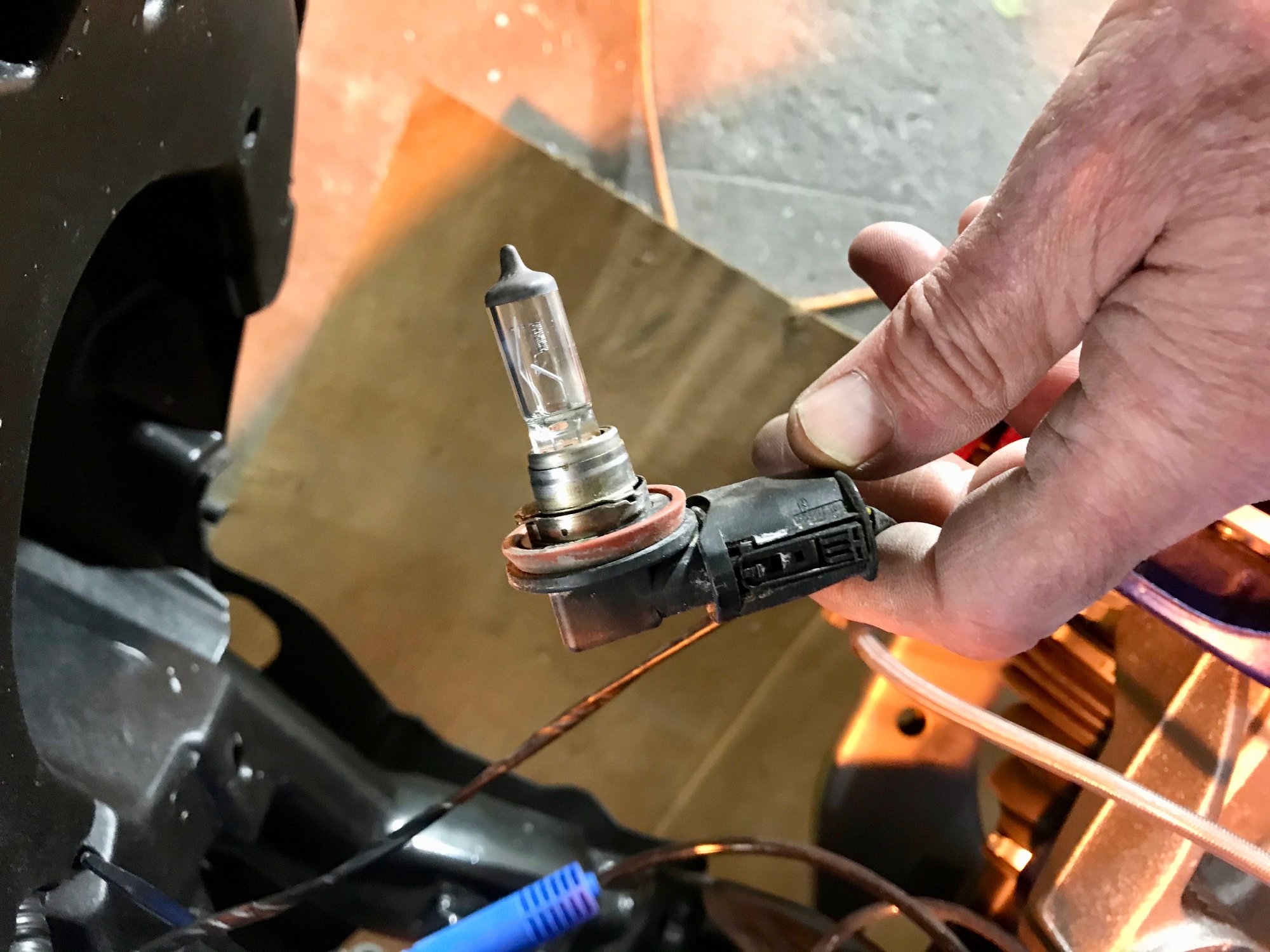

#2 When do the lower front lamps come on? Unless both of mine are burnt out, [and they don't look to be] no matter what I do they don't light. Before I start a lot of trouble shooting, when are they supposed to come on and what switches them?

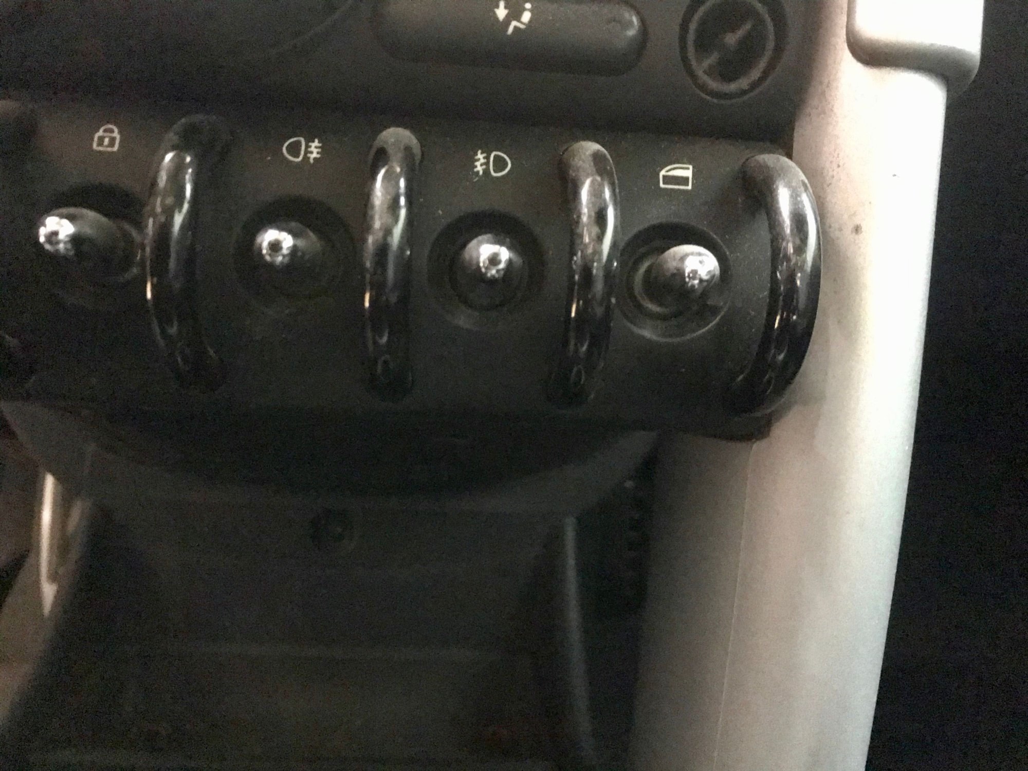

#3 What do the 2 switches with "light symbols" in the lower center of the dash do ? They seem to be momentary switches, but I don't see what they do.
The owners manual, [Ebay] isn't very clear.

The toggle next to the window switch should light the front fogs (lower front) when the parking lights or low beams are on. The toggle to the left of that switch is for the red rear fog. Front toggle should be amber when on and the rear green.
Sometimes people add a full switch bank with the rear fog toggle without the rear fog. If you have an ‘05 or later it’s the red light above the exhaust tips where the backup light was on the earlier cars.
The switches are momentary and act like latching switches. I think toggling them either way will turn them on and off, not necessarily one way for on and the other for off.

So the lowest front lights are considered fog lights then? Thanks, I'll check that out when I get back to the shop today. You may have answered 2 of my questions.
