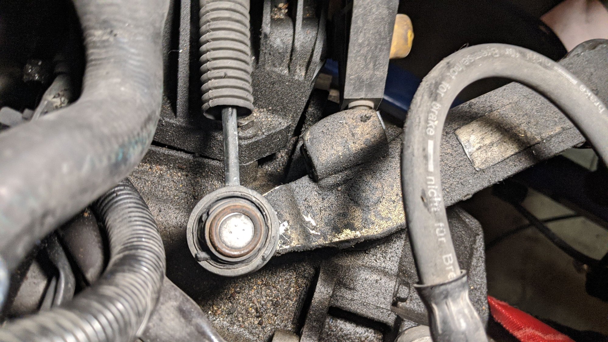

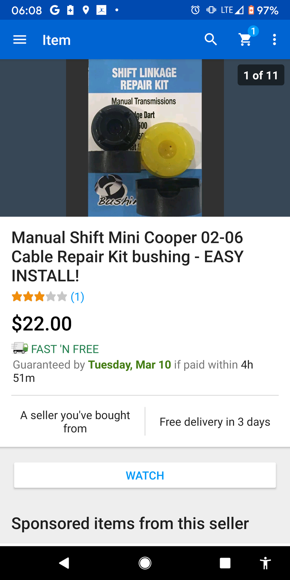

Yep, looks like they are shot, most people replace both cables. I had one of mine go and the other side looked like it was ready to pop out. Never seen anyone install those ebay ones. On the cables their are a Condition A and Condition B version.
Thank you for your input, as well as Blwnaway, which I like his/her user name and image.
The upper cable seems solid, and I think this one is trashed because of how long I waited to replace the transmission mount which was shaking like mad around 55mph. I swear switching that thing revealed a slew of issues. Either way I have work on Monday so I'll be happy to tell the community how the eBay shift linkage bushings go. Ultimately I want to swap to the getrag 5 or 6 speed which I'll get new cables for, but for now I need, Clank to roll quickly under it's own power.
