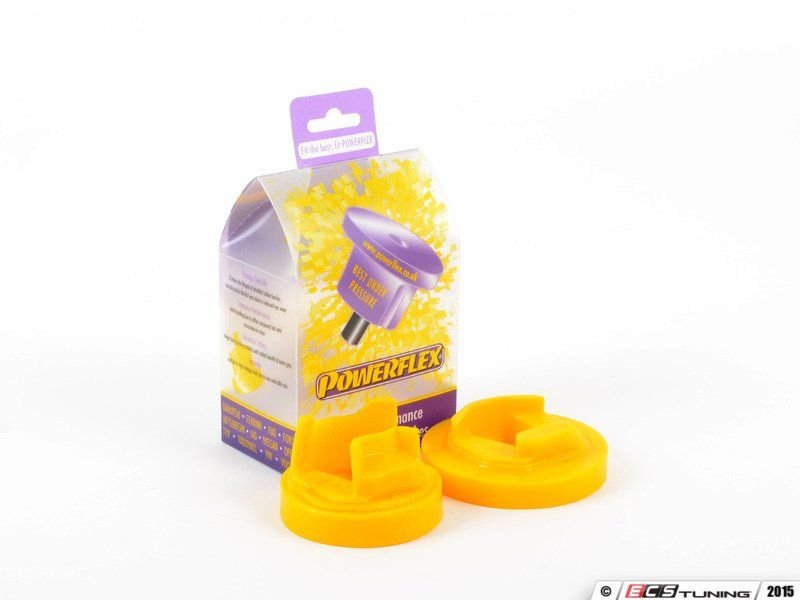

I got OEM front and lower mounts, but powerflex for the transmission mount. I’m scared to take the mount out and off without knowing how this powerflex is supposed to replace the OEM
Polyurethane gearbox bushing set
i learned it’s waaaaay easy. I expected it to be like the control arms, instead to install the only unique step is to leave the bushing on the car and place the powerflex inserts over/in the old bushing.
