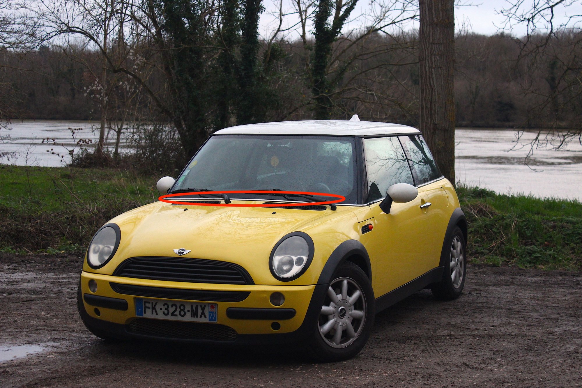

New model is up! Exterior A-pillar roof molding, which tends to be ripped off by car washes apparently: https://makerworld.com/en/models/151...fileId-1580878
This avoids having to buy the whole side roof molding, you can just replace the actual part.
They are pretty weak and tbh not super well designed, it's not surprise the plastic break, which allows them to be ripped off by car washes or whatnot.
