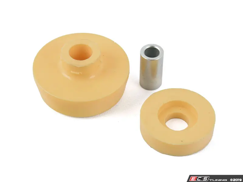

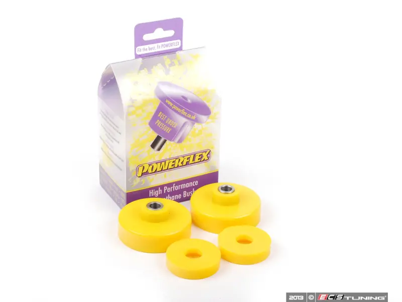

Rear stut upper bushing is my guess, had those go on my R52 and my R58:
https://www.northamericanmotoring.co...revisited.html
https://www.northamericanmotoring.co...ts-of-toe.html
You can get OEM ones that will last but will need replaced after another 30-50K (has a softer oem feeling or do the powerflex yellows (little more tight)and never do it again.
https://www.ecstuning.com/Mini-2006-...n/Shocks/Rear/

Upper bushing are ordered...will keep posting updates.
@Mike87 the sway bar was checked and all these parts have less than a 1k on them...noise is in the rear, so I will see if replacing bushing will do the trick.
