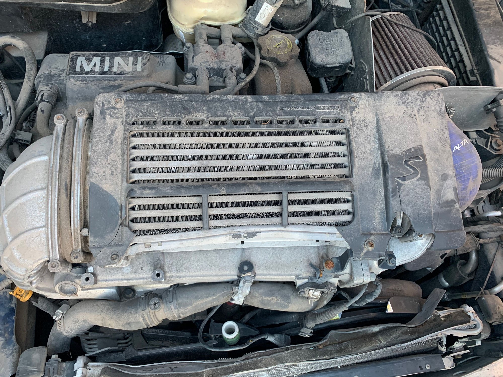

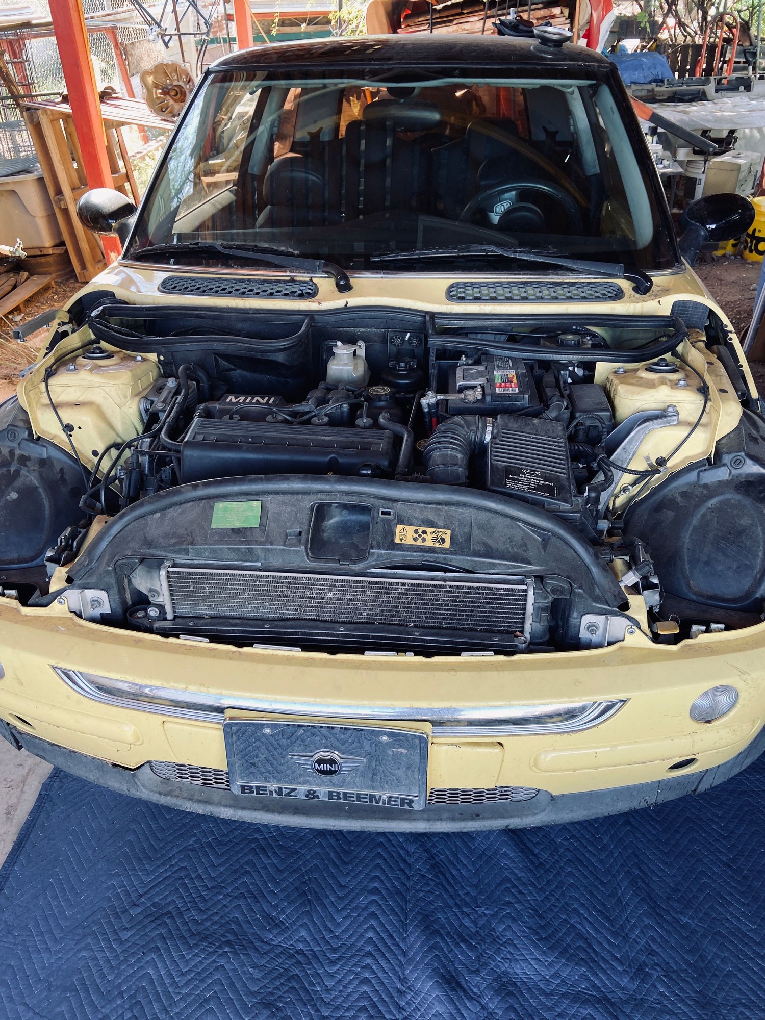

I also Have the engine...
I was thinking I also have the engine (See pictures below ), from that 04 Mini Cooper S that I bought but haven't tested the engine to see if it turns on but if it did work, my question is, would it be wise just to swap out engine as well together with the transmission to avoid worrying about final drives?
1st picture - (This is how I bought the car. The impact was from the front but hopefully, it didn't damage the engine as much. I haven't tested to see if it turns on, should I?)
2nd picture (BROKEN ENGINE/MOTOR MOUNT)
3rd picture (FRONT ENGINE VIEW)
4th Picture - (TOP ENGINE VIEW)
