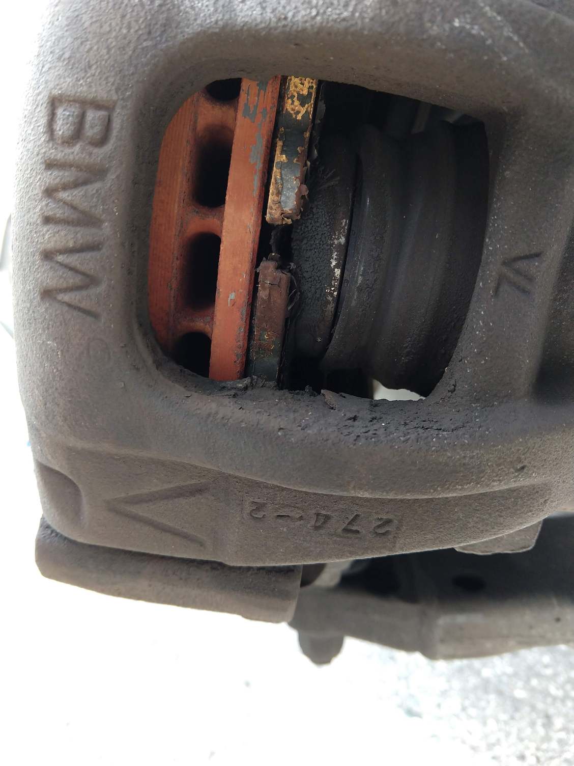

Thanks for the suggestions. I’m in the process of upgrading to the R56 brakes. Got the passenger side done then I see 2 washers in the box. Can someone tell me where these should go and is it dangerous to not have it installed? I’m assuming it goes on the brake line before connecting to the hard body line. Can someone confirm where it goes? I watched videos and don’t see where the washer goes. Thanks in advance.

There is a brass washer that goes between the banjo fitting and the caliper. IIRC their might be a washer on each side of the banjo.

Thanks, Aspen. I’m using r56 brake lines and they didn’t have banjo bolts on the caliper side. They screwed on vertically. Does that mean I can disregard these washers?

Sorry I guess my memory is not so good and getting my calipers mixed up. I did the conversion about 5 years ago. I used R56 rears too, that took a more work to clearance the control arm for the different hose fitting.

I bought my brake lines from Way Motor works and I don't think there were any washers. I found some old pictures and from what I can tell no washer on the R53 end.
And no washers on the R56 (caliper) end. Brake line just screws right into the caliper.

There is NO washers with the Conversion lines as the lines screw directly into the calipers. Unlike the original calipers that used a banjo fitting with two crush washers.
Our standard R53 non conversion line kits do include the washers to install the lines.
