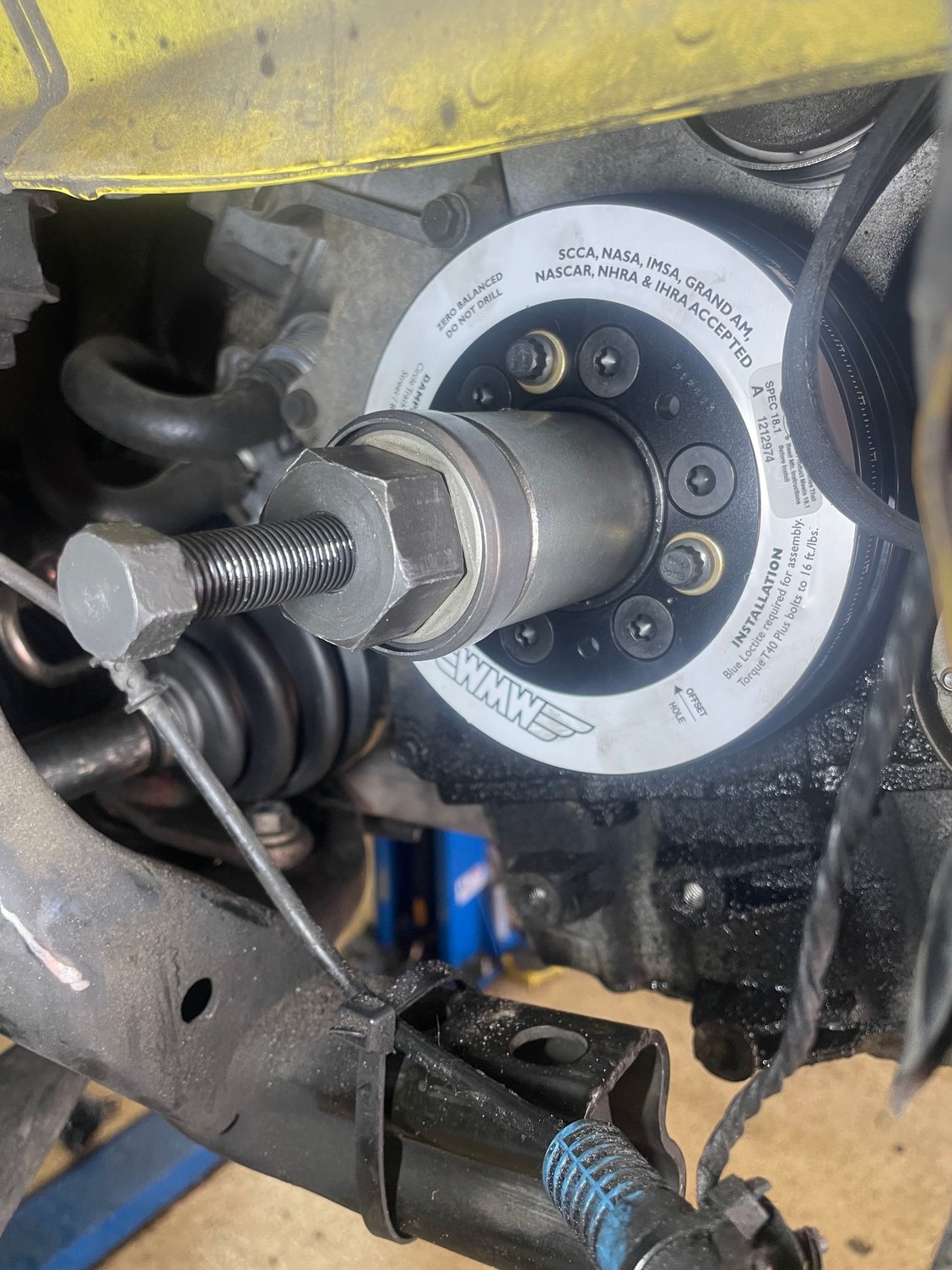

I installed my ATI Super Damper (from Way Motor Works) earlier this year. I used at harmonic balancer installer and a properly sized spacer to press it on the crankshaft.
Then a prybar to hold the pulley while I torqued the bolt.

Ghostwrench,
Any issues about the fit? like it won't go\press through the crank?
Do i need to apply heat?

No issues at all. Just thread the threaded rod of the pressing tool into the crank until it bottoms out. Slide the pulley on the crank snout, then add the spacer against the pulley and put on the forcing nut. I like to hold the threaded rod with a wrench to keep it from overtightening (not likely, but it makes me feel better) while I turn the forcing nut (27mm) to press the balancer on. The last time I used this tool, a guy in the shop had a ratcheting 27mm wrench to speed up the install. Without that ratcheting wrench, its maybe 1/3 of a turn at time. Slow and steady works just fine though.
If you don't have the tool and don't want to buy it (I see one for about $40 on Amazon), you probably could rent one from a local auto parts store.
I have never needed heat to remove/install a press fit harmonic balancer.
