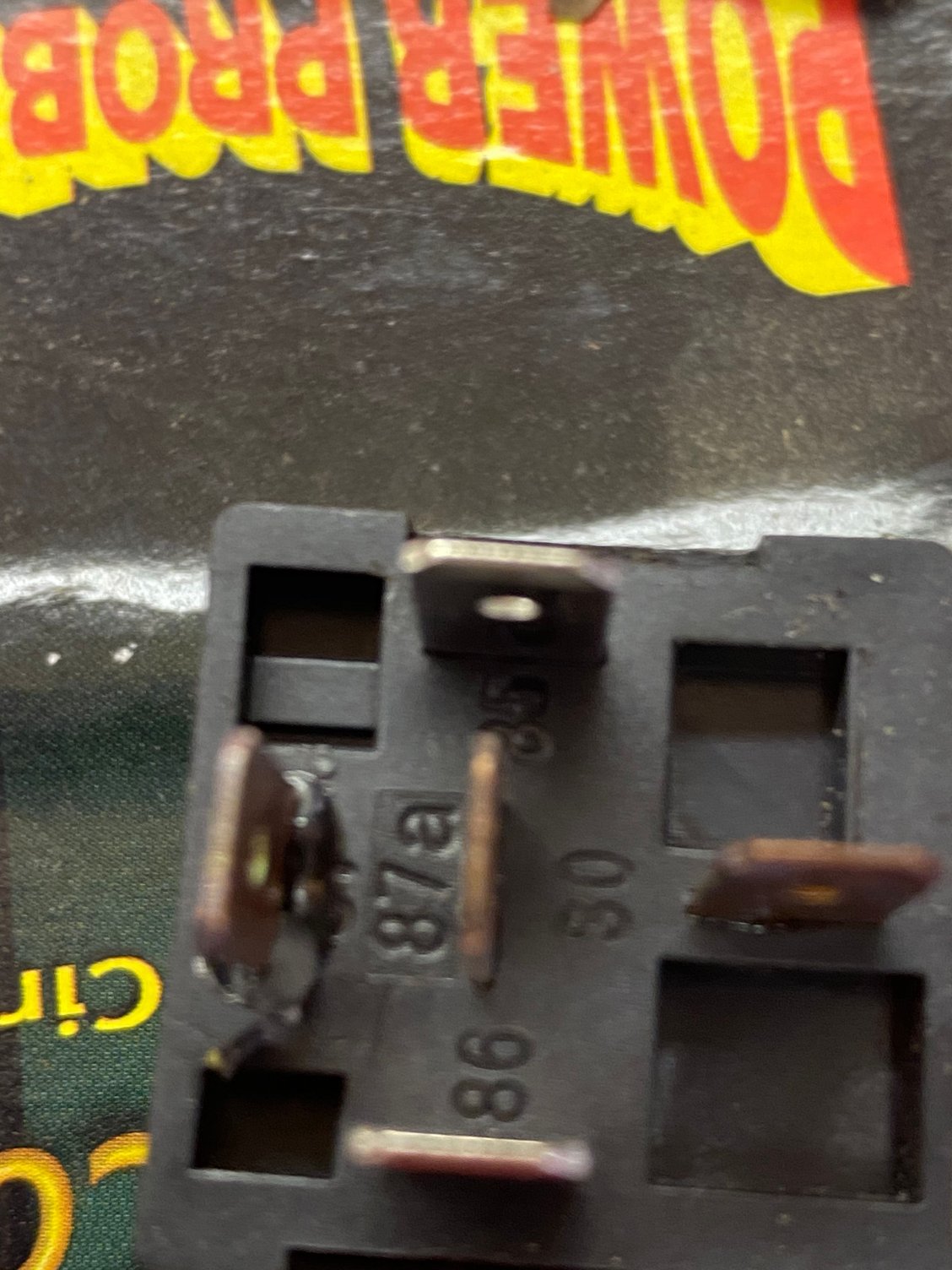

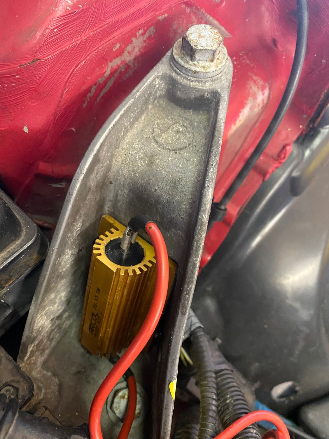

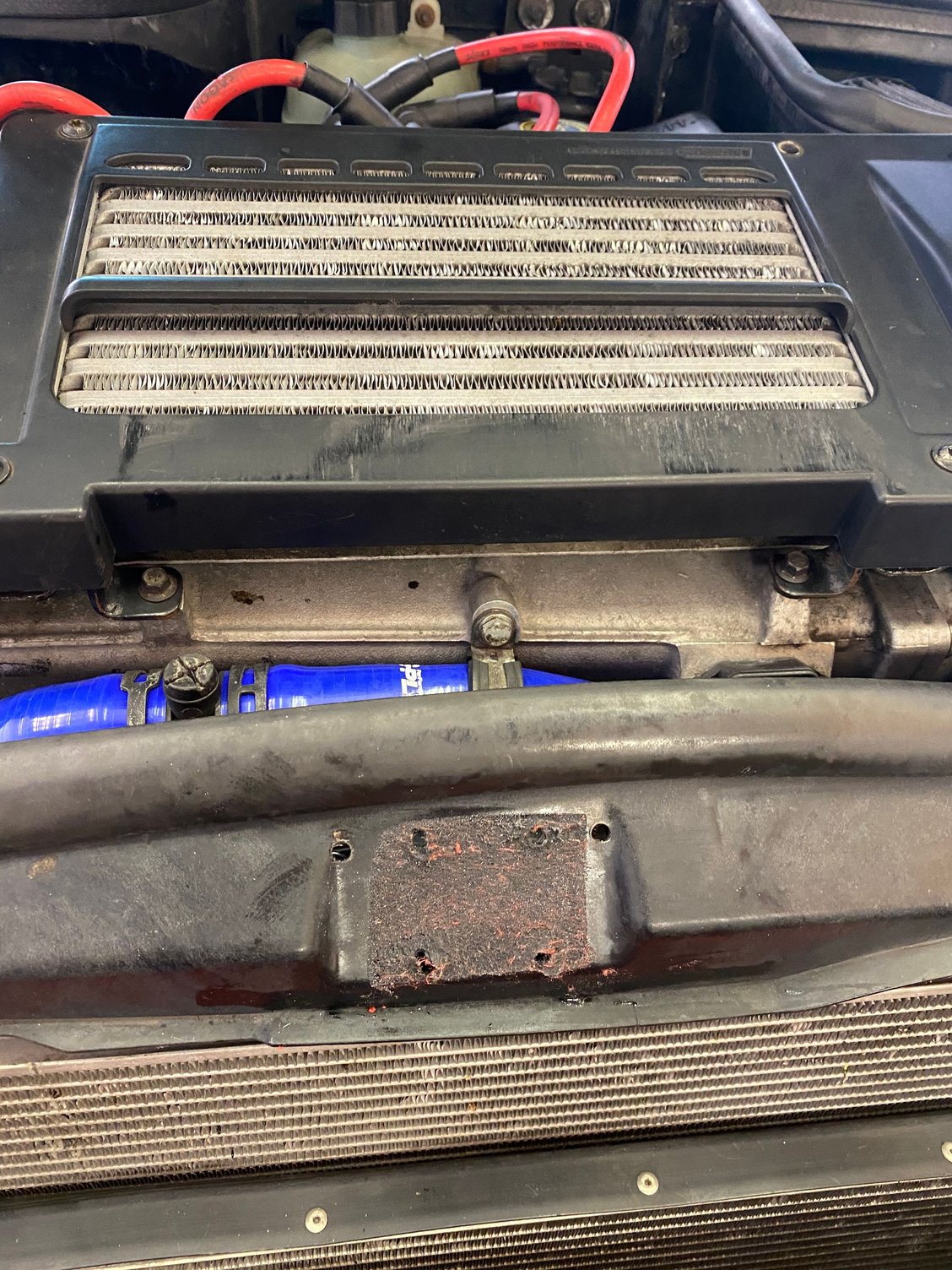

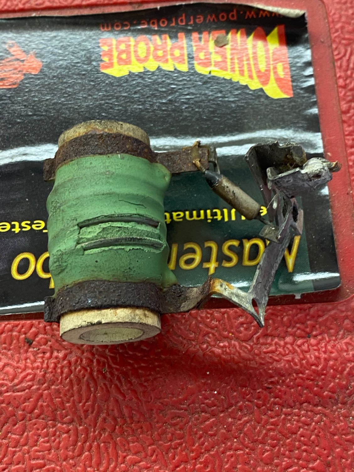

After reading through this thread, I have also completed the low speed resistor mod and my low speed fan is now working. I have the larger resistor from Mouser (4 bolt holes) which is linked earlier in this thread. I initially mounted it to the front composite support in the little cutout in front of the rubber hood seal based on what another member did. I found that this was a mistake as the temperature on the resistors surface approached 400*F after about 10 minutes of running (AC on).
A have relocated it to the aluminum trans mount as most others have done, but have not tested it again yet. My question is, has anyone here measured the surface temperature on one of these during operation? I read somewhere that 220*F was considered normal. I am hoping that having the aluminum mount to dissipate heat will do the trick. I measured this using a probe and my DVOM. The resistor itself was fine, I am just concerned about surrounding components.
For reference, I have a 2002 MCS with the 2 plug fan system. For this mod, I removed the resistor/relay pack from the fan, cut the old resistor out, and essentially wired the new resistor inline but in a remote location. I also replaced the 5 pin relay under the cover at the fan due to a melted pin. The wire I used is a bit heavier than stock as well. I will try to add some images to this later on if I can.
