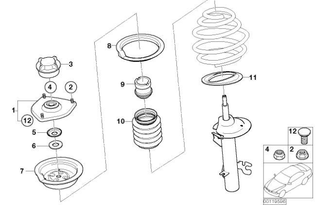

Thanx - you guys put the Bilstein B4 OE Sport Shocks & Struts KitES#3202677 on sale so I grabbed a set of those, and all the other parts that go with them to make up each shock and strut assembly:
I had to replace EVERY piece as the coilover replaced everything Doh! Got all the parts in today and built the assemblies:
Now I just need to install them, the Header, Fuel Injectors, Rear Brakes, (front already installed Wilwoods), Standalone ECU. and have the ECU tuned.
