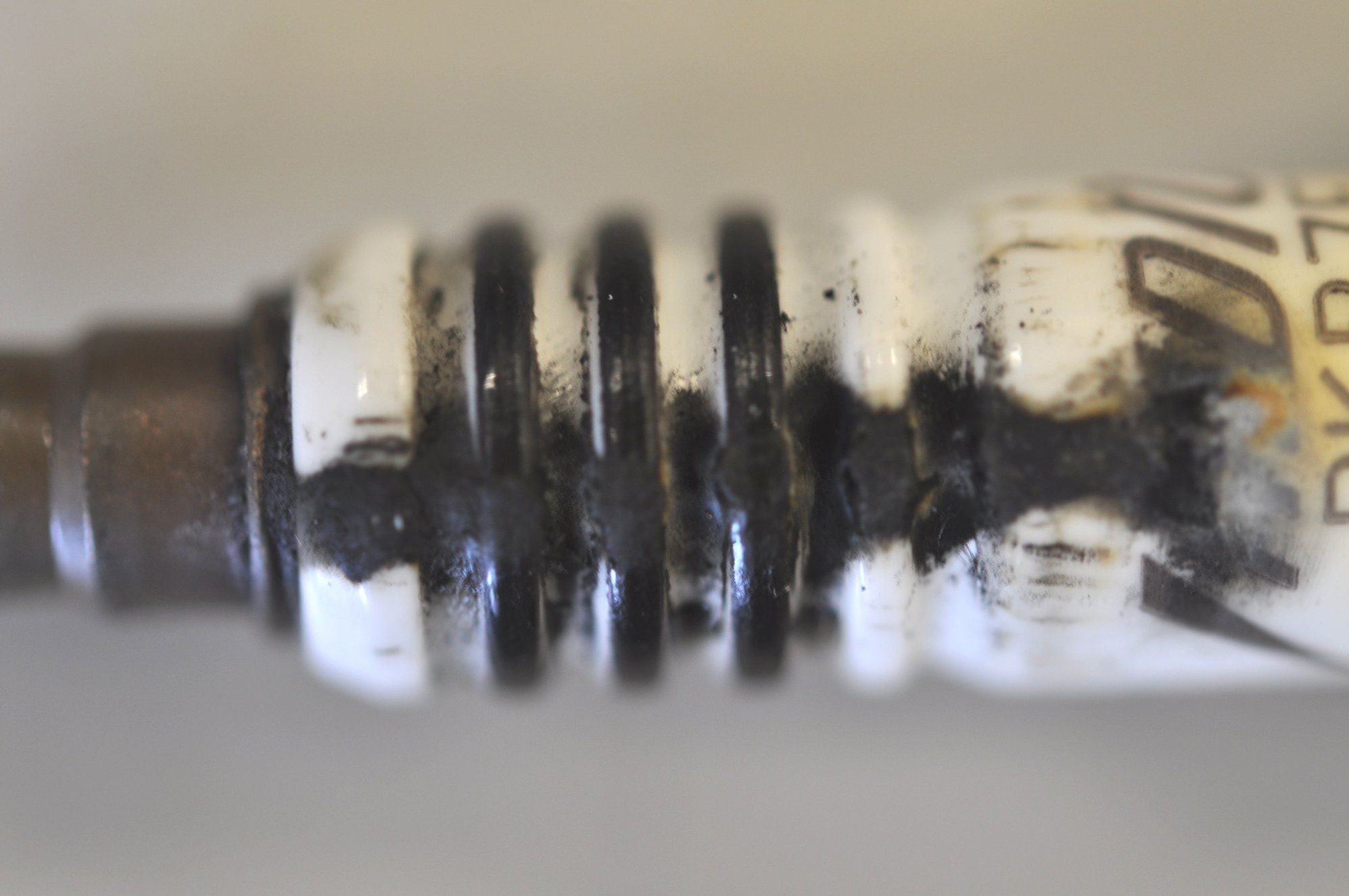

I found the immediate cause. I decided to change the plugs even though they only had 20k miles on them- here's what I found with #2 plug:
I haven't cleaned it up and put it under the microscope yet, but I'm betting that its got a crack in the insulator....The arcing burned all the way down the insulator and across the plug wire boot to the (I suspect) plug tube. Just a little bit of oil on the seal, so I'll probably get a valve cover gasket kit and do them all up properly just to be sure.
Microcracks at the top of the insulator just below the contact. We'll see if the new one cracks after use as well... NGK BKR7-EIX plugs FWIW
