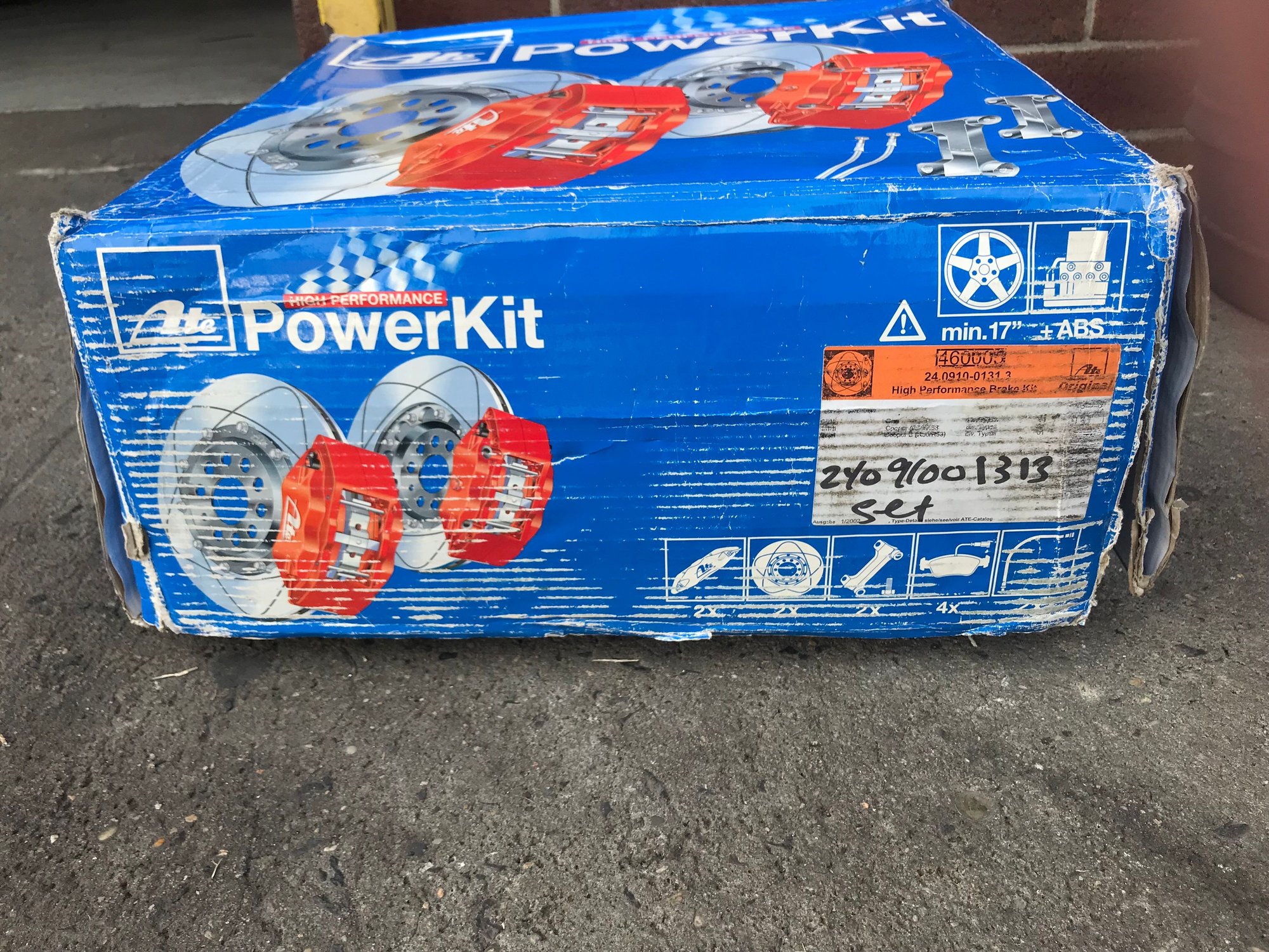

Hi,
I bought this kit over the weekend and now installing it to find out that the right side caliper bracket is wrong. I remember ATE, but they are no longer making this kit and finding anyone that sells them in the US is proving difficult.
Here are a few pics of the box...cheers we have one side installed successfully... but that doesn't mean much.
They look almost identical to stoptech ST-40 BBK kits...so I am hoping the brackets are available.
