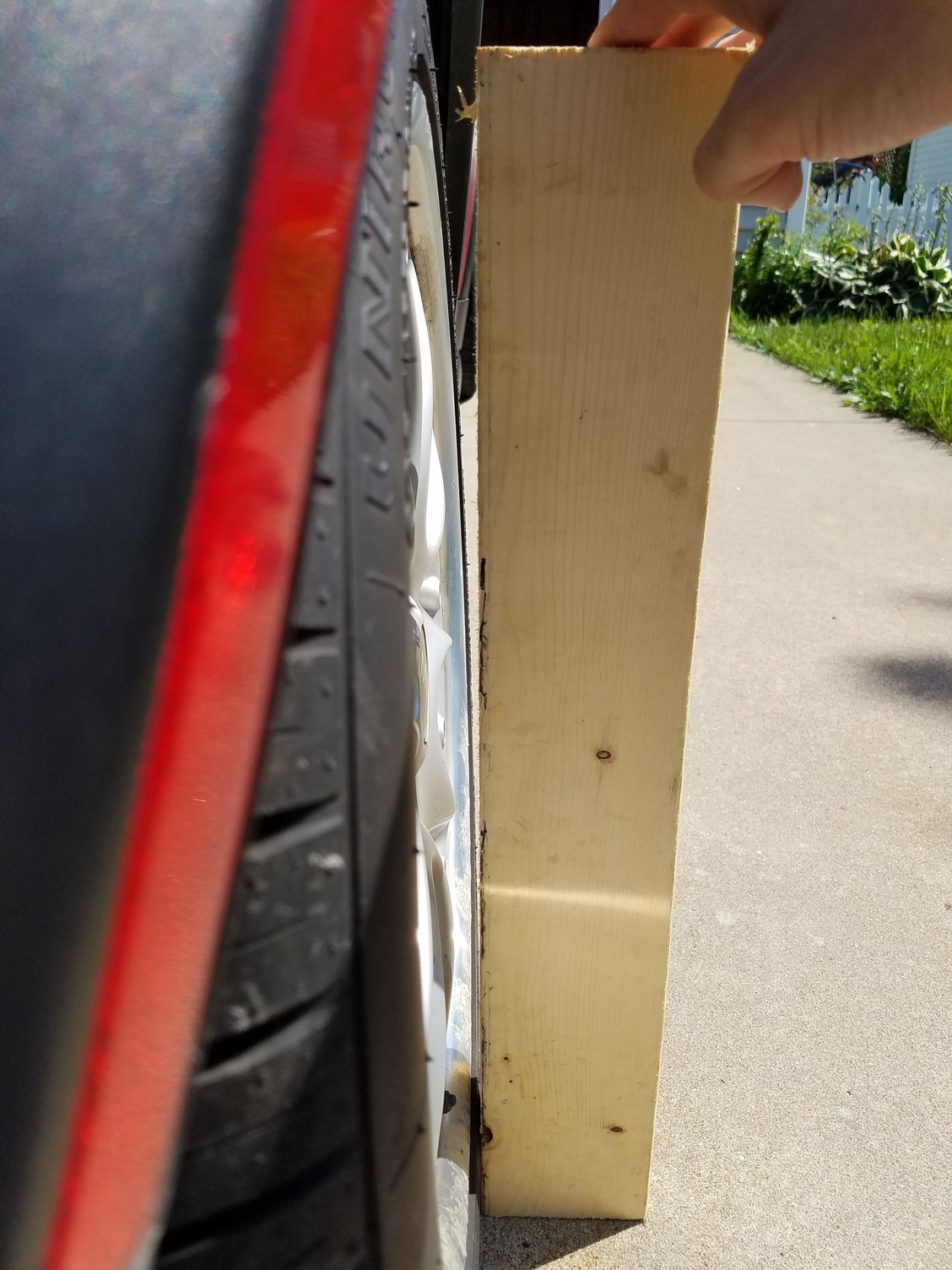

Old Aug 8, 2018 | 01:24 PM
Shane O'mac's Avatar
Shane O'mac
Joined: Aug 2018
Posts: 8
Here's some pics

Originally Posted by Shane O'mac
Here's some pics
That looks just like mine, about normal. Rears are noticeably more camber than fronts with stock suspension.
Old Aug 8, 2018 | 02:37 PM
Fly'n Brick's Avatar
Fly'n Brick
Joined: Oct 2008
Posts: 4,965
Likes: 393
As stated, negative camber is in the design. That looks a little more than mine are but not by much. How many miles on the clock and do you know when and if an alignment job has been done? Rotating has to be done regularly. I do mine every time a 5 or a zero is followed by 3 zeros on the clock. Directional tires rotate same side front to back back to front. Bi-directional for front wheel drive is back to front cross and front to back same side.
