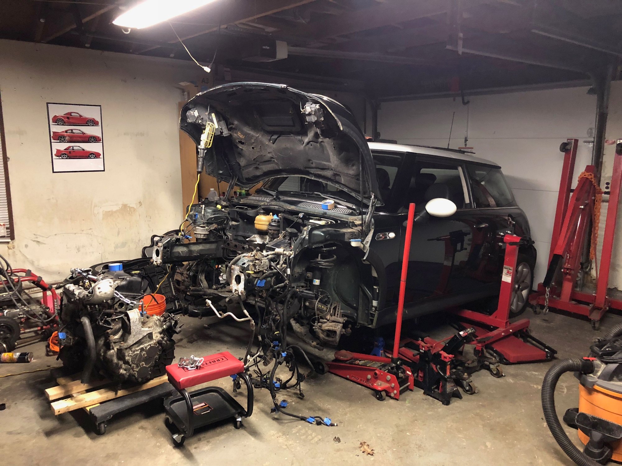

Just recently picked up a 2004 R53 as a project. It has 147K on it, does start, run and drive (although no power steering and brakes barely work). Some cosmetic issues (dents, some slight rust issues, nothing major). I posted in the first gear thread, but figured I would start my project thread. Build plan at this point is to get her running healthy and somewhat reliably with some minor performance upgrades for a weekend fun car. I'm not necessarily in a rush so I will will post and document as I go through. Things that need attention:
  • Brakes
  • Power Steering
  • Engine Health, general overhall
  • Suspension
  • Cosmetic
I'm sure the list will grow as more details emerge. Looking forward to the project and sharing my experiences.

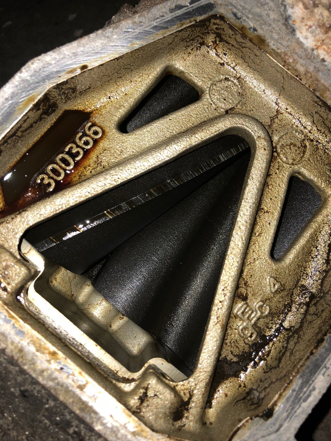

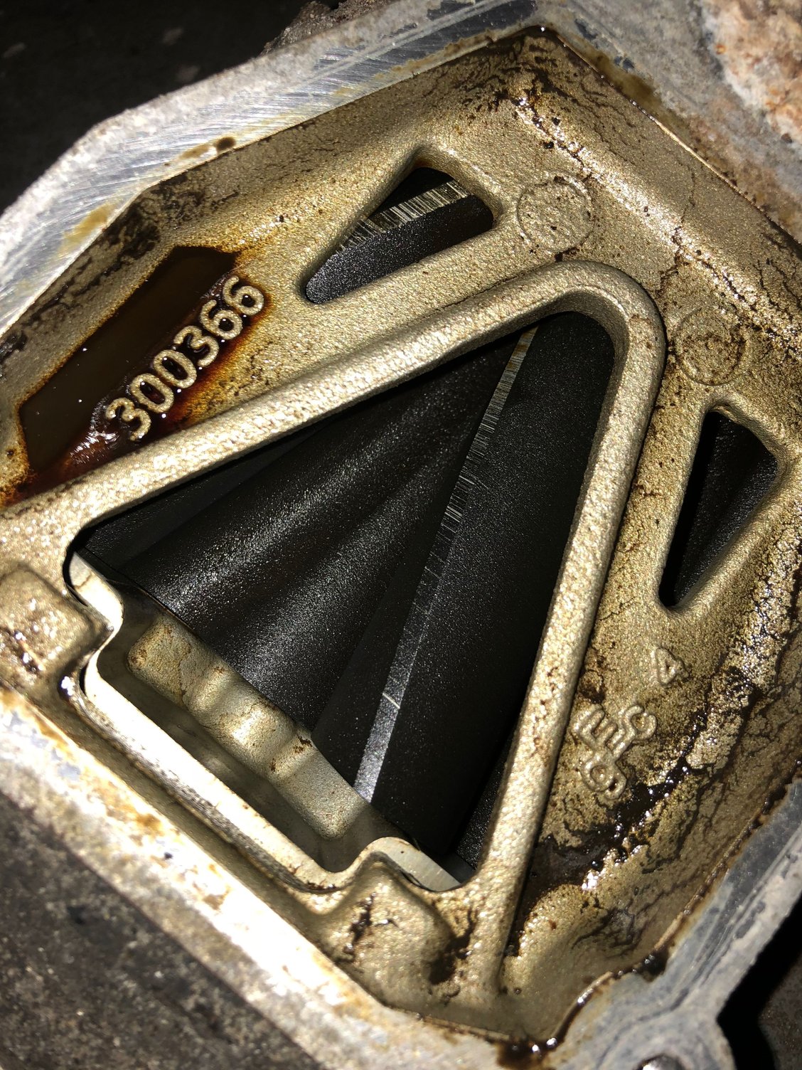

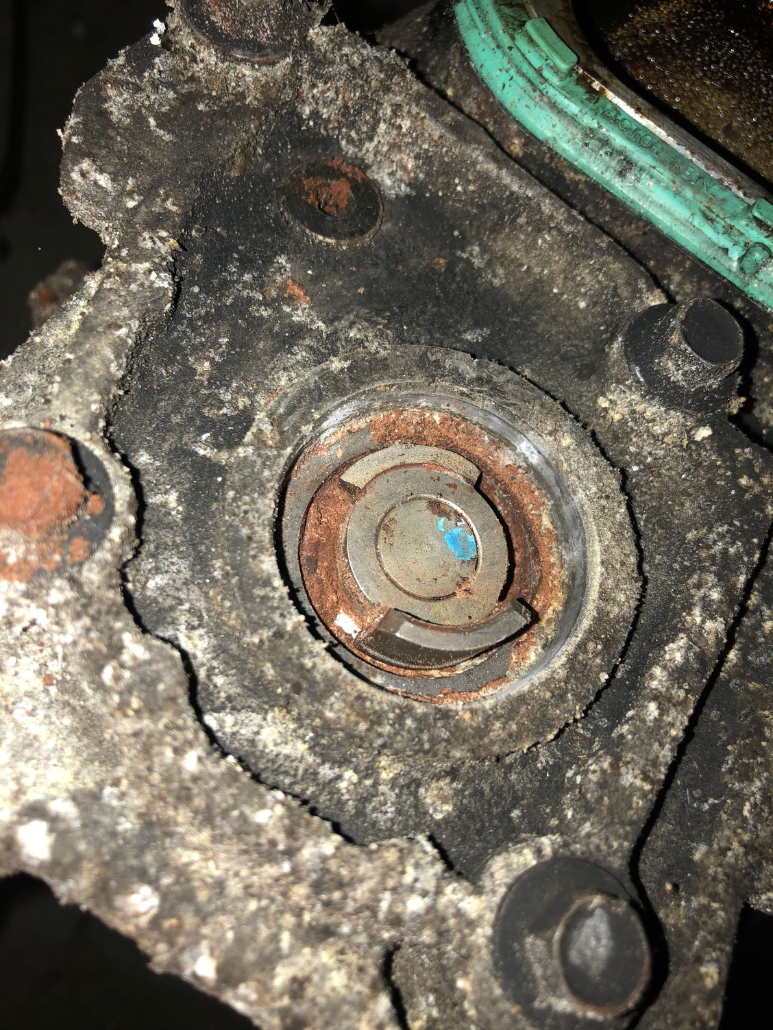

funny you mention it. I have been pulling everything off the engine including the supercharge and it looks like there might be an issue. It does turn freely by hand, some light scratches on the blades, but the area of concern is on the end by the drivers side. Looks like at the end of the shaft, one of the teeth broke off. It’s obviously not on the side of the pulley, so it’s not what drives the supercharger, but still an area for concern. See the pics below. Would love to hear from the experts. Also ran into another issue where I broke the intake manifold trying to get it off, so much of this engine seems corroded. Fun fun fun!

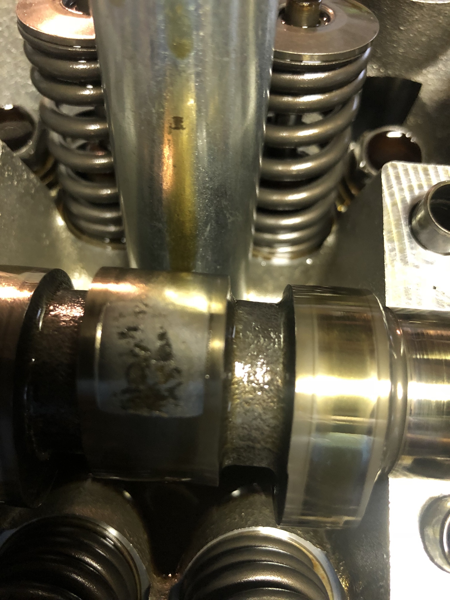

Had some time to further dig into the engine today. Unfortunately Ihad to drill 4 of the bolts holding the valve cover onto the head as the head of the bolts were so rusted they disintergrated. Luckily I was able to back the rest of the bolt out of the head with channel locks so no biggie there. As i was removing the cam shaft to get the head off I noticed there was some pitting on the 2 of the cam lobes:
Project: 2004 R53-jo8xcwc.jpg
I'm thinking Ill need a new cam shaft so I might as well get a mild cam in it. As I dug in further and got the head off, I found the biggest part of the problem:

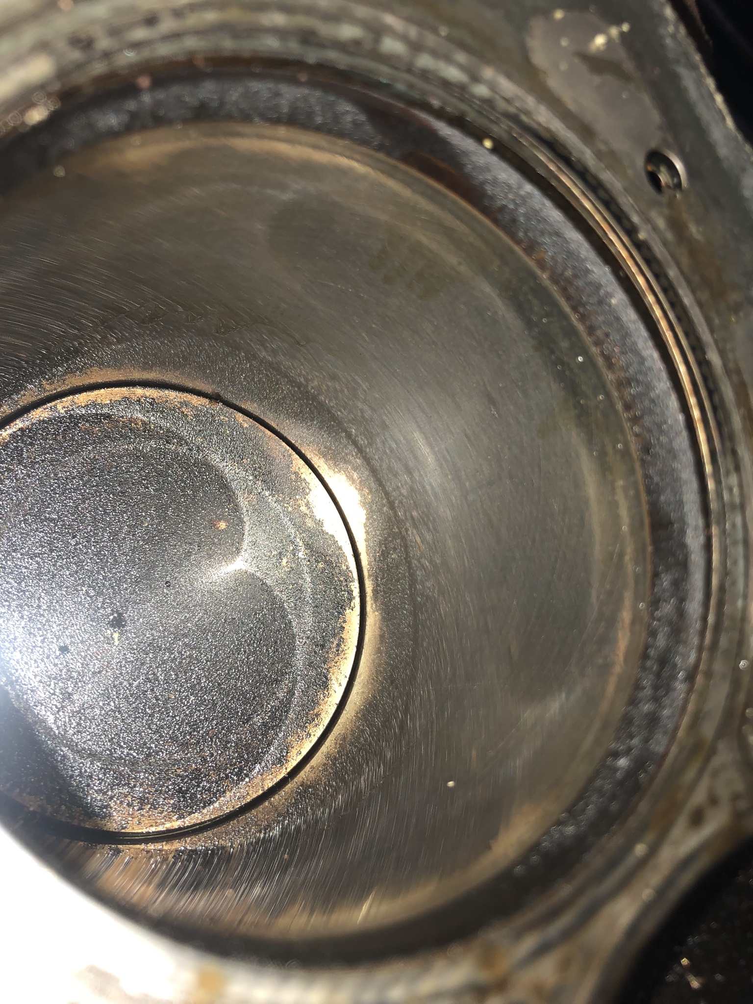

Looks like it burnt up. Question is why and what is the damage? There was still coolant in the engine and radiator when i brought it home but the tank was empty. Could it have messed up the head in general, who knows. The underside of the head looks decent, although some of the valves look burnt. I'm going to bring it to a local shop to get the head checked and to do a full valve job. The other side of things, the pistons look good aside from some carbon build-up. The cylinder walls look good too. I did hear some piston ring leakage thought when i did a leak down test, so I need to pull the pistons to replace the rings:

The cam wore out, most likely was a soft cam. I am sure this caused the cylinders to run poorly and heated the cylinder to the point of blowing out the head gasket.
The cylinders look good. Make sure the head and the deck are not warped!

Yeah, there had to have been some sort of failure, in addition to the pto gear that drives the water pump breaking, the water pump housing itself cracked where it meets the blocked. Basically completely broke off. So there was some sort of catastrophic failure. Almost have everything stripped down to the bare block. I'll bring both the head and block to my local machine shop to check and clean. I'm sure the head will need to be decked, but hopefully thats it and i can start reassembly asap. Considering pulling the supercharger apart and replacing the broken gear as it does turn very smoothly.
