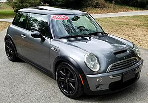

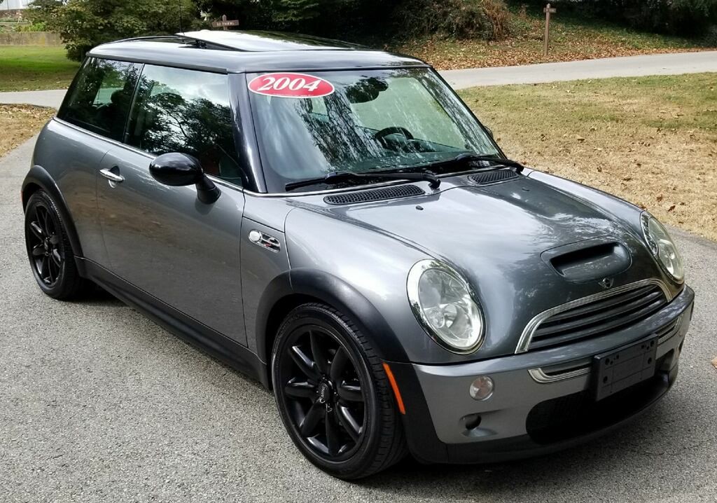

So I acquired above car with 168,000 on it... and it was washed up and pretty. Learned that it was a lot of lipstick. But she has good bones. The pic with black wheels is when my previous owner bought her.
I bought the car to work on with my son, Cooper, who is autistic. He loves cars; however, neither of us are immediately mechanically inclined. We did change the oil!!!!
Renn90 helped us find a set of wheels, as our wheels left something to be desired. We also needed brand new rubber on four corners (Cooper Zeon RS3-G1 215/45/17)
As we start this build, I am looking for input on MUST have, NEED to have, and WOULD BE NICE based on the list below. I hope the photos work out the first time.
