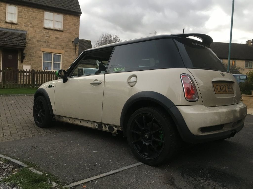

answered my own question
Why do I tend to answer my own question? I was just browsing google image search fotos, and here it is. I have to say it is very reassuring. It is the most unusual sill of any unibody cars I know.
credit to the pepper white owner at Minitorque over the other side of the pond
No wonder our Mini's are so stiff.
I still would like to see a more closeup photo of the "beam" at the sill. One with a view from under would be really nice. The photo gives me an impression there is a flat surface along the whole length to spread the load when jacking - with a piece of 2x4 scrap. Yes, as the car rises very high on one side, the angle is always a concern for me.
Here is another similar photo from across the pond - credit to Pobsey
