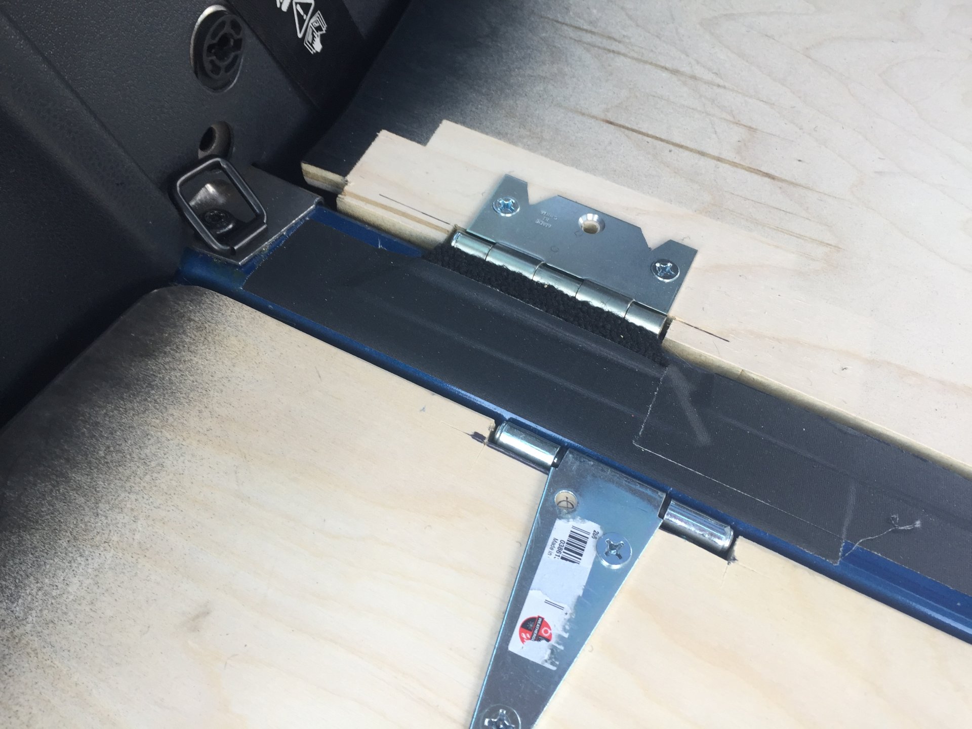

Basically, I used two pieces of 1/2" plywood, both hinged from the crossmember in the interior. I used crimp-in threaded inserts to mount the hinges, then used cardboard to make templates for the plywood lids.

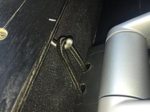

In front, a loop of bungee cord secures the lid. I dynamatted that area, then taped down carpet sections left over after I trimmed the 4x6 carpet mat to fit on top.
