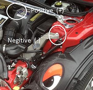

I just made this to add...

Thanks, this is what I was thinking as well.
