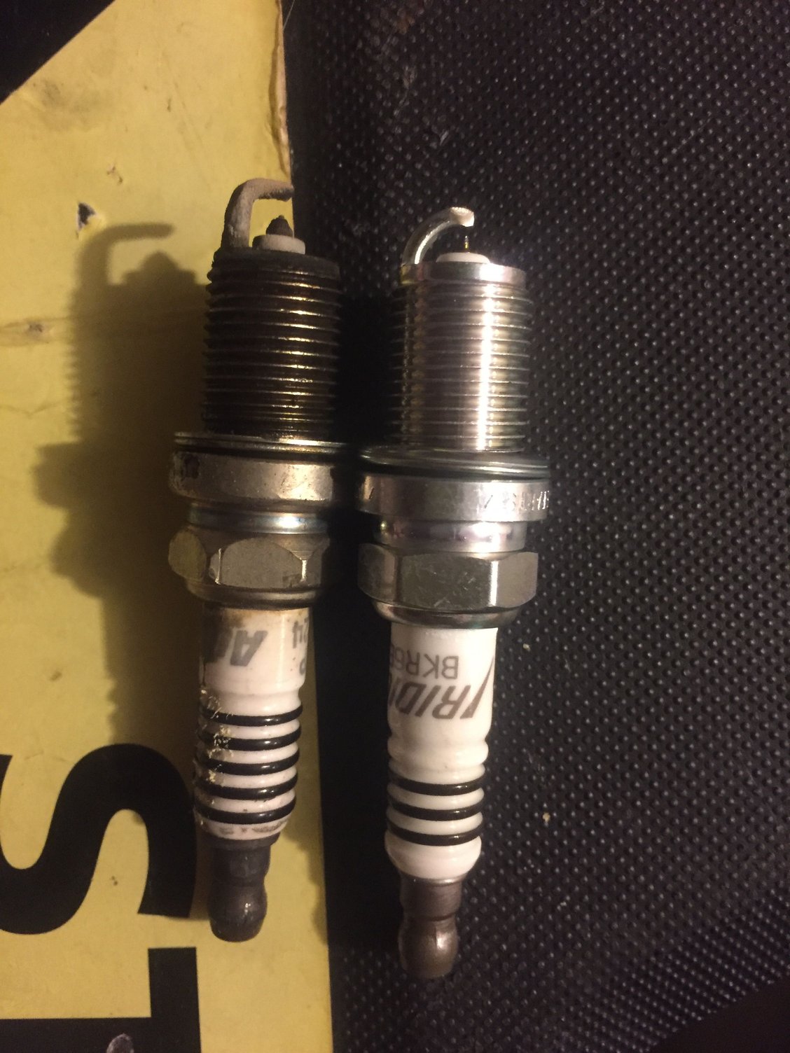

The old plugs are gaped to .44 but new ones are .34
Old Feb 13, 2020 | 05:07 PM
  #114
shrevemini's Avatar
shrevemini
Top Answer: 1
Joined: Jan 2014
Posts: 1,140
Likes: 329
From: Panama City Beach Florida
Looks like the gap was off on those older ones.
