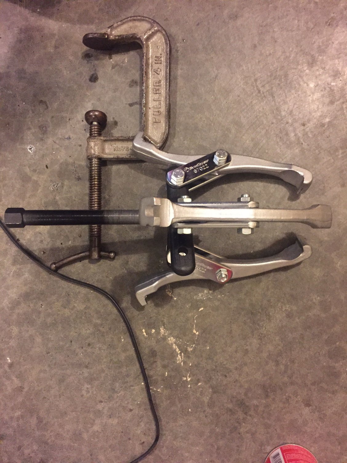

The pulley puller that I rented is too large to fit behind the camshaft sprocket.

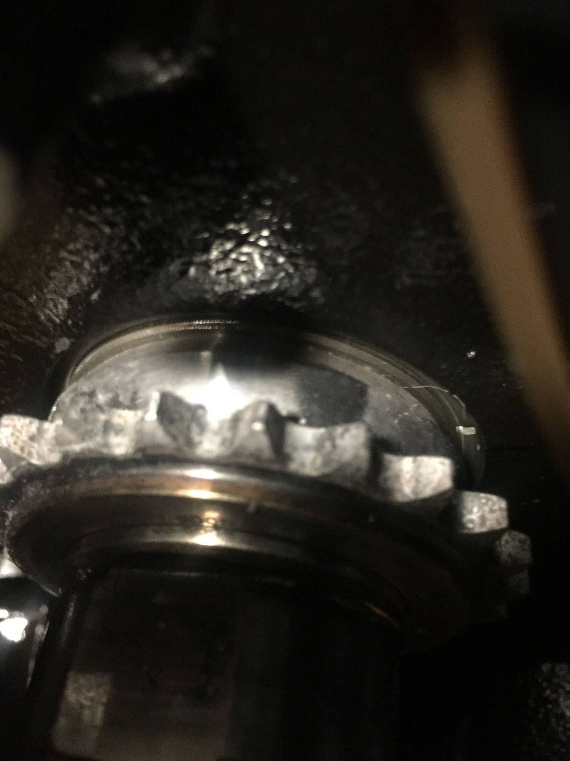

Can I get away with leaving the crank sprocket on?
Old Feb 4, 2020 | 02:54 PM
  #60
shrevemini's Avatar
shrevemini
Top Answer: 1
Joined: Jan 2014
Posts: 1,140
Likes: 329
From: Panama City Beach Florida
No no no.

Need something like this.

Can run into major issues leaving old gear on.

Read this article.

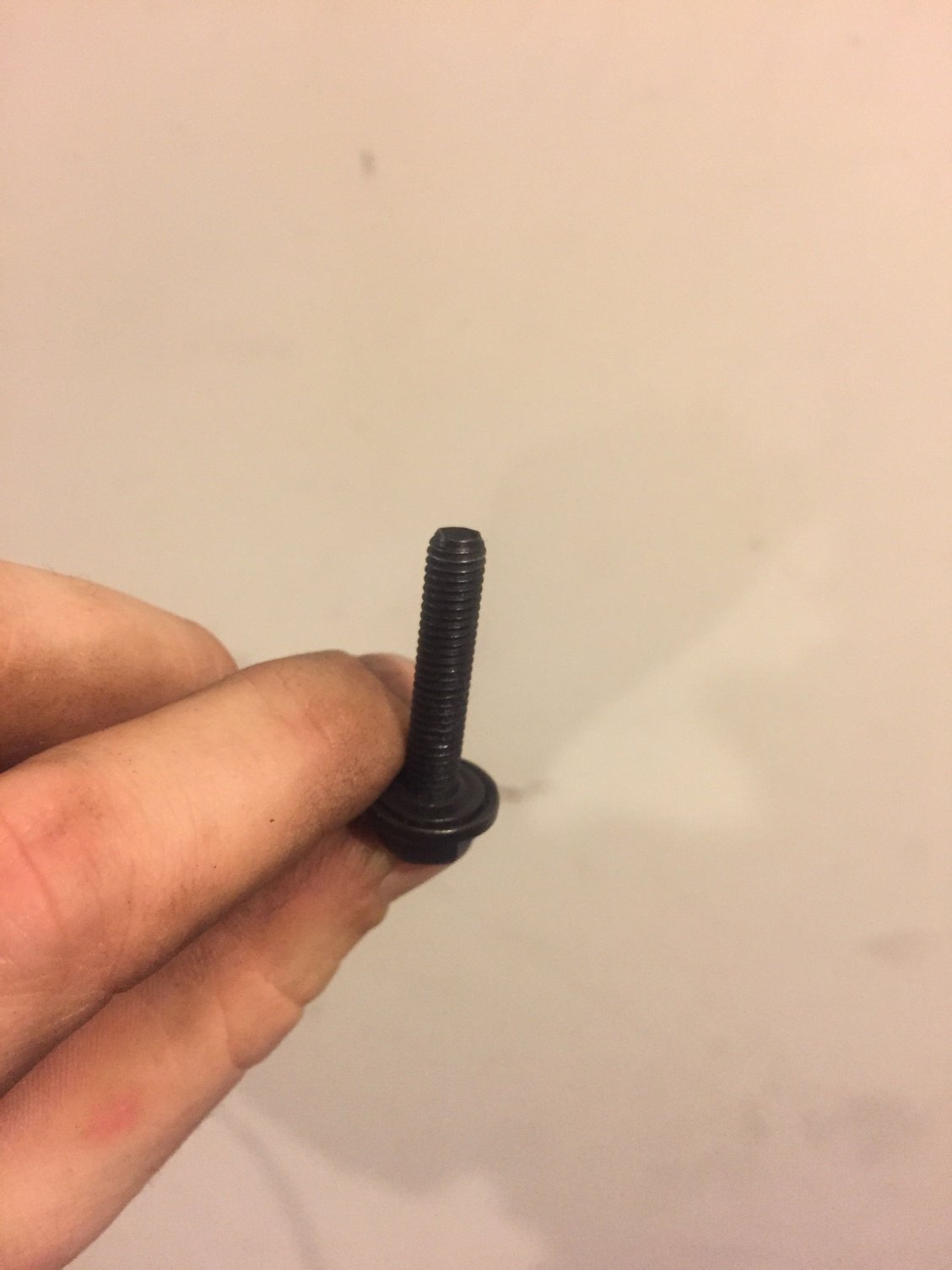

i lost two bolts from the timing cover, and don’t know where the long one goes.

Yes it will pop put itself. Go to mini parts website. Look at engine breakdown. Should be able to identify where the long bolt goes. Also in the video she talks about the long bolt.

The lady said the long bolt goes in the middle at the 45 min mark.
