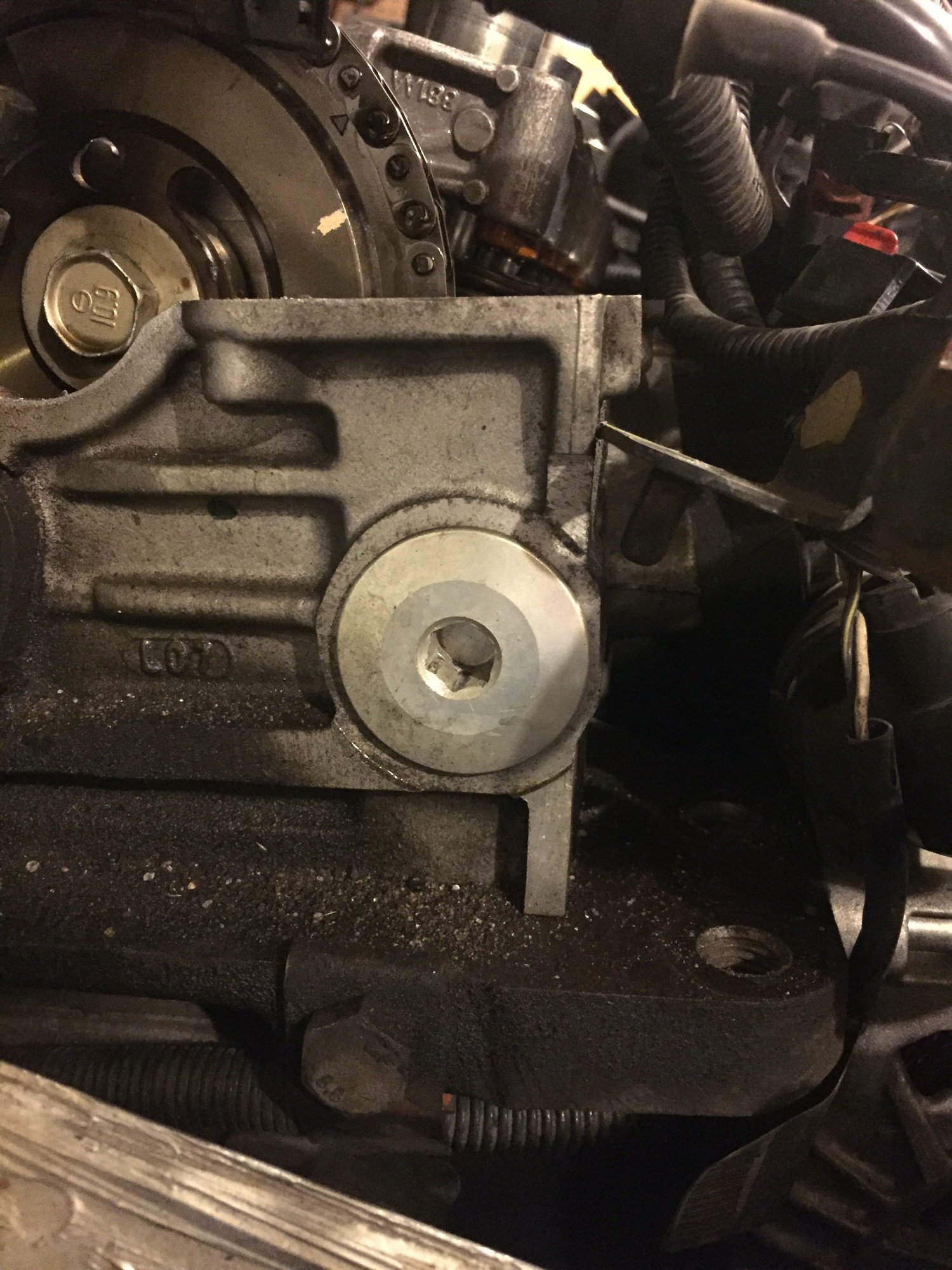

Youre the man. I have until Monday to fix my chattering. I just replaced the tensioner but it was so quiet I didn’t realize I was low on oil until it was too late and burned the oil. Since the burn the chattering has been intermittent, loud and fast, getting worse as the engine warms up. Should I just replace the tensioner again?
Im changing the oil pan gasket, and cam crank sensor too.

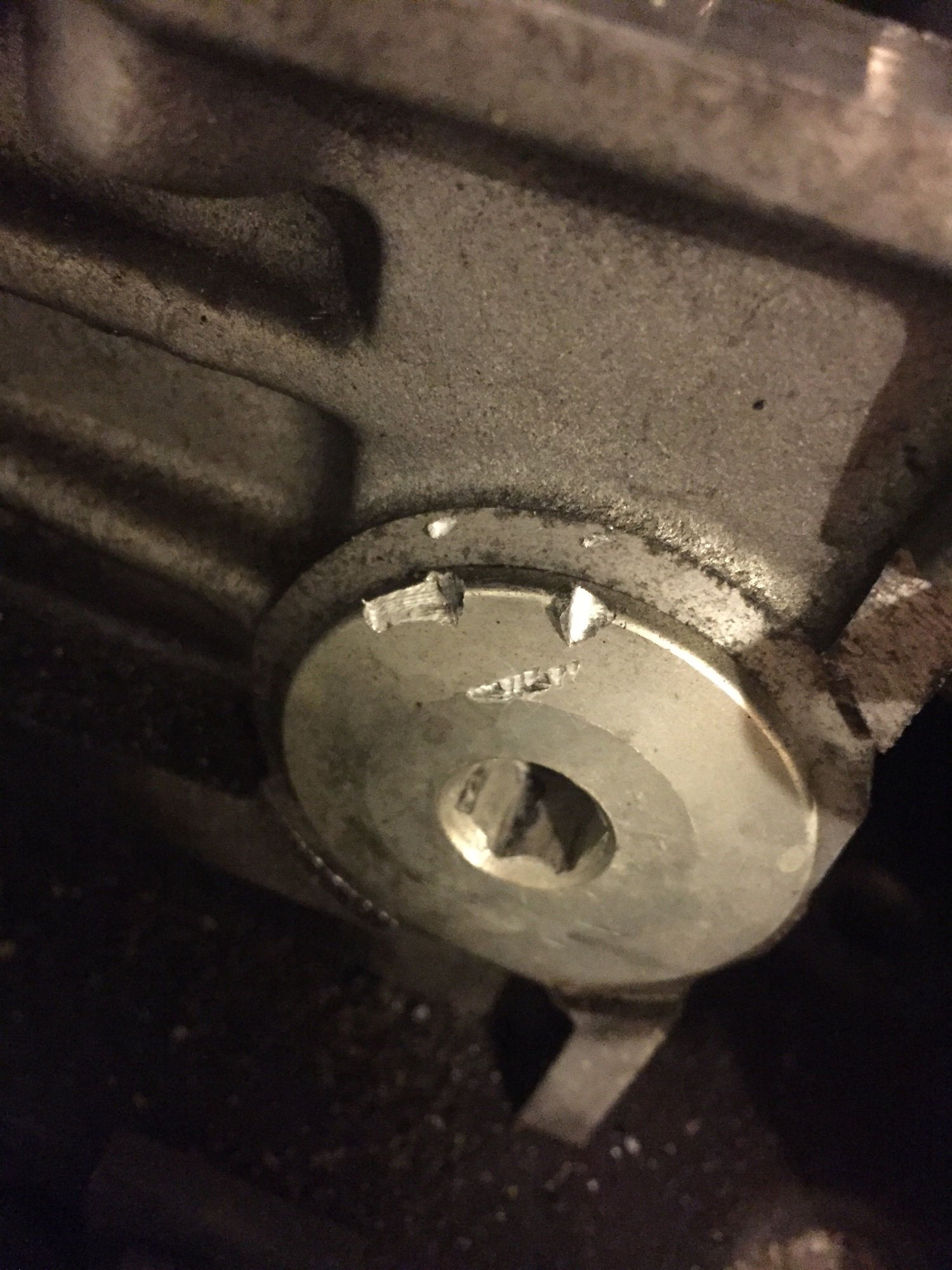

Also if I change just the rails I’m at a stand off with the oil plugs. An Allen wrench started to slip and strip the hole, and a chissle isn’t working either.
Tried to use a chissle....
Old Jan 25, 2020 | 02:41 PM
  #28
booyah93's Avatar
booyah93
Joined: Mar 2018
Posts: 272
Likes: 9
From: KCMO
Just wanted to update for people in the future.
i had a friend use a black bar on an Allen wrench and consistently push firmly while I smacked a chissle on the outside of the plug. I went at a forgiving angle to avoid peeling metal off.
in my left hand I hold a small chissle which I tapped with a hammer with increasing intensity while my colleague pressed with increasing intensity.

Wow... didn't have the much a problem with mine. Maybe they were replaced and they were torqued too tightly.
Old Jan 25, 2020 | 03:49 PM
  #30
shrevemini's Avatar
shrevemini
Top Answer: 1
Joined: Jan 2014
Posts: 1,140
Likes: 329
From: Panama City Beach Florida
Try hitting them with a heat gun. Get them nice an hot.

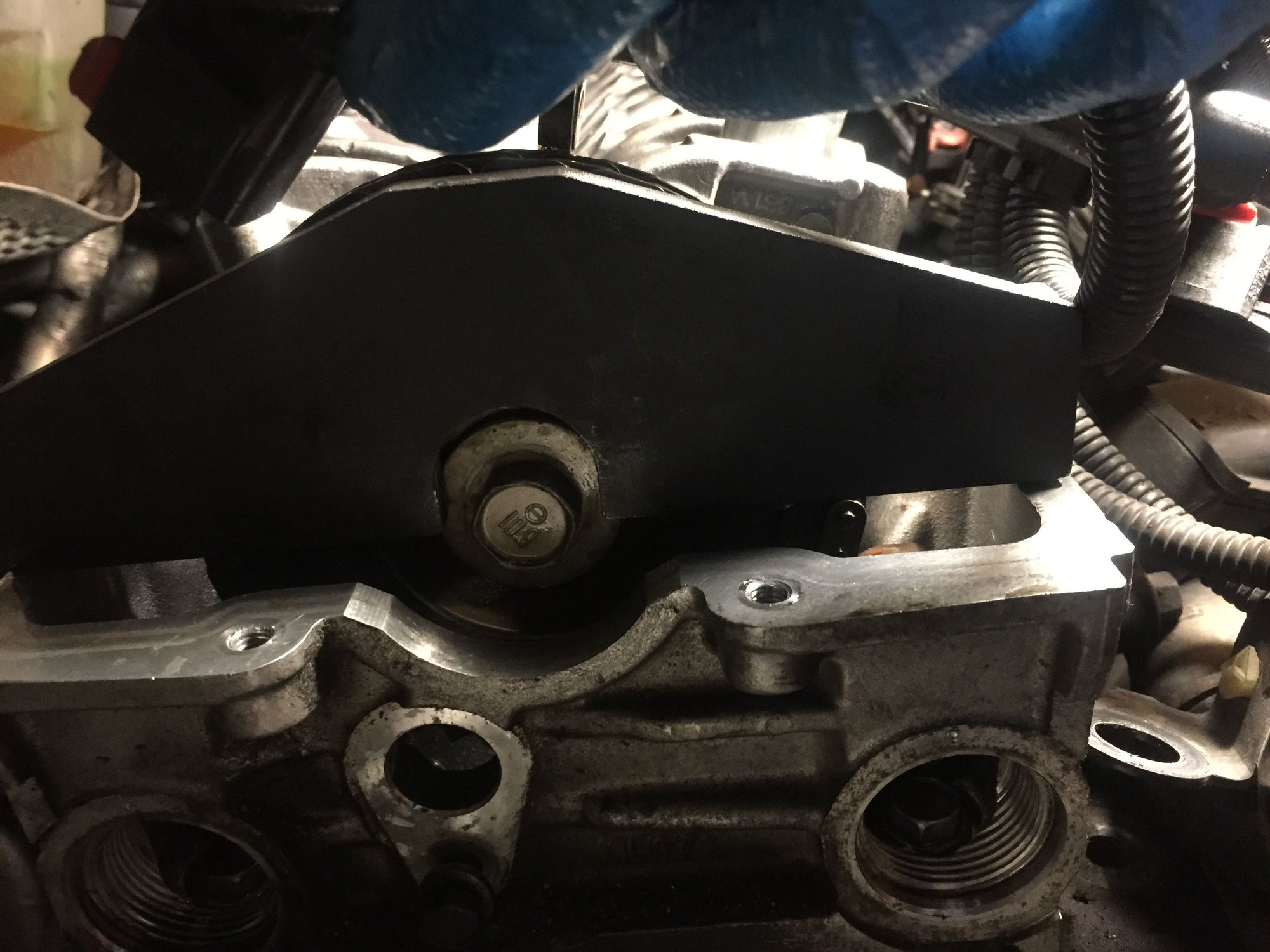

Are you doing the chain aswell. If you are you will need the camshaft holding tool. An if you are going to remove the cover. You will need 2 new oil pump seals an a new front seal.

This is the only photo I can manage to upload. SOFAR the engine is doing well. By the end of February I’ll be redoing the repair and completely replacing the cam and crank sprockets along with the chain. I’ll produce a video with accurate information.

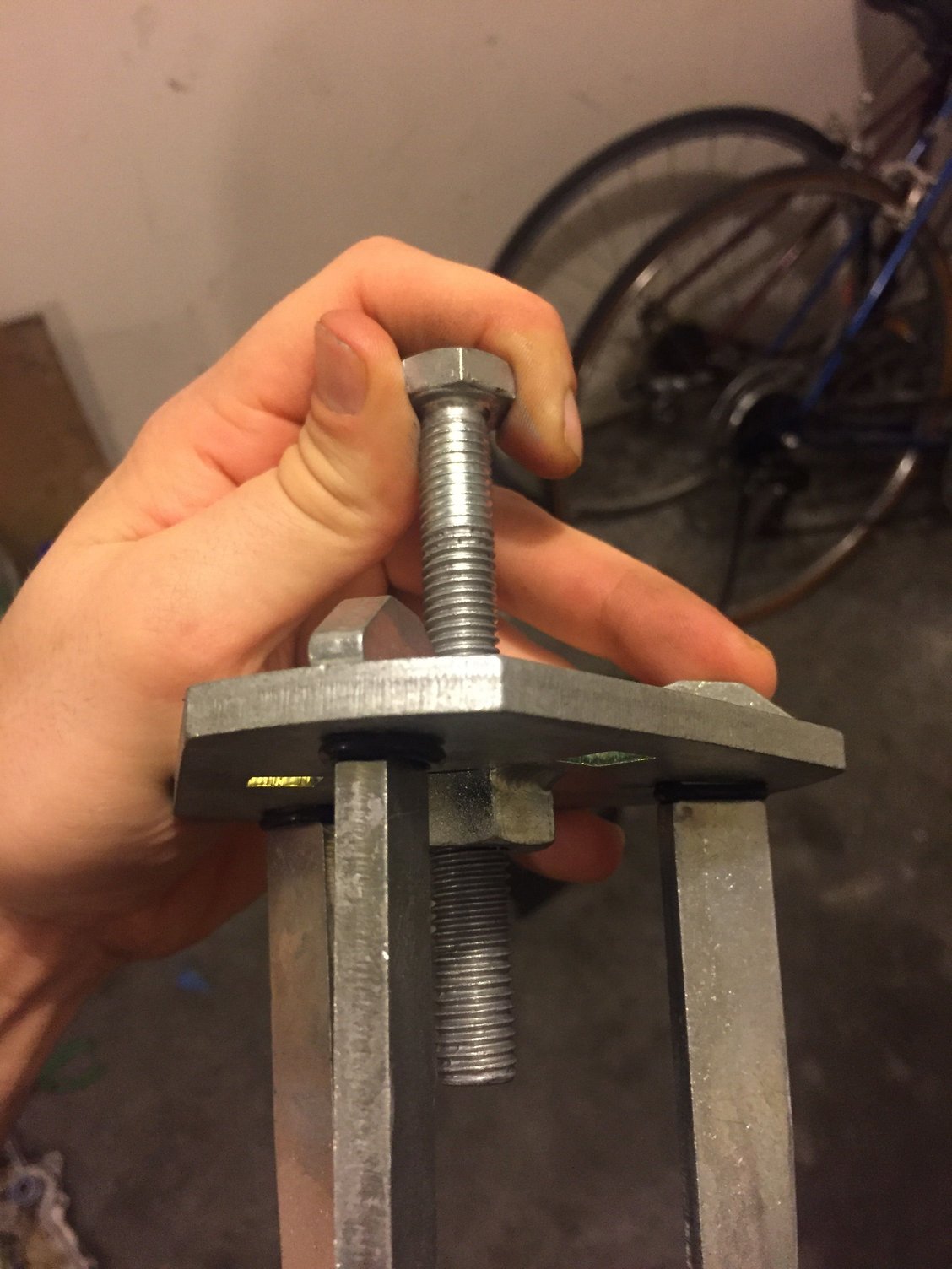

I sent you the tool you need to pull crankshaft pulley. Will be there Saturday. Just please return once you are finished.
Make sure you use some anti seize on thread of the tool. Or it will bugger up the threads.
Watch this video. It will show you how to use the correctly.
https://youtu.be/I2NHXwORyZA

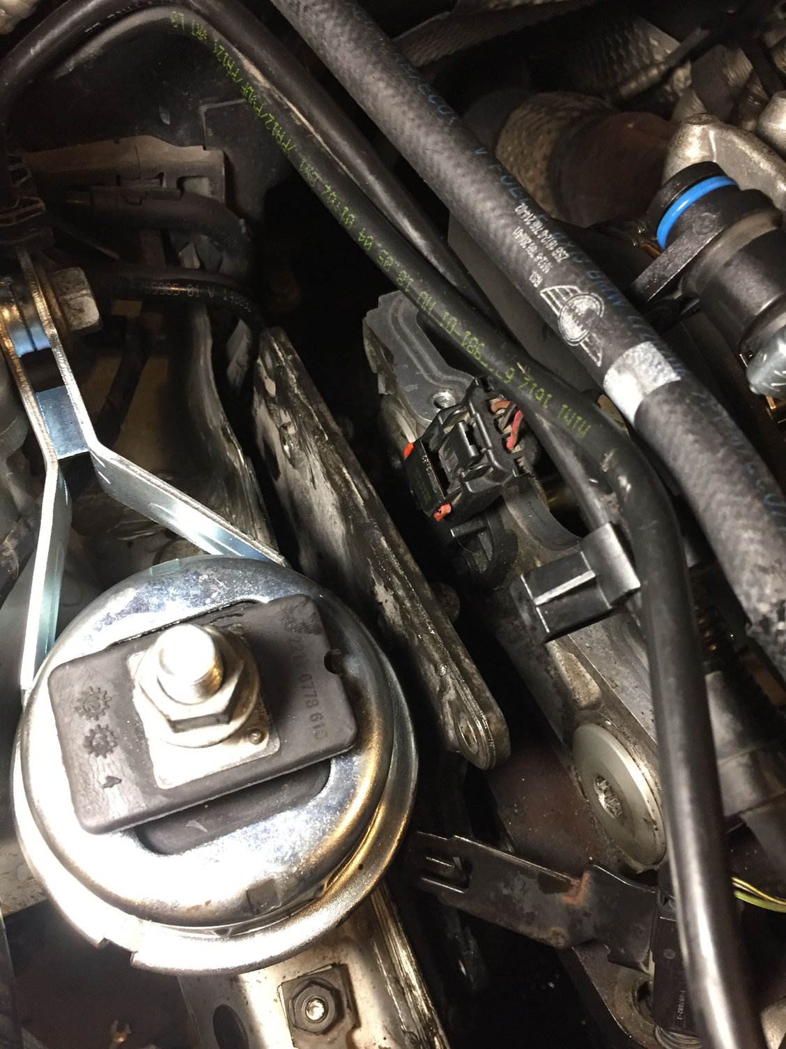

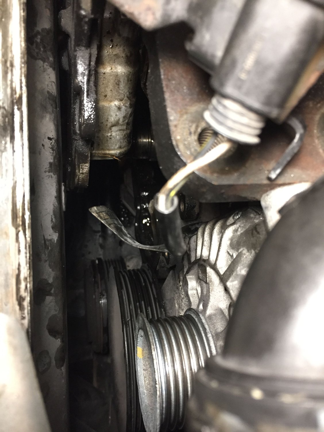

While you are there go ahead an replace the crankshaft sensor seal. They are known for leaking. As you can see in picture. I replaced my water pump. Along with my alternator,belt an tensioner. Plus all my cooling lines an thermostat . Since I was in service mode Plus I was at the 90k mark.
It's not hard. Just take your time an keep asking questions on here We will be happy to help. BTW how did the puller do?

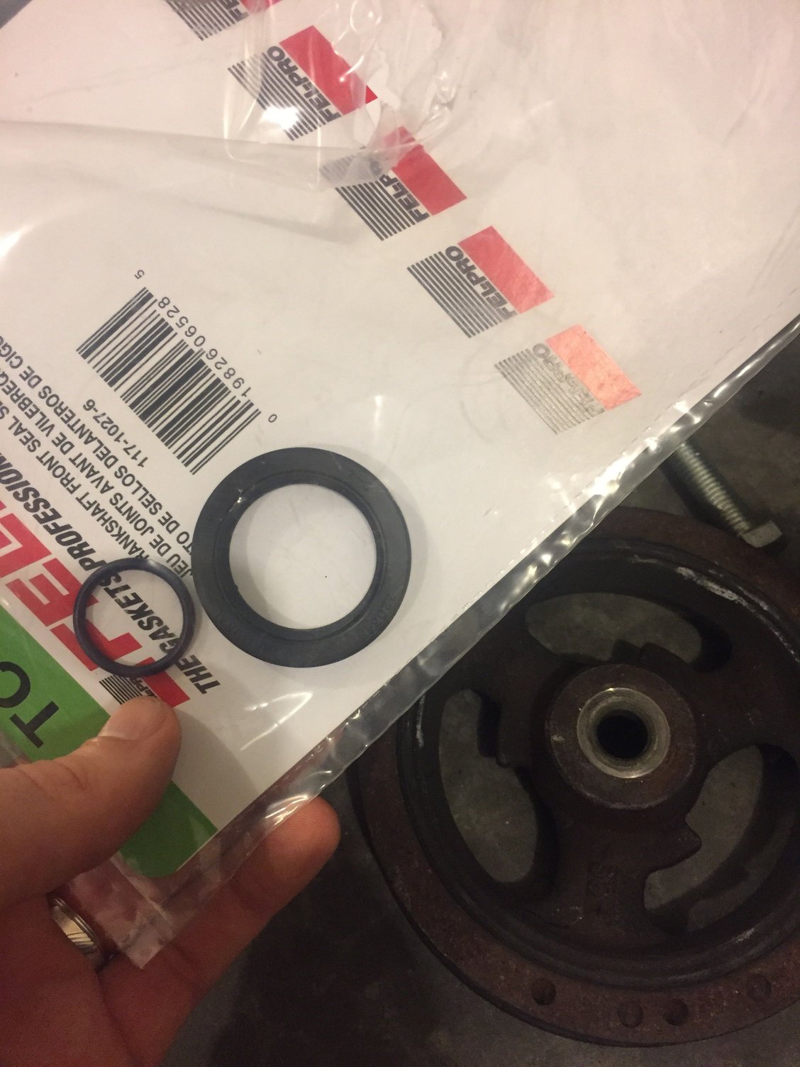

Nice even coating of synthetic anti seize
New seals Yeet!
Crank seal aaaaan idk what this smaller one is?
