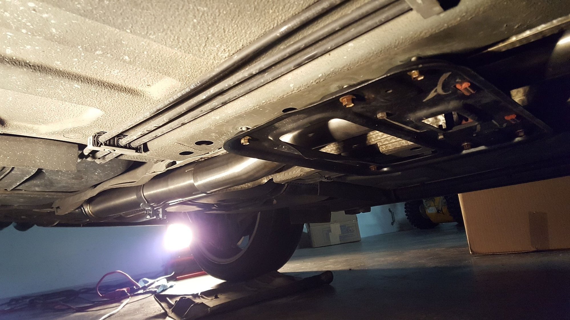

Here are some pictures of my JCW exhaust, 12 years old. Just inspected it and polished it up while doing a rear brake job. It still performs well and no issues. There are other exhaust out there for the Mini that are of the same quality, but less expensive. Additionally, there are many exhaust out there, some high priced, some low. The question is how long to you plan to own the car? I bought a high quality exhaust for most cars that I owned and it's well worth it if you plan to keep your ride. You can go inexpensive, but if you have to replace the cheap exhaust every 2-3 years, you might as well go all out in the beginning. Just my .02, good luck.

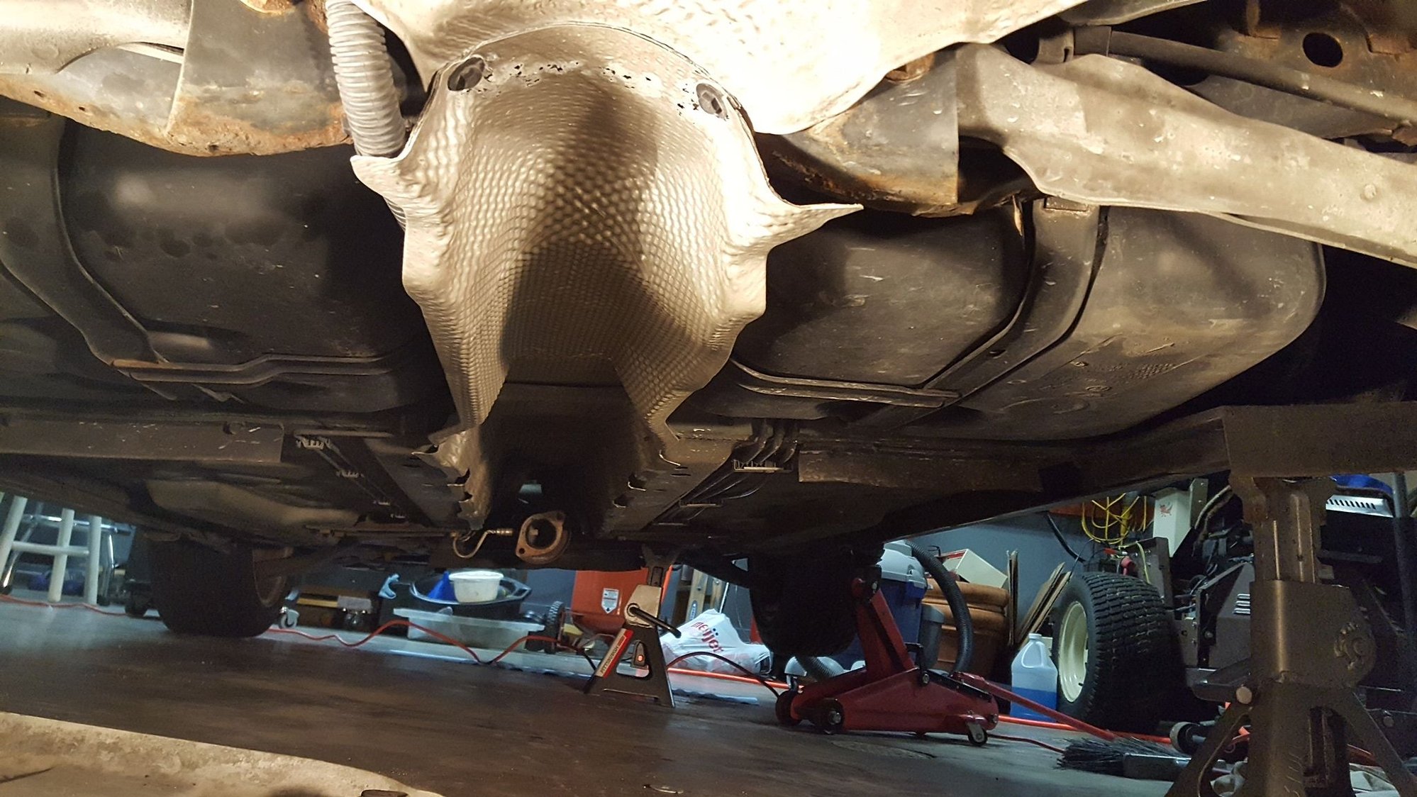

Holy cow that got here FAST!
And packaged very well.
Oh boy, I almost decided NOT to install it....It would look GREAT hanging on my man cave wall....
Cleared out the old exhaust and spacers that helped make it fit.......
When WMW said it would fit perfectly, they were spot on.....iit did. I mounted it completely and left all fasteners loose.
I tightened the bolts starting in the front working my way to the back and tben took a test drive.......

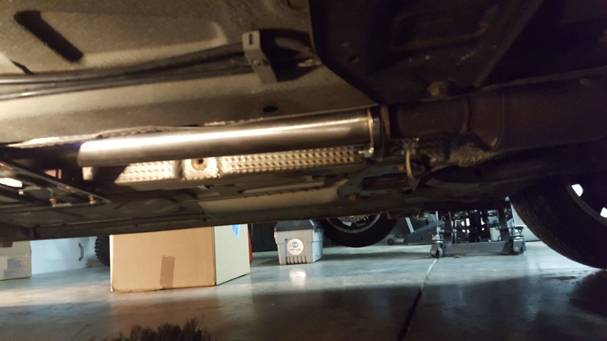

Sounds excellent..... unfortunately, I exposed another exhaust leak. Its somewhere in front of the new pipes..... Almost sounds like the header came loose. I'mwaiting for it to cool down and then I'm going to take a look.

Flex pipe give out maybe?

I think this mght be the problem.......can it be repaired?

Holy crap that's your catalytic converter, never seen that happen. As long as the internals aren't loose I'd carry it to a shop and have them weld it back up. Let a professionally do it so you know it won't leak.

So, a muffler shop should be able to fix it? I sure would like to save the bucks if I can.

Oh yeah, that's just a weld job, make sure to make some marks across the two pieces so it can be correctly lined up before welding if it accidently comes in two before you get it fixed.

Thanks. I'll be taking it in on Tuesday.

Found a place to have it welded today....not pretty but seems solid.....

Good deal, long as it doesn't leak it's not somewhere someone will see it.

Yep, seems like it's good to go. Thanks for the welding suggestion. I almost trashed it and bought another........
