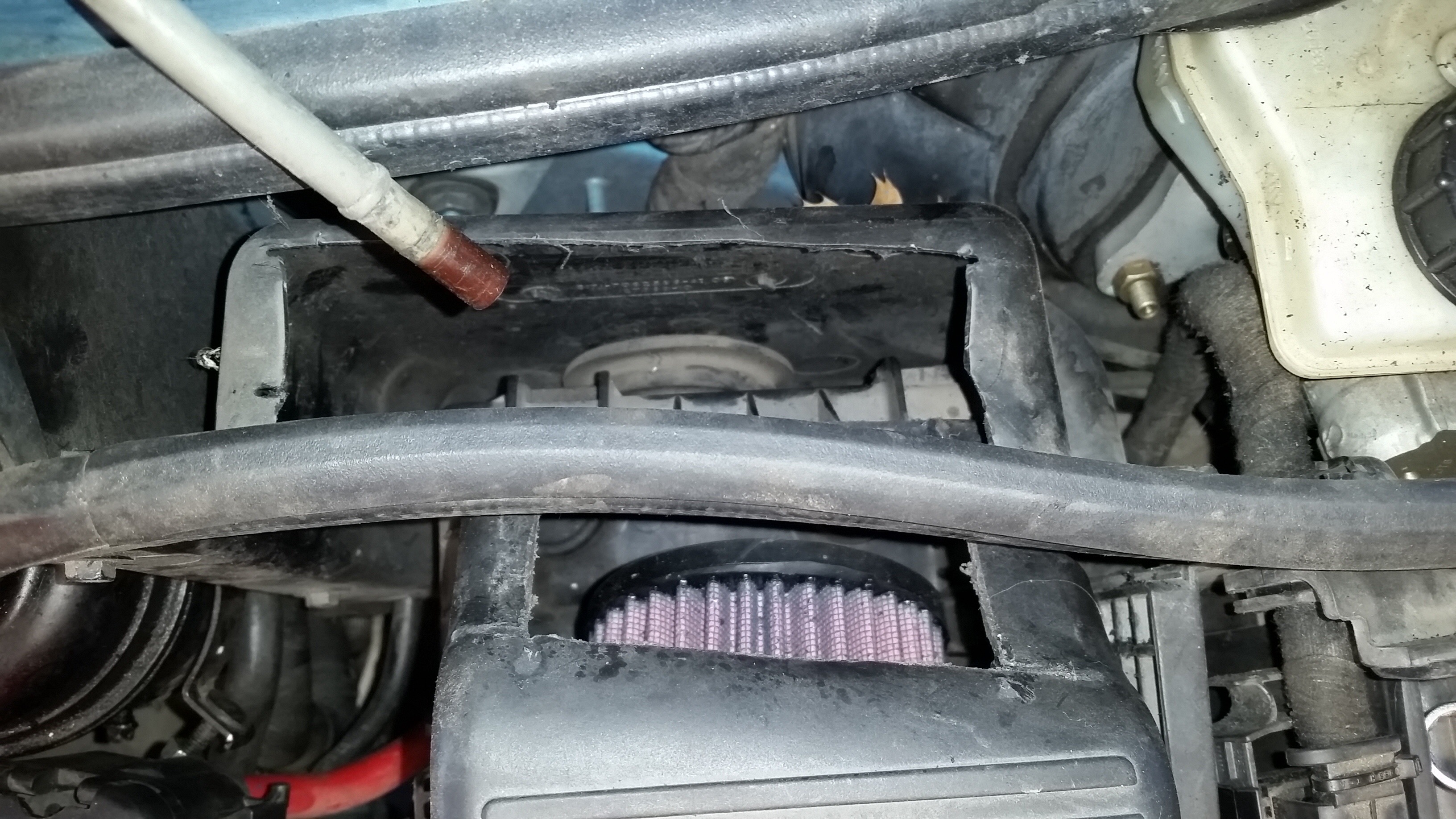

replace old cabin air filter - vacuum up rates nest of acorns that was inside ac housing.

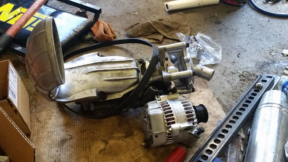

since its down - I might as well do the water pump.
hassle but got everything off- drained and refilled supercharger oil while I was in their. nose was a little light on oil.
Cool thing is that the supercharger is a 07 model so it has Teflon coated rotors. verified by looking at them. pretty cool.
The CPS is clean and dry with no oil leak. Not sure would be worthwhile to replace if its not leaking.
found my water leak - the o ring going from water pump to block was shot.
so that is a good thing. was about to put everything back together but didn't like the looks of the small 1 inch water house going from water pump to heater line. will get a replacement tomorrow. I had ordered a new radiator but got sent a r50 one instead of r53. so that one is going back tomorrow and I already ordered a r53 mini cooper s one.
waffling on the supercharger pulley. if I have everything apart I really should do it now.

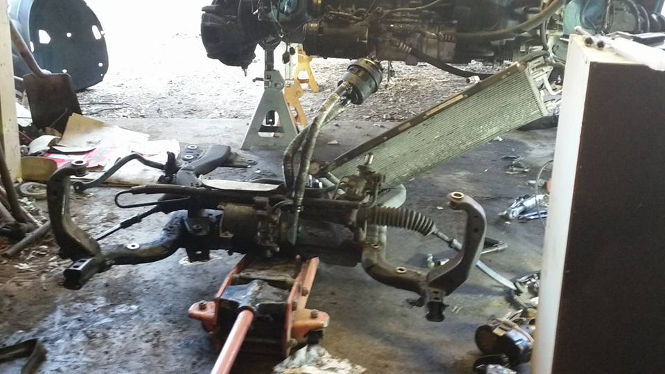

got that done and put aside and went after the sub frame and bushings.
dropped the sub frame fairly easily. Lots of banging with the pickle fork to get the ball joints off the control arms. The trailing bushings were a hassle as expected. Not that bad once I got the 2nd one once I remembered to put dishwashing soap on the bushing and get it positioned just right in the vise. Just had to be careful while cutting the inner rubber bushing off.
put everything back together with a little bit of jiggling. So suspension is done for moment.

Since it was raining decided to pull the hood insulation down and fix the squiters. Turned out that the drivers side connector was just off the nozzle. Pushed it back on. Filled it up with washer fluid and hey we have fluid on the windshield !
