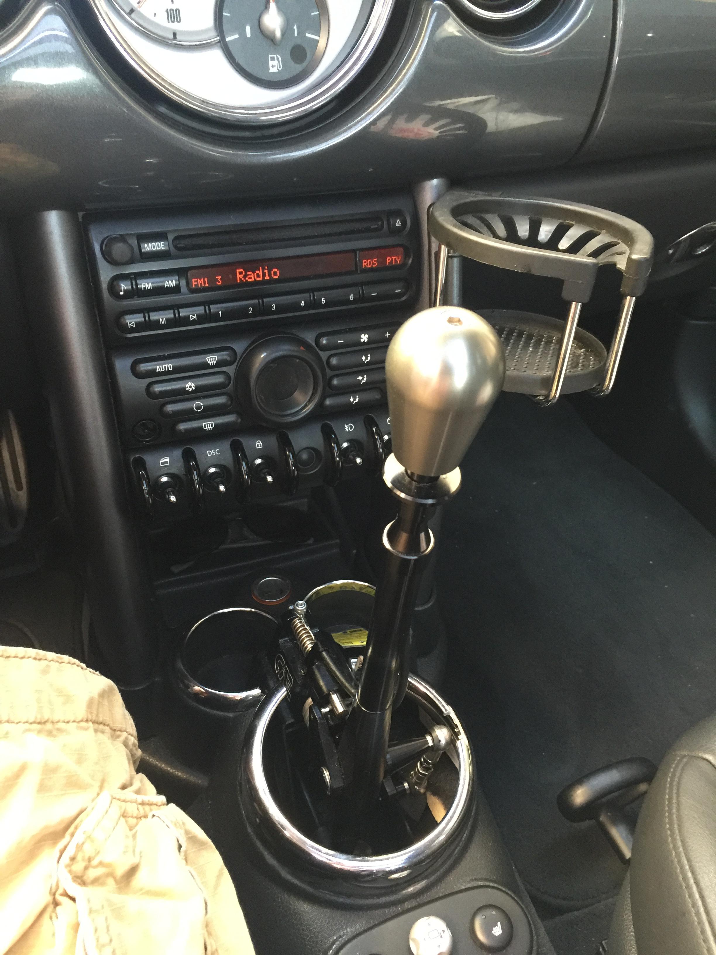

Pics of shifter please
It is amazing, I highly recommend this mod. I'm really considering getting this for my A4, though I need to figure out if it will bolt up to a RS4 transmission.

Shifter looks awesome. Is it like a sequential in that you just shift forwards and backwards or does it still shift normally?

The shifter is still a standard H pattern, its just extremely locked down. I'll take a quick video when I get a friend in the car.

That CAE shifter is awesome, quite pricey but i bet it's worth it.
