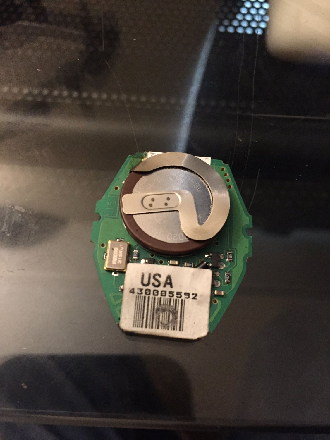

I recently bought a 2005 Mini Cooper S. The keyless entry hasn't worked since I bought it. Today I cut the key open, found the broken solder joint on the battery and repaired it. Now I can use a voltage tester and I have a soled 3v on the board. I don't see any other problem, all the other joints look good. I put the key back together and took it out to program the cooper. I tried every variation I could find online but none worked. I then took the key to O'Riley's and used their tester. It barely lit the LED on the tester, but another key worked fine. I did notice it flicker just a little when I pressed the buttons.
How reliable are the testers, and what else could the problem be. What would you say is my next step? As with many others on the forum, the nearest Mini dealer is over 100 miles away, and I'd rather avoid the stealership if possible.

Here are the pics of the keyfob. I've already glued it back together, but if you see something I'll gladly cut it apart again.

Broken solder joint on the battery...you mean the spot welds? Wouldn't want to take an iron to those...
3V should be at least half charged though which is good. Battery info here: http://industrial.panasonic.com/cdbs...AA4000C392.pdf.

my key less entry did not work when i got my mcs either i sourced a replacement battery on ebay don't remember the part # but it wasn't the problem.
come to find out that the po had used windex or some other spray cleaner on the rear view mirror and the cleaner got in to the antene circut board and corroded it. replaced the mirror as i couldn't find the board and that fixed the problem.
Sorry, it wasn't on the battery its self, it was where on of the prongs pushed through the board. I used a solder wick to remove the solder, then pushed the pin back though and re-soldered.

no dealer trip or reprogram of car just sync key up to system.
there are 2 boards in the mini rear view mirror top on is auto dimming mirror and the bottom one is the keyless board.
